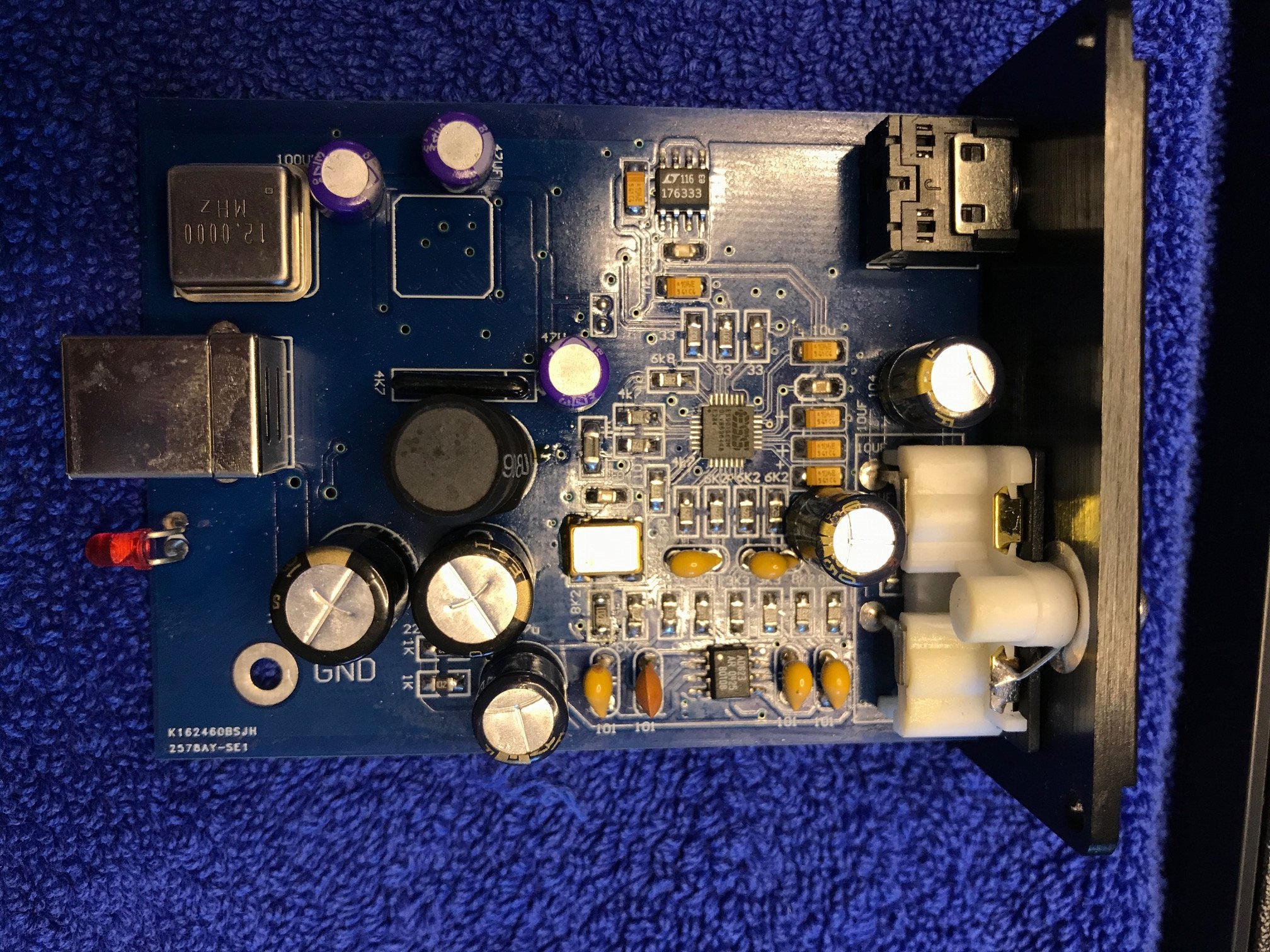

I have started DIY project of extension my old USB sound card DAC with optical audio input (TOSLINK). The usb DAC is based on SA9023 which is connected to ES0918K2M over I2S interface. Idea is to extend the board with Toslink reciever and connect it to ES9018K2M SPDIF input.
First step was to add Toslink receiver and connect its output to ES9018K2M GPIO2 as SPDIF input, after that plan was to use ES9018K2M GPIO1 as I2S\SPDIF input selector switch. To make that work ES9018K2M registers needs to be configured properly over I2C interface. I used raspberry Pi 3 Model B+ to establish I2C communication with ES9018K2M but was not able to detect the chip address 0x48:

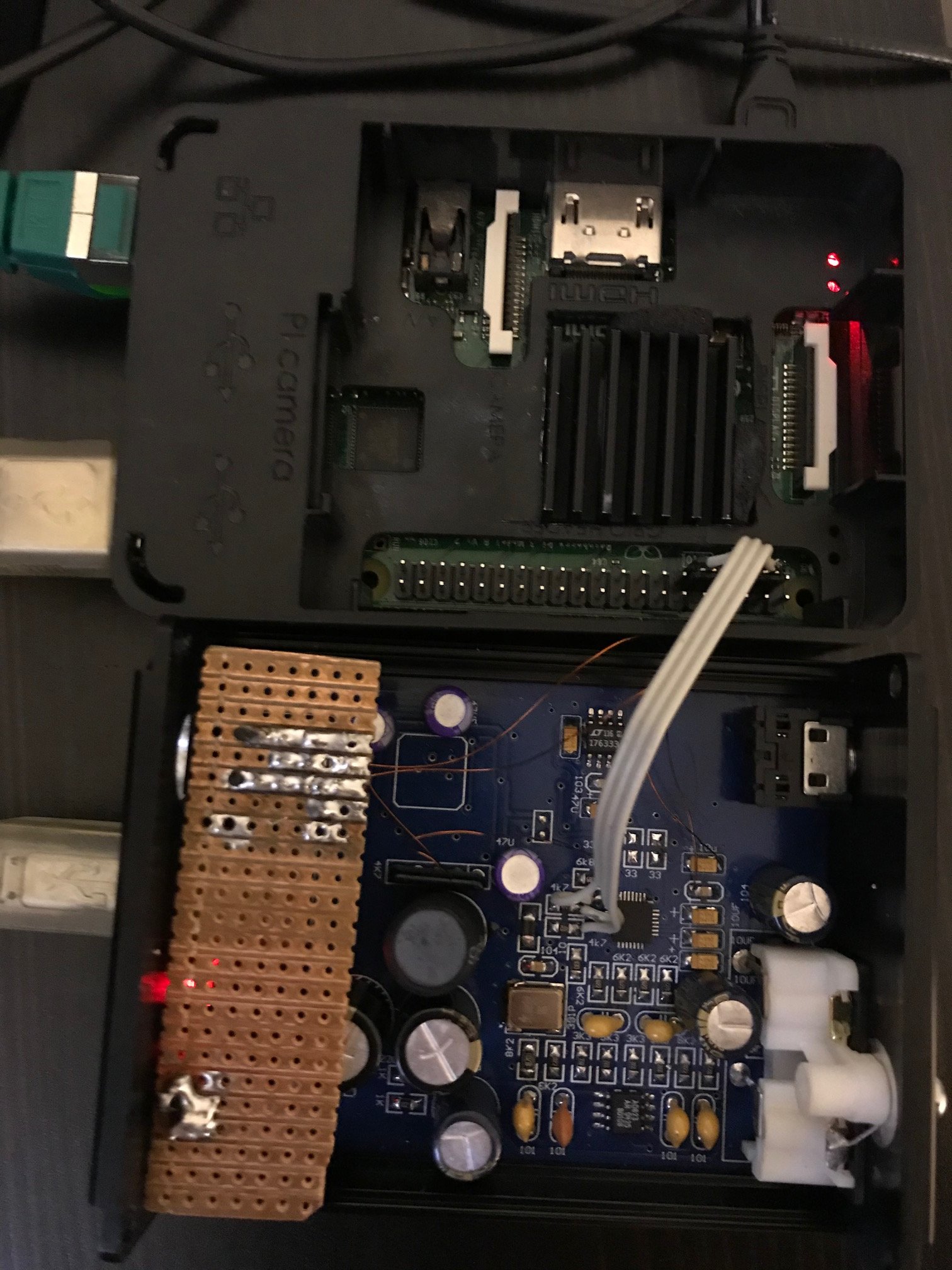

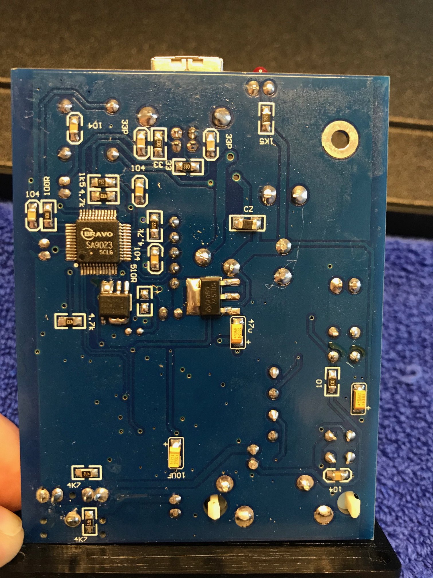

As it can be seen form picture above, SDA and SCL lines are pulled up by 4k7 resistors, cable to RPi3 is short and connected to corresponding GPIOs. I2C is enabled in rpi3 config and baud rate set to 100kHz. USB DAC board is powered from rpi3 via USB cable and works properly. Later, I removed 33 ohm resistors from I2S lines to disconnect SA9023 from ES9018K2M and exclude possible interference, but that didn't fix I2C communication problem.

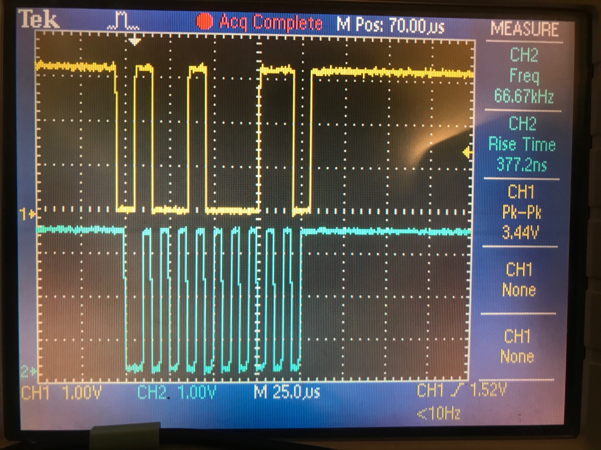

My next step was to connect oscilloscope and check I2C signals when sending command:
pi@raspberrypi:~ $ i2cget -y 1 0x48
Error: Read failed
Form picture above it is evident that for some, to me unknown reason, ES9018K2M doesn't put ACK signal to low.

I am still open for any suggestion that will help to estabilish i2c communication with raspberry pi. I have checked signal timings and they seams to be according to i2c specification 2.1.
If it were me, I would check the ADDR pin voltage at the dac chip, and also check SDA and SCL activity right at the dac chip pins with a scope. In other words, I want to be sure that all the inputs to ES9018k2m are correct right at the dac chip. That also includes power supply voltage and clocks. If all inputs are correct and the chip does not work as specified, then what other conclusion can there be other than that the chip is defective?
