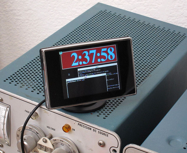

4x20 displays also are getting closer and closer to small touch screens or even the mini composite vga displays (backup camera displays for cars). a rasp pi and one of those would make a SUPER user interface. and then a back-end arduino can do most of the very low level work that you may not want to do at the linux side.
