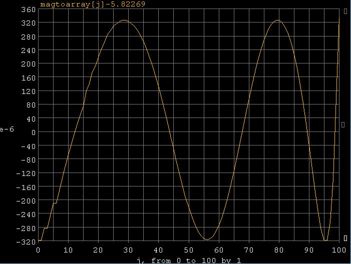

Here is my comparison between the exact continuous RIAA, riaa(f) = (sqrt(1+f*f*4*pi*pi*318us*318us))/((sqrt(1+f*f*4*pi*pi*3180us*3180us))*(sqrt(1+f*f*4*pi*pi*75us*75us))) and the IIR (fs = 192k) version at 100 ~1/10th octave points chosen to be nearest exact 65536 length FFT frequencies (so you use no windowing).
I also checked SoX with Baudline under Linux with the same answer. Baudline has an unwindowed FFT option which Audition does not (you can also zoom in on Baudline to see the result note the scale - micro-dB). The jaggies a low frequencies are because there is not enough frequency resolution at 65K points to do 1/10th octaves at less than 40Hz or so. There are no discontinuities in the result.
