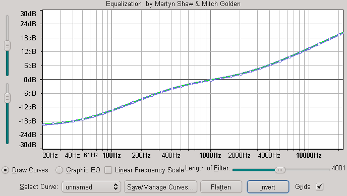

Just found that Audacity can do inverse RIAA (Effect / Equalisation choose RIAA and select "invert"). But no idea how precise this implementation is.
I wasn't able to get the inverse curve in Audacity, but here is the normal RIAA curve it uses, as far as I can determine.

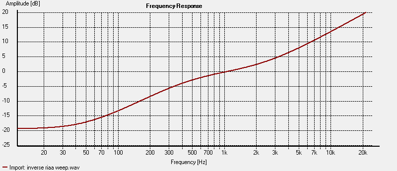

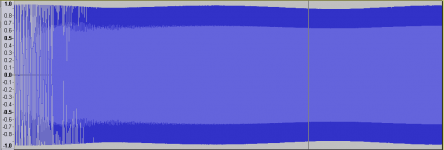

GK7: I used the newest version of Audacity and found the invert function. Thanks!
Here is 10 sec sine sweep that has the inverse RIAA curve applied. It looks pretty good, what do you think? I can post the file here, if anyone wants it.

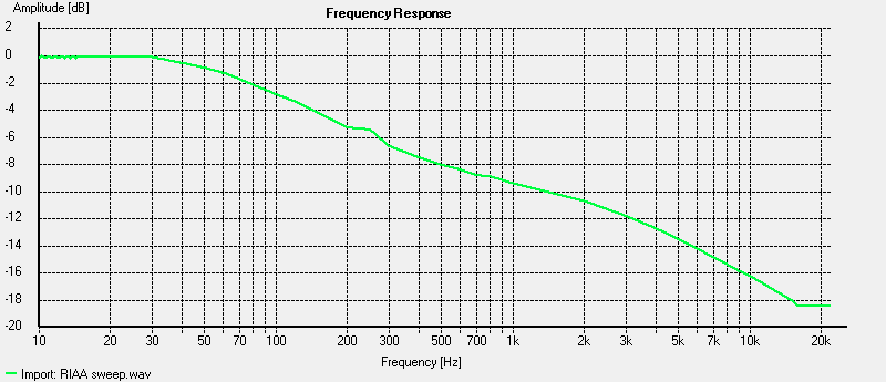

It looks good, but obviously audacity and sox do not exactly agree. I just tried to convert the audacity generated (RIAA preemphasis) sweep to a file with flat response again (using sox). But it´s not entirely flat :-( . Audacities RIAA seems not to be exact enough for measurement purposes, if we assume that the sox implementation is correct.

Seems the best one can get with Audacity is approx. +/- 1 dB compared to sox. I think the real limitation is that Audacity fits this curve along a finite number of static frequency points (not a really elegant solution) which might be usable for the intended purpose, but certainly not for measurement purposes.
