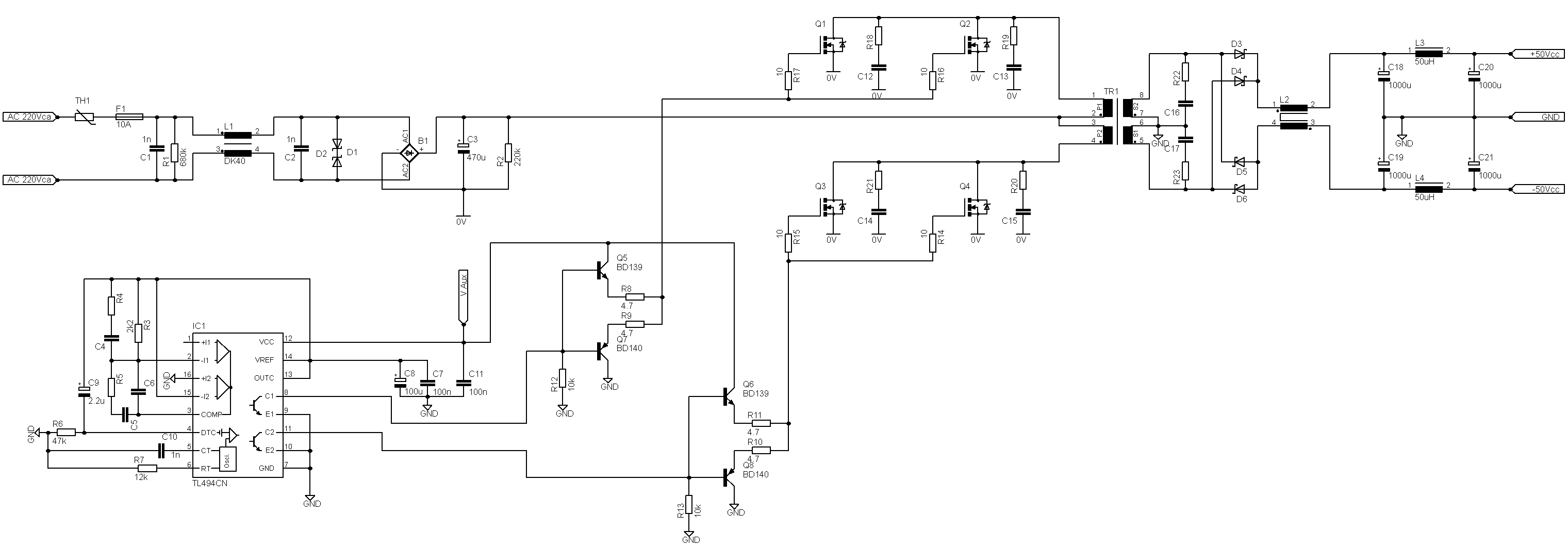

Now as i sayd in the first post my goal is to design and built from scratch a good-reasonable PSU, that ATX is about done, just needs some finishing touches, so the main reason i have come with this subject here is because i intend to desighn and built a new one, i need at it's outputs +/-50Vcc regulated, and the current limmit will be set at about 10A at witch point the PSU will block and need reset, last night i started the schematic and chosen an Push-Pull topology to avoid the need for driver transformer, the power switches will be mosfet ( i have not decided exactly witch one to use, maybe IRFPC60 ), i haven't had the time to choose the power transformer yet, nor did i calculated stuff like snubbers, compensation and such, they will be calculated at the wright time, for the moment i've just put some bits and pieces together and i will show you all what, and await your imput, i will power the IC and bias circuit from an auxiliary PSU, be it a simple flyback or just a small transformer that remains to be seen later, this way i will not need opto ( and all it entails ) on the feedback network. I know it is sort of a mess there but i will estetize it more along the way.

So, estimating an efficiency of 80% means that the power switches will have to handle about 1,25KW of power, and as the voltage on the wall socket sometimes goes down to about 190V that means the power mosfets will have to handle about 9-10A, is it not a bit too much? i think maybe at least 3 pairs each of mosfets to be on the safe side, am i wright?
