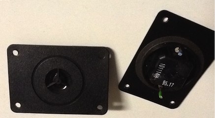

Equivalent or replacement for TDL NFM1 tweeter?
The attached picture is of tweeters from a (2-way) TDL Near Field Monitor I ("NFM1").
I need to replace a blown tweeter. Does anyone recognise these tweeters as an OEM under another name?
Size = 90 x 62 mm.
They are crossed at 5kHz, according to specs.

Yes. It's the Audax Balanced Drive mylar cone tweeter. Or a clone.
I don't know if the exact 6X9 rectangular mounting is still around, but you can still get similar:
https://www.madisoundspeakerstore.com/audax-soft-dome-tweeters/audax-tw010f1-10-mm-polymer-dome-tweeter/
DTW 72 - 8 Ohm
SC 5 - 8 Ohm
Quite a nice sounding tweeter. Mylar types tend to be bright at the top end.
Wonderful.
The two Visaton tweeters are readily available here, as is the Audax. None are expensive.
& as it's just surface mounted, I don't really mind the shape of the mounting.
