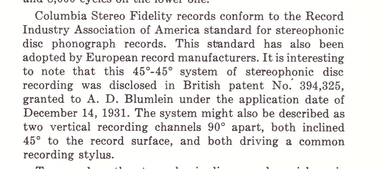

Columbia stated explicitly in the booklet accompanying their LP introducing stereo sound that all Columbia stereo LPs conformed to the RIAA standard.
It's not a matter of taste.

I've already read the Stereophile review which is why I looked up this thread. I'm not arguing about the quality of the preamp only about the misinformation on the equalization of post 1955 Blue Note and Columbia (USA) LPs. Both these labels used RIAA equalization after 1955. Mr Ohashi is wrong.

I told you many time that what you are saying about the equalization of post 1955 Columbia and Blue Note LPs is wrong and you have provided no evidence to disprove my assetion. I don't care who Mr Ohashi is : he is using incorrect equalization as a tone control.

In post no. 38 Mr Ohashi (via Mr Kung) says that the proper curve for the Miles Davis "Someday my prince will come" and "Kind of blue" LPs is Columbia/Old NAB and for the 2 Blue Notes is AES. This is untrue as both labels had changed to cutting with RIAA iin 1955. It is not stated as a matter of taste, but as a matter of fact. That is why I call it untruthful and inaccurate.
