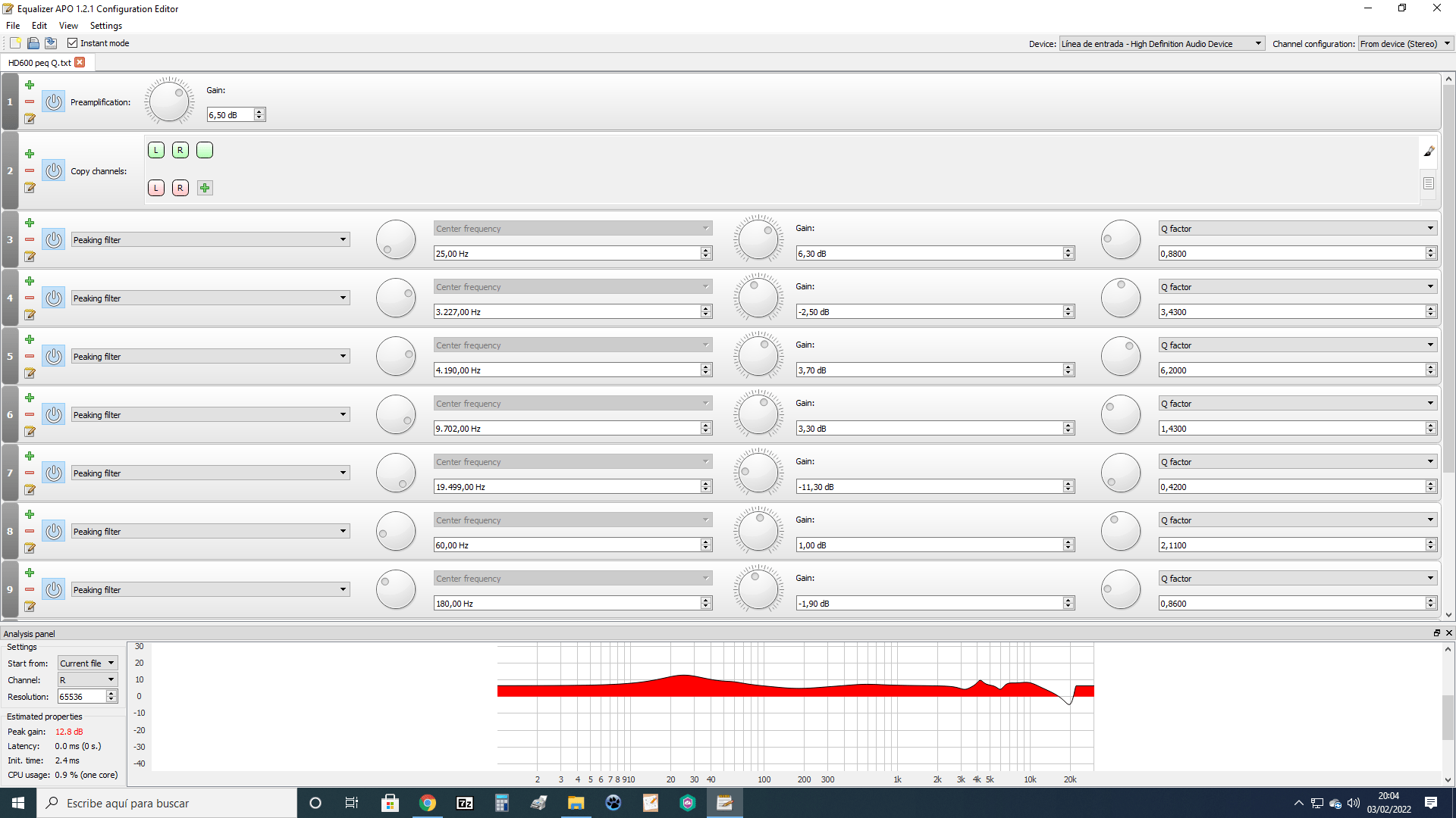

I downloaded EQ APO & like it, if you know a way to capture & save the files please let me know?

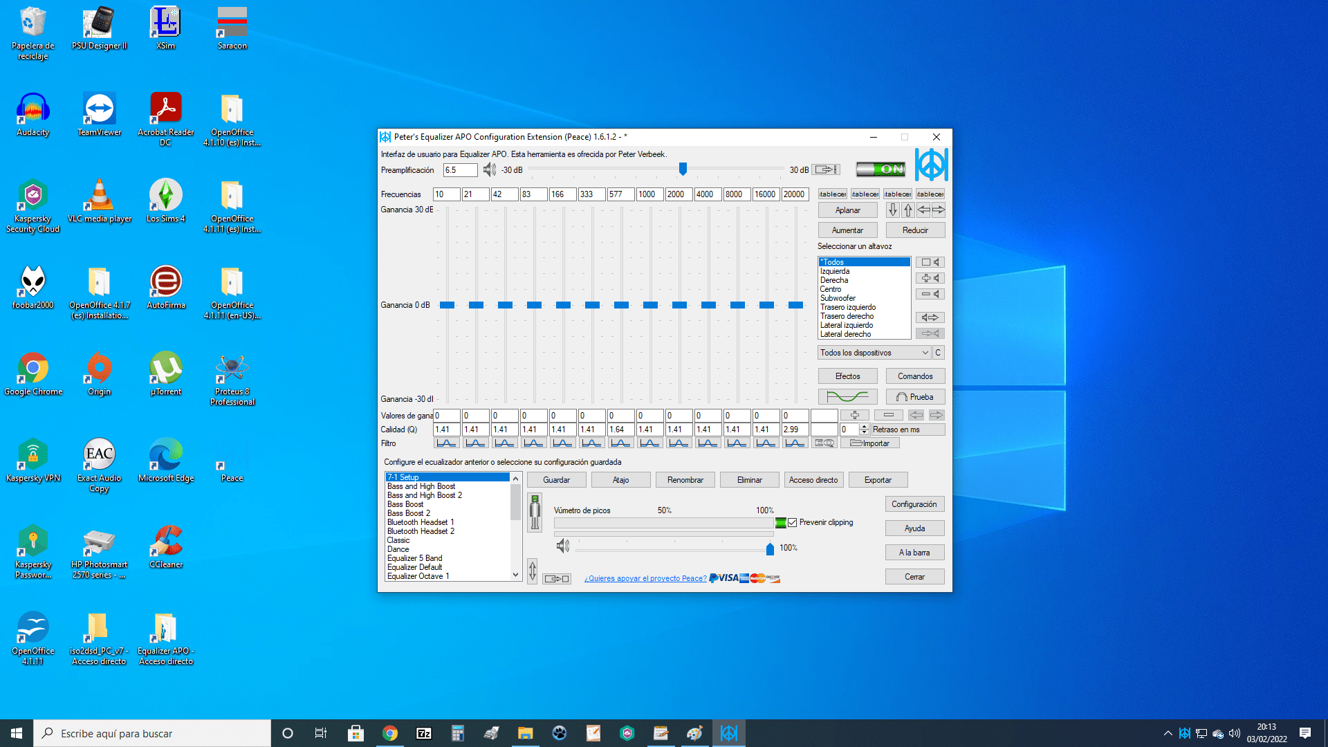

Filters done, I need to know how add files and how to EQ & save?
It's not really made for that: it's for realtime DSP, i.e. while you're listening to your music.
Doing the processing and save with this would require additional steps and configurations (e.g. with JACK).
I'd say keep this for listening to audio files which have not been pre-processed because if that works, you don't really need to pre-EQ them, right?
For the EQ + Save, then use Audacity if you really want to do that. Here, I'd say, there's no need because you can use EQ APO + Peace to apply the EQ realtime => you save time, as the preprocessing of audio is then unnecessary. Imagine having to re-process all your files with different headphones every time you get a new one - not practical.
