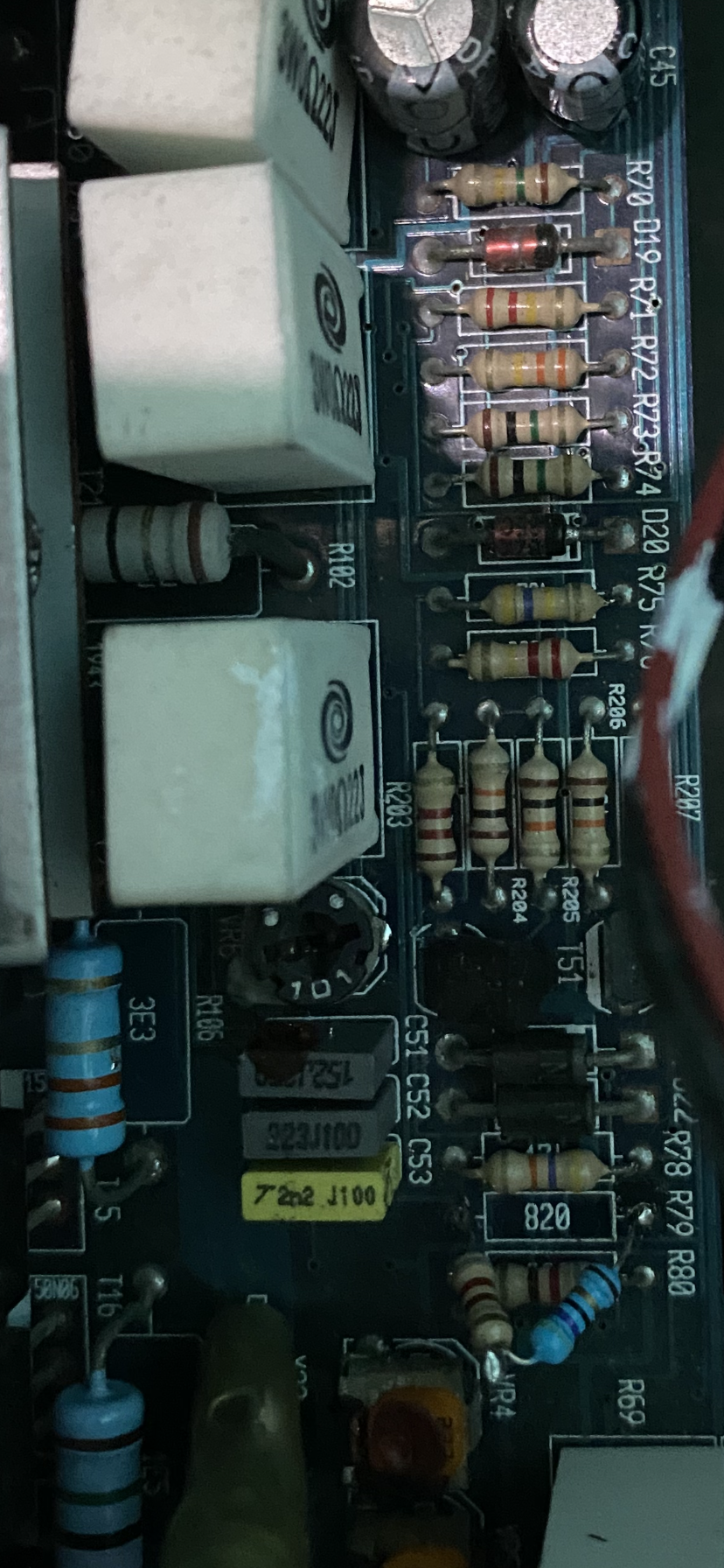

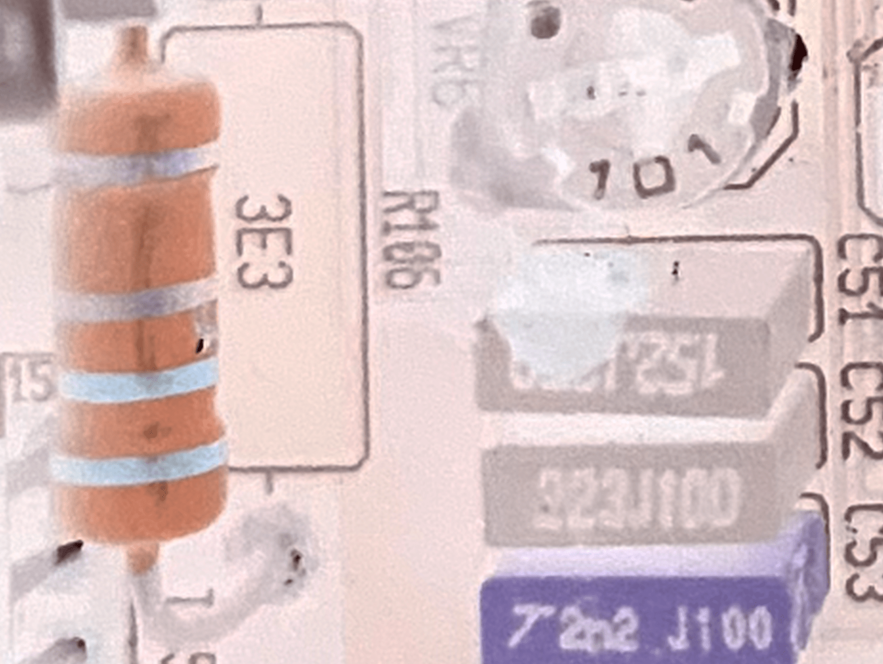

If you're observing 101mV across R106, but only 10mV across R108, R106 is likely high resistance or open. Try measuring voltage drops directly on leads next to the body of the part to rule out open solder joints.
I don't understand what you're showing in post #10 pic. Looks like two series resistors?
They are more or less in parallel with VR3 and VR6. The schematic symbol is a resistor with a straight diagonal line through it. RTD = Resistance Thermometer Detector

Now that I study the pic again, I see partial views of R106 and R108. I can even imagine that the lower solder joint of R106 looks suspect.
Needless to say, I'm very suspicious of R106 or its soldering.
P.S. You note high bias reading, but are the associated heatsinks hot? What's voltage across R102?

AT idle the problem channel heatsinks heats up faster than the other one.
I will get voltage for R102 tomorrow.
If there is oscillation enough to throw off the bias, usually the zobel resistor at least gets warm to the touch. If there is no scope on hand it can still be detected. Schottky diode and DC volt meter can also be used (DMM will probably read zilch on AC).
