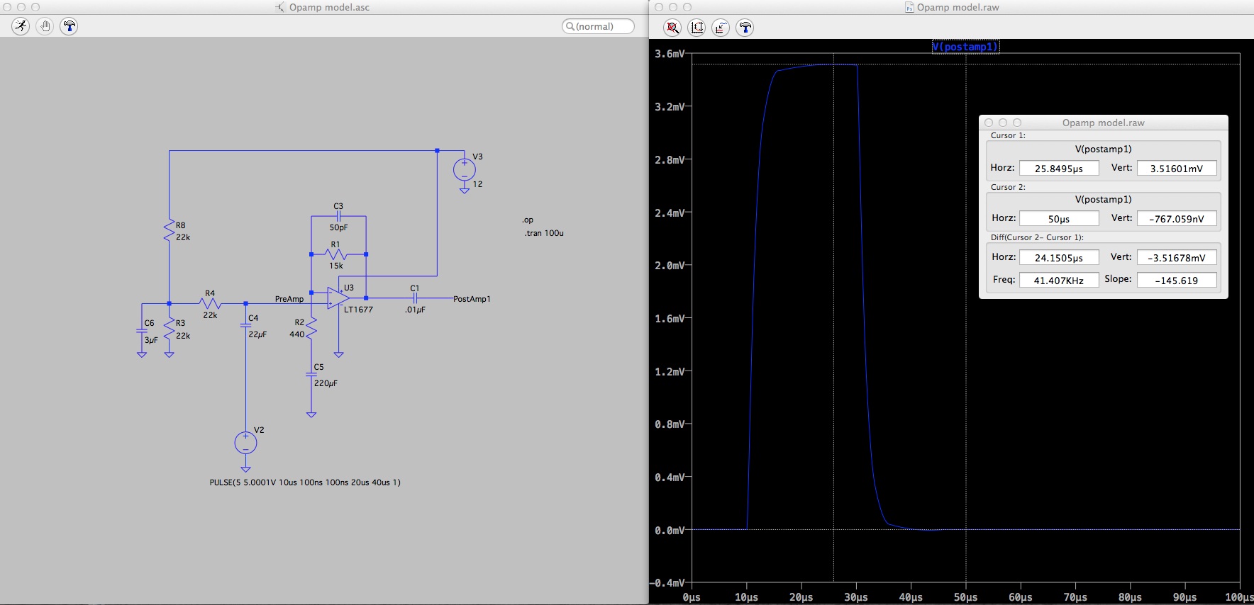

I'm at a loss. AN-581 deals with this exact topic. I don't see where I went wrong. For now just focusing on the first gain section:
- I have a non-inverting amplifier
- I have a single supply of 12V
- "the fundamental problem is the op amp is a dual supply device and so some type of biasing, using external components, must be used to centre the op amp's output at mid supply"
- simple solution is a voltage divider (R8 and R3) and C5 is needed for stability CHECK
- problems: loss of PSRR and instability
- solution: decouple the biasing network from the supply. Add C6 for AC decoupling, R4 for dc return path CHECK
- follow guidance for size of R8, R3, R4, C5 etc
A problem for the LT1677 in the circuit above is the sizes of R1 and R2. Drop them to 15K and 440 and things look better. If R8=R3=R4, then - following the last note to Fig 3 in the AN - they can fall to 22k. Increasing C5 helps further. I can see why AN-581 says optimising everything "can become quite involved."

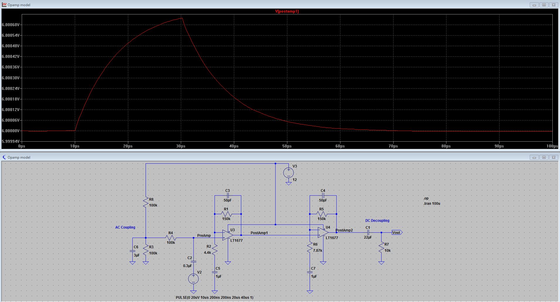

Attached below is a revised circuit, just focusing on the first amplification stage for now. (I've not looked at it in the frequency domain yet.) Maybe there's an easier way. If so, I don't see it.
The input impedance is 22k + {27k+27k}/2 = 35k5
That is quite low
The input cap @ 22uF is a bit low for a measuring instrument.
The decoupling @ 3uF is very low for a measuring instrument.
How much current is required to match the input offset current of the 1677?
Use that as a guide to the values for r3, r4 & r8

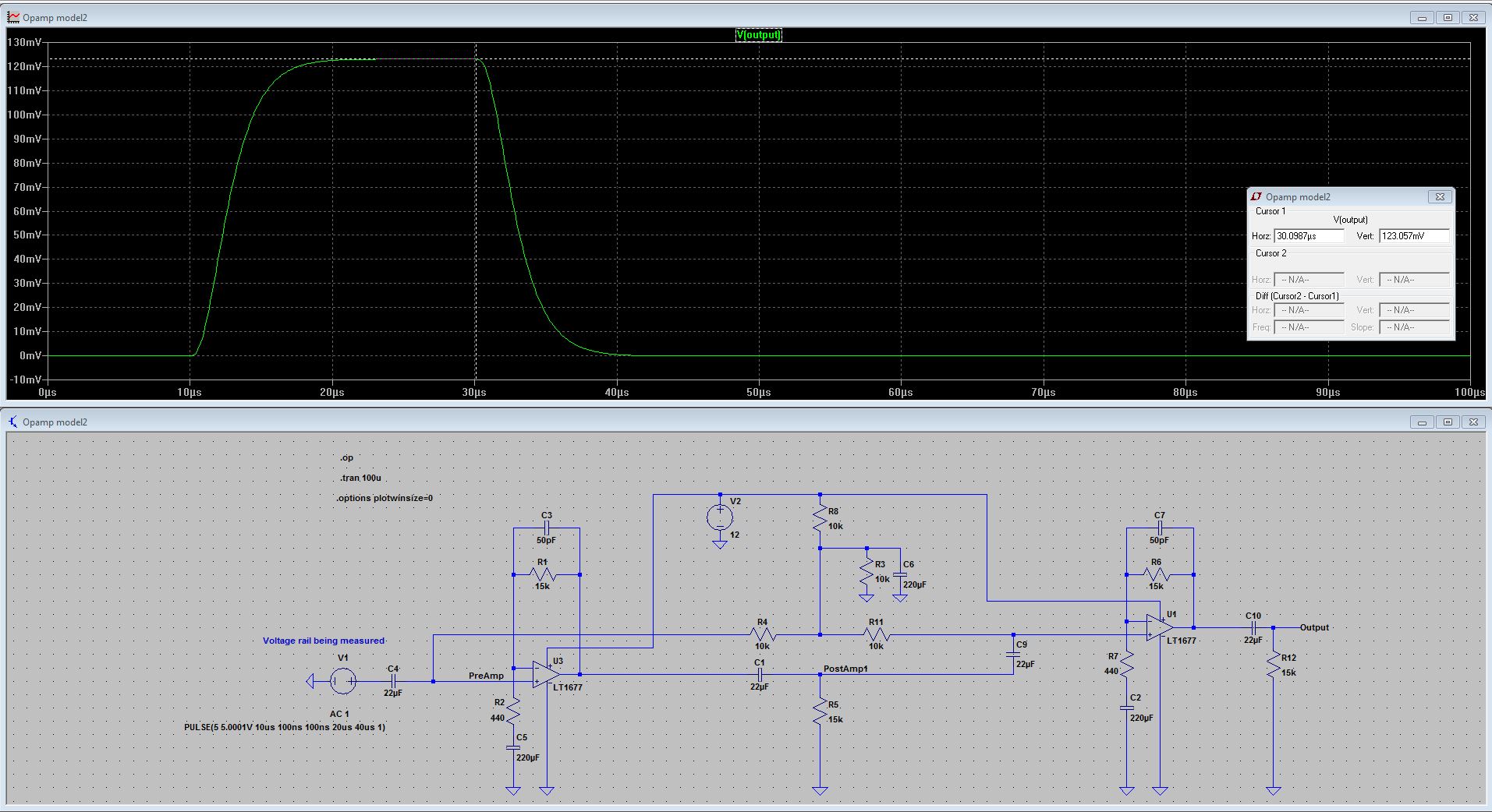

Overall, the circuit as currently configured has modelled gan of 61.8dB with -3dB points of 3.7Hz and 75kHz. The attached shows the circuit and transient waveform.
What is R5 doing?
Similarly what is R12 doing?
C3 and C7 seem very high, does the datasheet give guidance? Is this the 75kHz limit?
That seems far too low for measuring noise performance. Wider with a defined passband when that is required should be OK and maybe better.
Both opamps see ~15k on their two input pins. This should reduce input offset. Does the datasheet guide you on this requirement? Is it needed?
If you don't need 60dB of gain, then reducing the second stage gain would reduce noise.
R5/R12 - indeed seem redundant (I was thinking low pass filter but clearly all that's need is a short for DC)
C3 and C7 - guidance from datasheet is for R1 (R6) "greater than 2k, a pole will be created with [R1] and the amplifier's input capacitance, creating additional phase shift and reducing the phase margin. A small capacitor (20pF to 50pF) in parallel with [R1] will eliminate this problem." Will drop to 20pF - this helped (some is needed though).
I don't follow you here. Very new to op amps...
Will reduce it to 20x second stage.
Thx

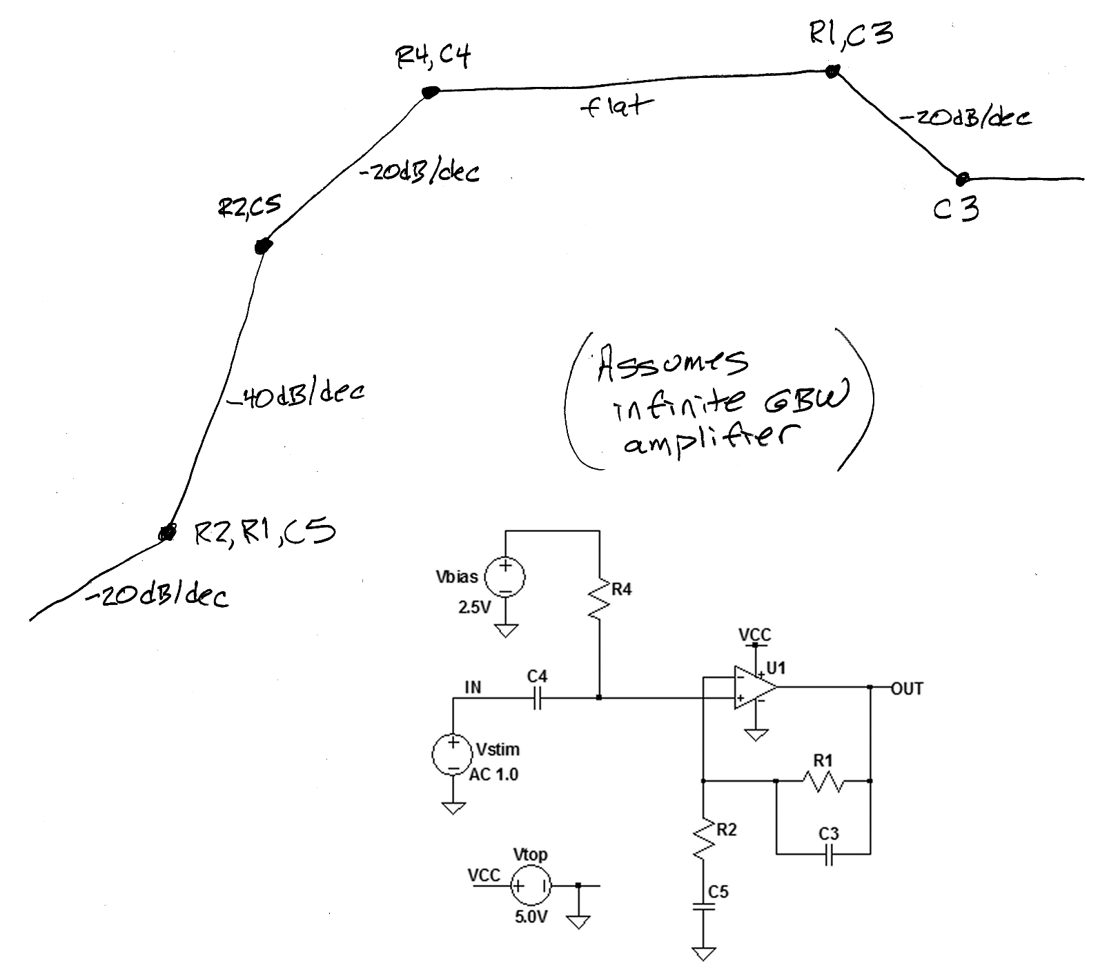

I think if you make a rough, piecewise linear, sketch of the frequency response (a "Bode Plot") of that circuit, you'll probably get something like the attached. The three capacitors give rise to three poles and two zeroes (!), and that neglects the opamp's dominant pole. Ugh.
Maybe the circuit would be easier to analyze if C3 and C5 (figure below) were eliminated. Then the frequency response becomes drastically simpler: a single pole (due to C4). And then of course the opamp's dominant pole, which I cheerfully neglected when drawing this Bode Plot.
Speaking of the opamp's dominant pole, Walt Jung selected a GBW=63 MHz opamp (OP37) to build a gain=50 first stage. If you're going to use a GBW=7.2 MHz opamp (LT1677) to build a first stage, what sort of gain do you think is appropriate?
A final lagniappe to chew on: what is the output impedance of the circuit that drives this amplifier's input? What ratio of (Zin_amplifier / Zout_source) do you think is appropriate?

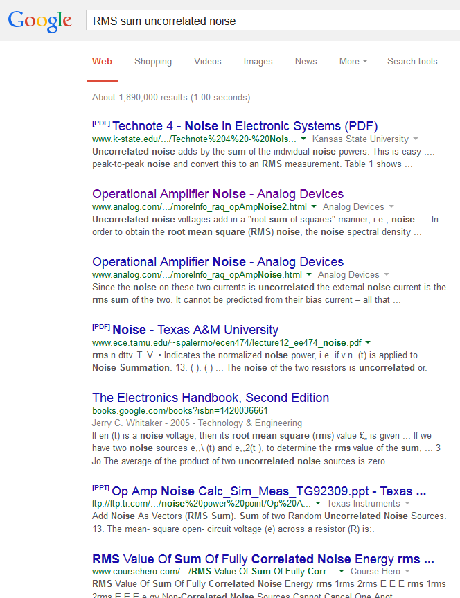

... the very first stage should have extremely low noise and operate at high gain. That way, the noise of subsequent amplifying stages will be negligibly small -- it's effectively attenuated by the gain of the first stage. There is another benefit: RMS addition of uncorrelated noise sources diminishes the second stage's contribution even further.
The references below, particularly the blue-has-changed-to-purple one, flesh out the computations for this. Study the paragraph that includes
" noise voltages V1, V2 & V3 add to give a result of
. ... Thus, if noise voltage V1 is more than 3 to 5 times V2 or V3, it is dominant, and V2 & V3 may generally be ignored, which simplifies noise assessment."
So a cascade of four amplifiers, each of whose gain is 5.63X **, has negligible noise contribution from stages 2-4. Similarly a cascade of three amplifiers, each of whose gain is 10.0X **, has negligible noise contribution from stages 2-3. You are free to trade gain for bandwidth and vice versa, as long as (1st stage gain x first stage ein) is > 5x (second stage ein). In the case where the first stage and second stage are built with identical opamps, ein1=ein2, making the math even simpler.
As for input impedance: Carefully note that noise-on-supply is produced by a circuit whose output impedance is the supply impedance ... i.e., far far less than 1 ohm. For the level of measurement precision you seek here, any amplifier input impedance greater than about 50 ohms will be more than adequate.
**_ Substitute the actual total gain requirement, instead of the phony-baloney placeholder "1000X" used here!

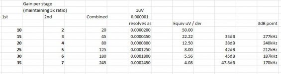

Okey dokey. I see the attached trade-offs between gain/resolution and bandwidth. My scope goes down to a vertical resolution of 1mV per division and I have calculated the uV/div for each gain pair also. I still don't have a feel for what constitutes adequate bandwidth.

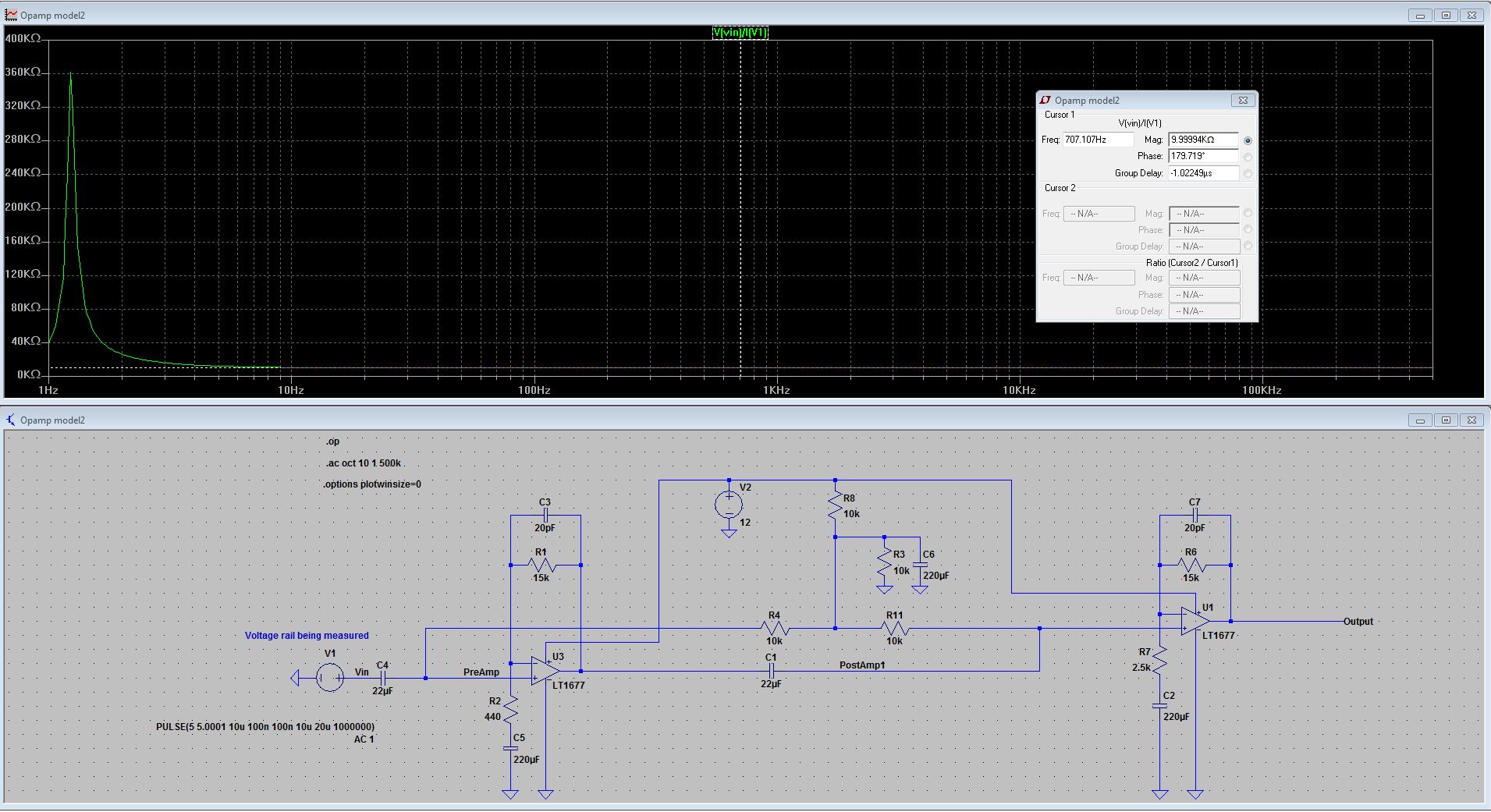

The input impedance of your amplifier circuit can be extracted from simulation results, just as the output impedance of your power supply can be extracted. You simply apply an AC input current of 1.0 units, and measure the resulting AC voltage at the input. Ohms Law tells you that Vin = Iin x Zin, thus Zin = (Vin / Iin). You will find that when you ask LTSPICE to plot the ratio (V/I), it automatically displays the data using the units "Ohms". LTSPICE is aware of Ohm's Law. You will see that the input impedance varies with frequency, which should not be a surprise.
At extremely low frequencies, all capacitors are effectively open-circuits (ignoring DC leakage). At extremely high frequencies, all capacitors are effectively short-circuits (ignoring ESR). In between, capacitors smoothly vary between behaving as open-circuits and behaving as short-circuits. Thus circuit response varies with frequency. As your intuition predicts.
The Zin-versus-frequency plot will probably include a broad zone of frequencies where Zin is more or less constant. The magnitude of impedance in the center of this zone (called "the mid-band") is the number that people usually mean when they say "the input impedance is AAAA ohms".
This I did earlier. It matched my expectation from just looking at the circuit schematic but I wanted to check this wasn't merely coincidental.
Unless I am missing something, the input impedance of the measurement amplifier (10k ohms) dwarfs the output impedance of each of the power supply rails (less than a few 10s of milliohms) by a massive margin. Job done - not a significant factor in measurement accuracy.
So I am just left with a bandwidth / amplification choice...
PS: gut instinct suggests 170kHz upper limit is more than enough but this conclusion is only drawn from observing charts on-line that tend to stop at 100kHz.
