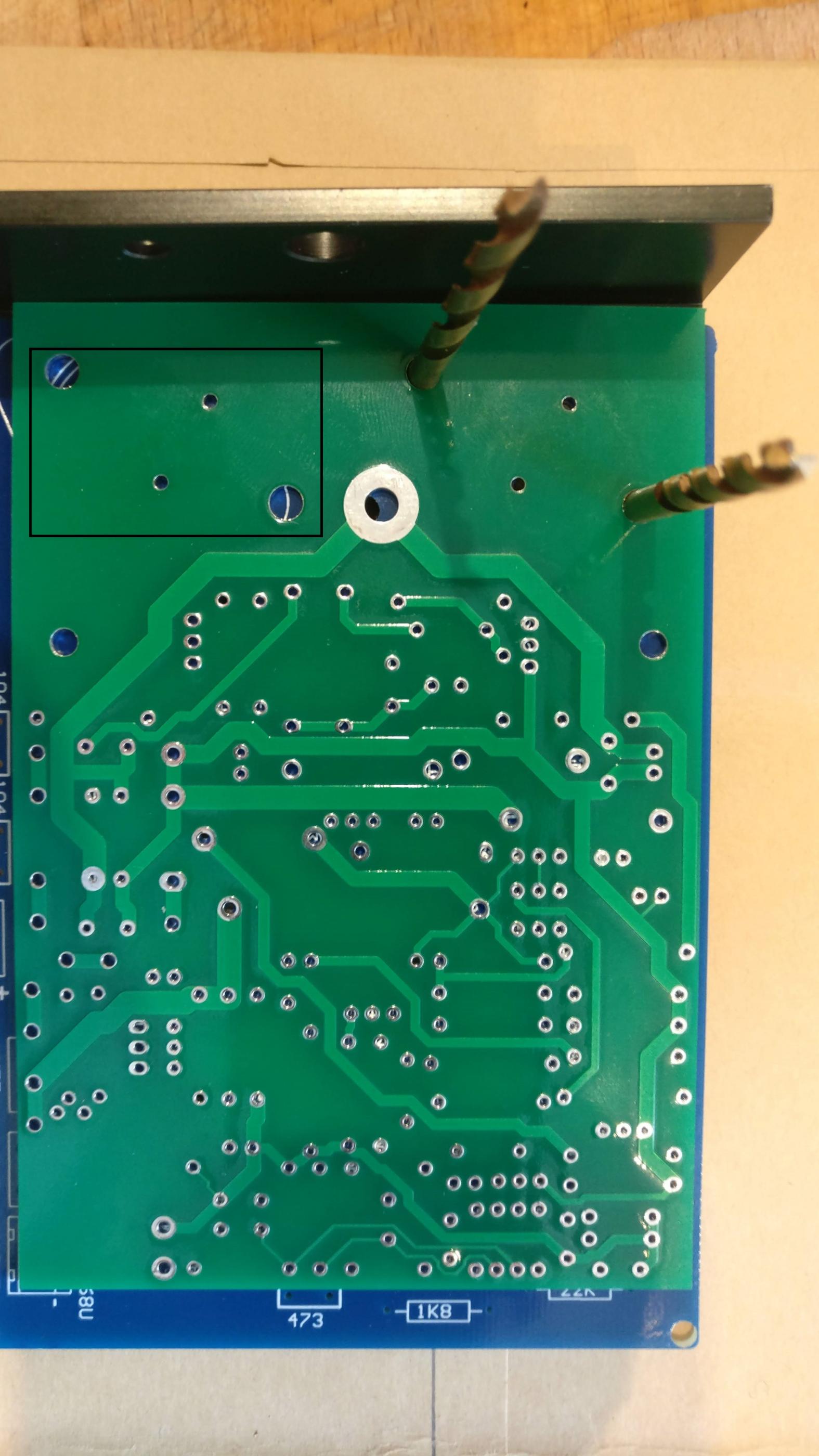

John you also saved yourself a heatsink problem. Boards arrived today and from the back of my mind came a recollection of something I read on the DADA site years ago. The early Jims board is 90x126mm, his 405-2 board is 82x119 so the heatsink/bracket for the early boards that is easily available as a seperate item and fairly cheap is no good for me. For those without the luxury of a metal working shop it means that something that should have been building by numbers now has real work involved.
I will have to source 2"x1"x1/4" unequal angle 6063 alu and have to route or mill the cutout along the 2" leg for the TR7&8 and those components between them.
To avoid having to do no more than drilling requires angle with one leg 1.25" to provide correct mounting for the TO3 devices. It also means that the 2 TO220 devices would have to have their own plate or other off the shelf heatsinks, similar to the Net Audio boards.
I wonder how many jobs get bogged down because of the need for more complex machining procedures, chain drilling rectangles from 1/4" stock is no fun.
I started out on this job with the intention to build from stock components and have an enclosure with the minimum of effort on my part but find myself needing to put effort into the metal parts.
Heres the two boards side by side with one of the TO3 indexed. There is another variant on the auction sites from Jims, perhaps the orginal clone before they all started selling them, this one is close to the OEM in dimension unlike the ones I bought a long time ago. Class A dynamic biasing 80W amplifier PCB Quad 405 2pcs | eBay

Bad luck Ian.
Yes, that's another advantage I forgot about.
You can modify the Ali with an Angle grinder, files and sandpaper....
Probably quicker than getting someone to mill it.
As I mentioned in my other thread on the 405's, I wanted to delete the Current Limiting completely. Which I suppose makes it a Quad 405-3 ; or at least 2.5 🙂
This is the feature of the amp which is most 'trash talked' by far on the internet. And I thought it sounded better without it. Although it's hard to be sure of these subjective things.
To some extent, it doesn't matter which version of the boards you get, if you're going to modify them a good bit. And the Mk1' clones I got were actually good quality boards. Significantly better than the old Quad originals.
You can't be sure what's inside the power transistors, but I've only ever blown 1 up - and that was with mental levels of sub bass into 2x12" drivers in parallel.
I also managed to fit a couple of these clone boards into a genuine 405 case - which several people on the internet say you can't. You have to trim the edges a bit & be careful - but it worked with the ones I got.

I am the man that many are envious of, I have a Bridgeport Interact in my workshop. It spoils the fun though, the object of the exercise was to assemble a finished amplifier with little more than soldering iron and cordless drill.
Things have changed yet again, my friend don't want my original build, even for free. His interest is piqued by what I am going to build and he is willing to stump up the money so I ordered some more of the copy of a copy PCB's.
Its a brazen world when a design is improved and copied then copied again by another party.
I have been tracing the PCB layout and see that it is precisely the same as that offered by a builder/supplier in Northern Europe complete with flipping the input, placements for 100uf electrolytics between the fuses and so on.
The current limiters and caps C18 & C19 have placements but to remove them from circuit R35 & R36 have shorting links placed.
I read that with TR9 & TR10 17556 devices the current limiters have a place but with the MJ15003G commonly used there is enough overhead not to require them. So much information and also some amount of contradiction to be found on this amplifier.
Yes, the original intent of the current limiters was to protect the old 17556 transistors. And then - they were only needed when driving low impedances. This was partly because these amps were used a lot in pro audio, where they were thrashed and expected to survive everything.
Now these devices are 40 years out of date, and have been replaced by much more rugged ones - there's no point in the current limiters.
