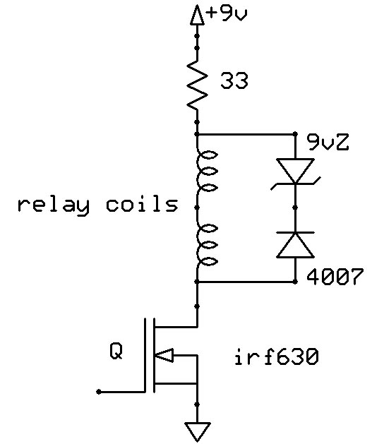

I have adapted your circuit for my relays they have 5V & 28 ohm coils with a spst 30A N.O. switch. I have to use two devices for the job so I connected both coils in series. 2N7000's didn't quite squeeze in to the power margin. Ill try an IRF630 Mosfet.
Coil Power, How low can I go? Ok the two series coils are now passing around 100mA at a voltage of close to six. The contacts in the switches clack in and out ok as expected - no load on the switches. The relay datasheet states that the nominal current is 185mA & 5v for one coil. I will have to test the circuit under load to see if she does the old click-clack.

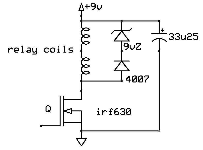

9Vdc for a pair of 5V relays in series is too low. Adding a 33r resistor makes that problem worse. If the 9V drops for any reason or is slow to reach full voltage at start up then the relays may not trigger.
Add an electrolytic to your schematic. The +ve lead goes to the top of the relay coil.
The -ve lead goes to the Source of the mosFET. A 200V device here is a waste, any 200mA, 30V or more BJT or FET will do as a switching device.
While the FET is open, the cap charges to the supply voltage, whether it's 8Vdc or 9Vdc and holds that charge until the FET conducts.
The cap sends a short current pulse into the relay coils that triggers them. This pulse only needs to last as long as the datasheet time for "ON", usually of the order of 3ms to 15ms. Try a 33uF 25Vdc cap.
If you can, increase the supply voltage to >=10Vdc. I tend to use 1.5Times to 2Times the rated coil voltage. Then adjust the resistor to bring the "ON" voltage down to about 50% of rated coil voltage. This ensures a fast and positive "ON" that never fails if the supply is slightly low or slightly slow to reach operating voltage.
The resistor can run pretty hot. Use enough dissipation capability.

Does this one look a bit better?
I didn't anticipate the required voltage-margin-overhead. A safe buffer.
That 9V in the schematic is 1/2 of my dual rail 'preamp power supply', I can invoke the negative half, if required to give me 18VDC - then use a resistor. Or I can use a different transformer, - I have quite a selection of the small pcb mount devices - all recovered from the tip! Not that I'm tight or anything.

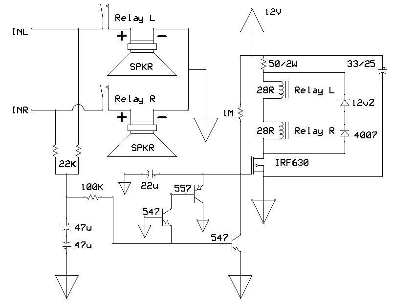

Here is the circuit given to me. Don't know what the zener does but I guess it just takes the tops out of the BEMF spikes, thus limiting the pulse that goes back into the positive rail?
Recommended nominal current for each relay is 185mA but according to instructions I have cut it back to about 110mA. Any less and I can tell that the contacts are not switching solidly.
Can someone give it a quick once over.

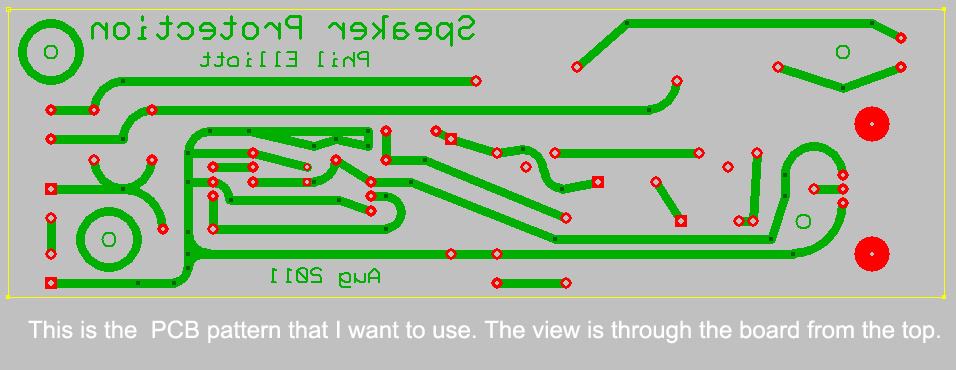

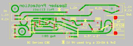

PCB
Hi there J: I have checked the pcb several times and it reckon it matches the circuit drawing, I just wanted to show off my new CAD drawing skills! Here is the pcb pattern looking from the top, without the components. Have a good weekend.

It is a work of art and it artfully works! See how much faith I have in you fellows!

in the previous post you reduced the 33r resistor to 0r0 to account for the 9V supply.
This diagram shows a 12V supply so the resistor value can be increased above 0r0. But you have the 33uF cap tapped in above the resistor. It should be tapped in to the top of the relays.
