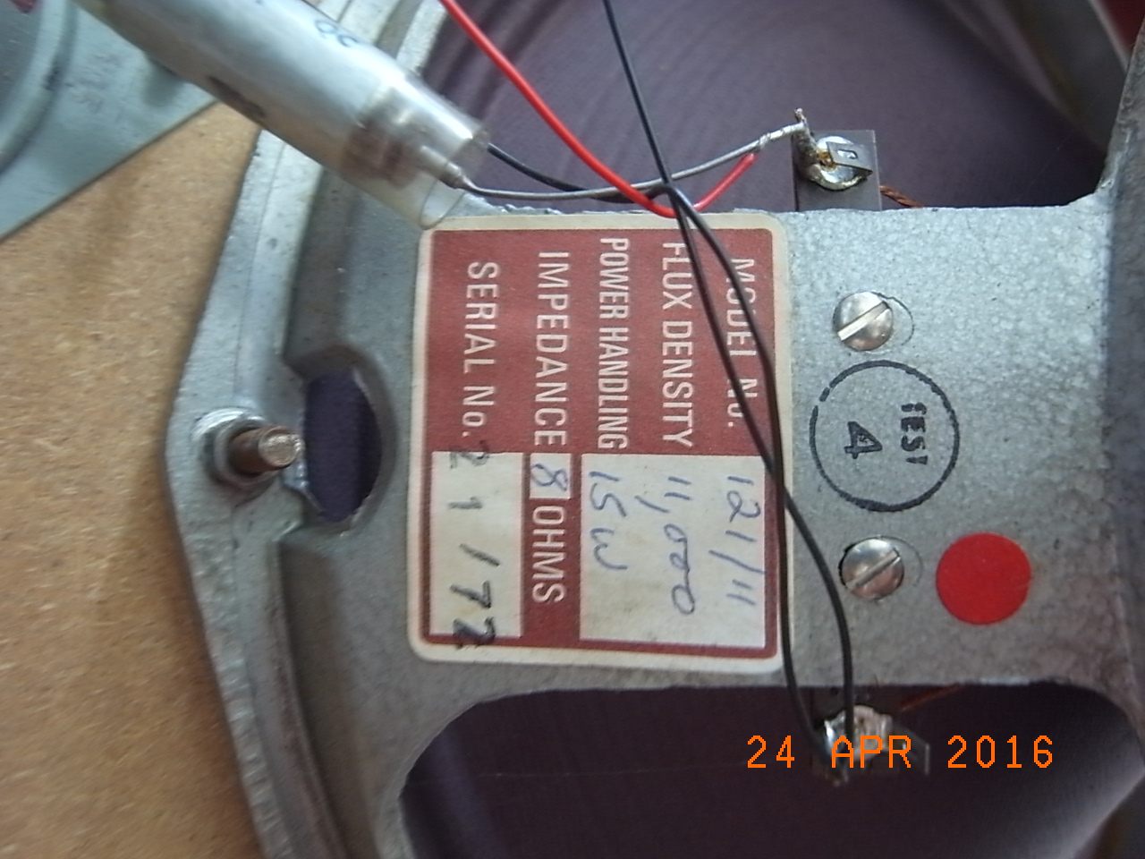

Here are a couple of pictures of all the data I have on the Fane speakers, which is limited to the label on the back!

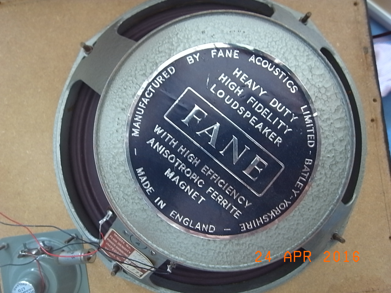

If you're attached to these drivers, I'd start out with an open backed design, but add batons so you can add a back plate later on. These drivers were made mid-1972, so any specifications Fane had will be almost guaranteed to be different to the drivers in front of you. 44 years will do a lot to a set of speakers.
So, in the presumed absence of any measurement equipment, I'd set off with the assumption that they might be high-Q drivers, and see how they do in a dipole system. If there's little-to-no low end, you can put the back on (maybe with a bass reflex port) and see how that goes. Some playing around with the cabinet will be needed if you can't measure the drivers.

Apparently an OEM # for use in various Hylight SE4121 [4x12] open back guitar cabs, so 'reasonably sized' would need to be either open back or at least stuffed with a screen or similar 'open' rear panel to contain it:

Whatever the speaker size is, they are some very serious magnets.
It looks like a 12" with monster magnets. At 15W power handling
its perfect for retro valve guitar amplifiers, not good for hifi.
