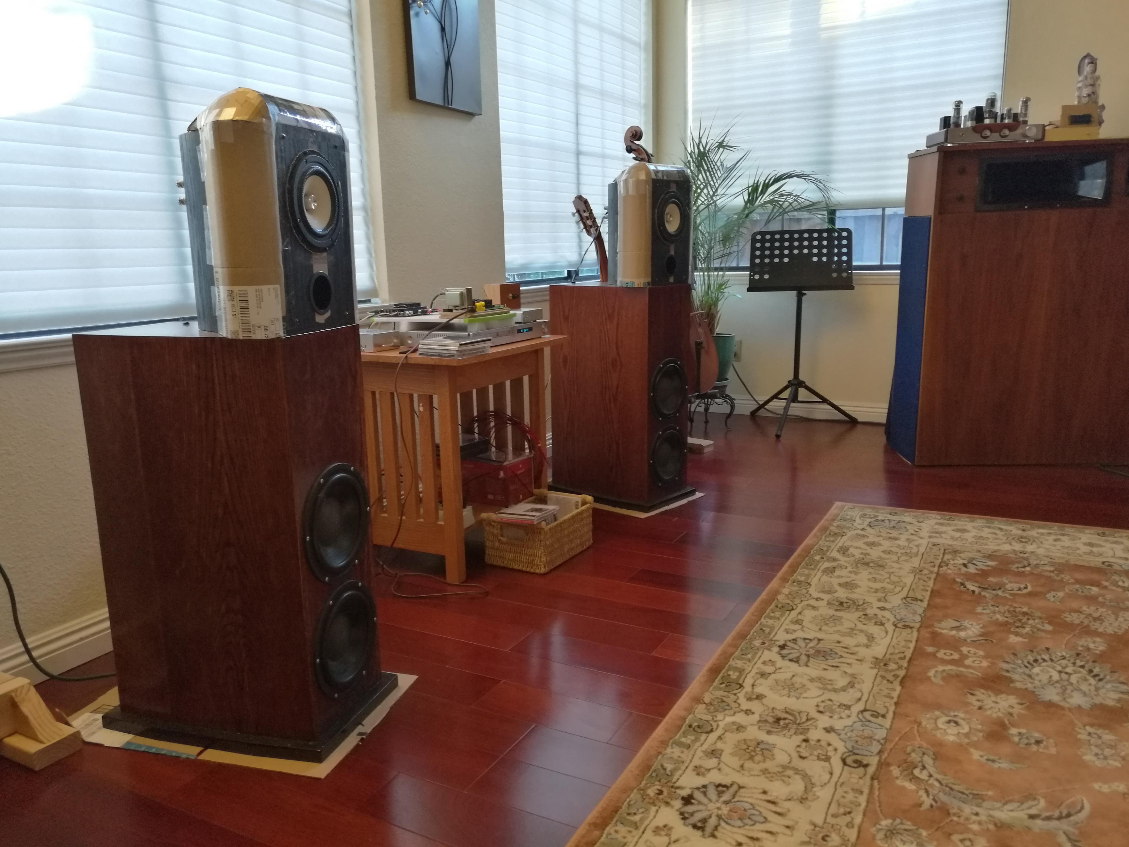

A picture is worth a 1000 words --
The bass modules are from a high-end kit I built >20 years ago. They are 10"Wx17"Dx30"H, each having two 8" woofers, in an aperiodic alignment (a slot in the back).
By the way, you can see one of my horn speakers (Speakerlab K) in the picture.
Kurt

Those horns are huge, but so are those bass modules.
You haven't seen my old OB system using four 18" woofers and a 75" line source on each side. I had to dismantle that system when I moved from Chicago to California. Based on memory, that big OB system is still the best, most satisfying, speaker system I've put together (note the qualifier). The bass modules used in the W5 system now actually came with the line sources as a kit.

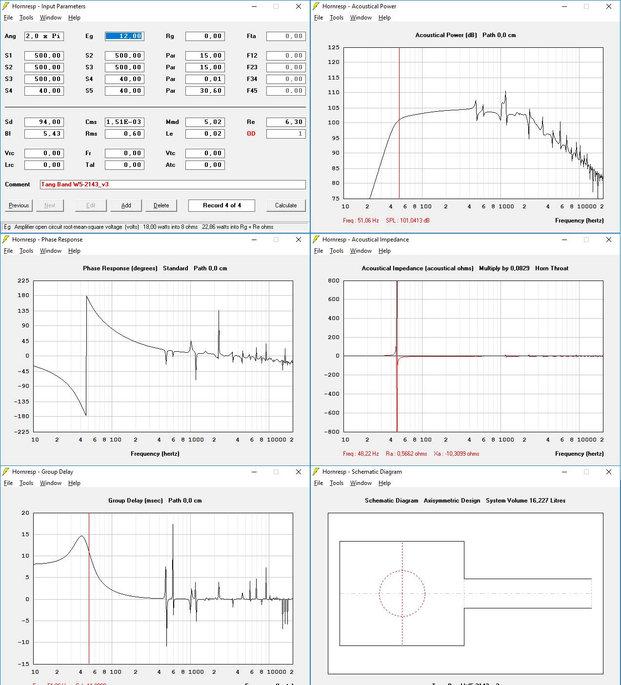

Unfortunately the W5-2143 was never simmed for the XKi enclosure, however X built a foam core XKi with the W5-2143 driver - and he loves the sound. There are even sound clips of this build on that thread. He had plans to do the XKis in plywood, but something went wrong and it never happened. X is a busy man.
W5-2143 can also work in the mini Karlsonator. Here is the sim:
Mini Karlsonator (0.53X) with Dual TC9FD's
Does not look like there are any mini K builds with this driver. I might be the first when I get my hands on these drivers one day.

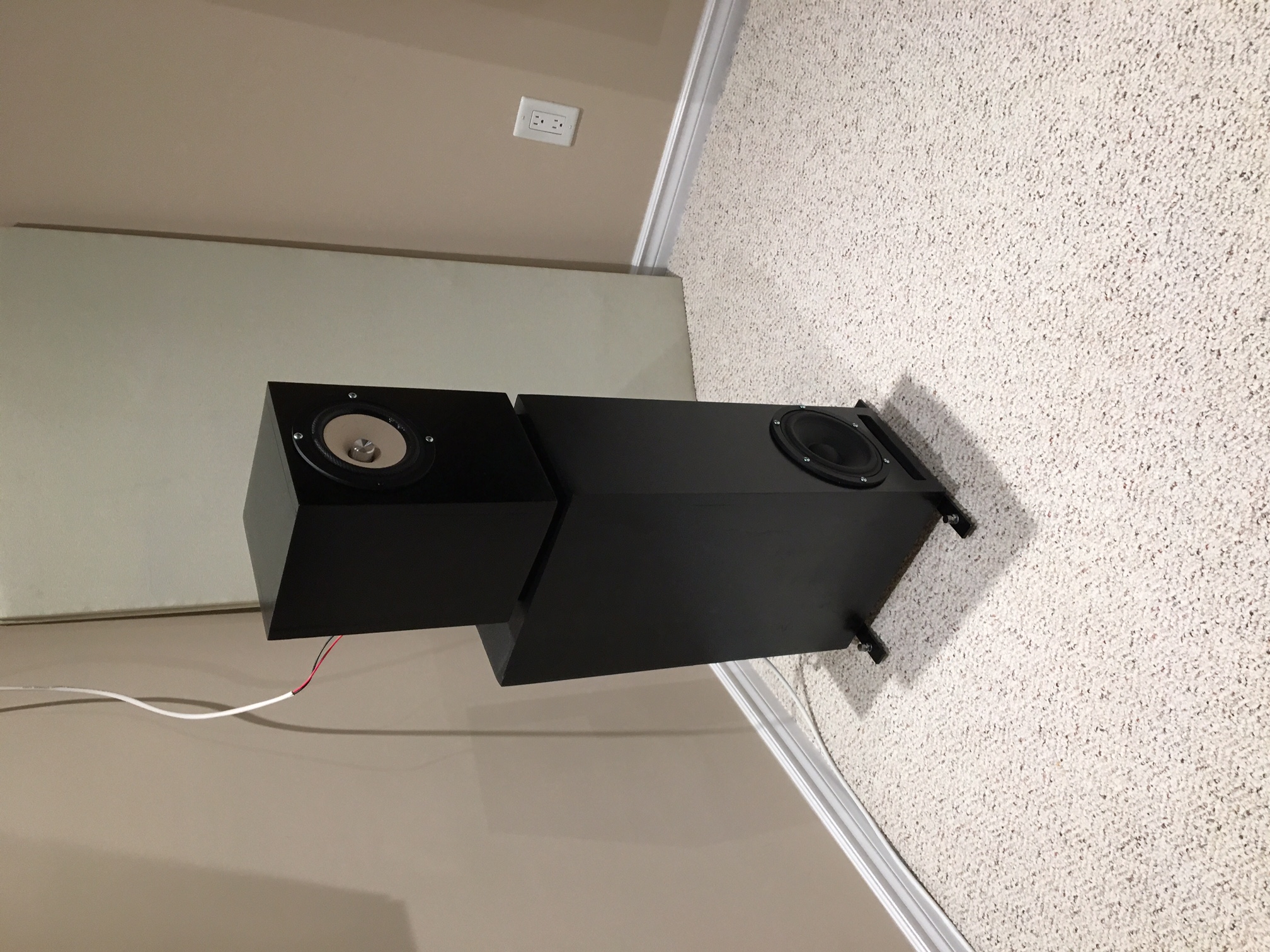

I have been using the 2143's for a year now in sealed 0.2 cubic foot boxes. I run them in a WAW arrangement. The Creative Sound Solutions 7 inch woofer is run in a 0.75 foot box ported to around 30Hz. I use an active Xover to contain the 2143's to 300Hz and up. The bass boxes (acting as speaker stands) handle below 300Hz.

Interesting setup. I like the idea of using the bass boxes as stands for the FR.
I am a newbie here gathering info on WAW options. From what I've read, it is said for a FAST, the distance between the FR driver and the Woofer must be less than 1/4 of the wavelength of the XO frequency. I am just wondering if you would get better results if you turn both the FR and Bass boxes upside down (rotate 180 degrees) so that the two drivers are close to each other? Might be an interesting test mcgsxr.
I was going to say the same thing. +1
Nice looking boxes though.
Btw, I recently bought a COTS HT style 10in sub in a nice looking (Polk PSW10) 1 cu ft cube with built in amp and xo for about $100. It made me think of them as stands and woofer below 140Hz. You could go OB even with the 2143. It’s a big woofer so can handle the 140Hz XO just fine. Anyhow a cheap and easy FAST or WAW using HT box subs.
mcgsxr's setup is very similar to mine, but much prettier.
In his setup, my guesstimate is that the null at 300Hz is at bout 54 degrees from horizontal. Not sure how a null in that direction would affect the overall sound, but I doubt that it would render a good integration of the driver outputs on the listening axis unobtainable.
Also, placing the woofer close to the floor has the benefit of avoiding or mitigating a null caused by floor bounce. Moving the woofer up to get it closer to the W5 might actually make the bass worse.
Just trying to "rationalize" my (and mcgsxr's) way of doing the WAW. 😉
