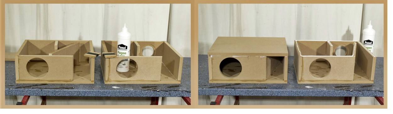

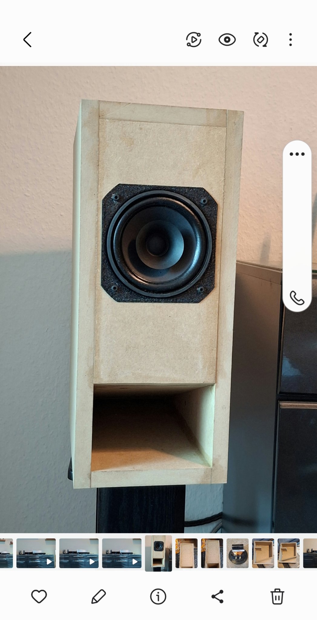

Enclosure for Monacor SPH-60x
Just like in the two photos!

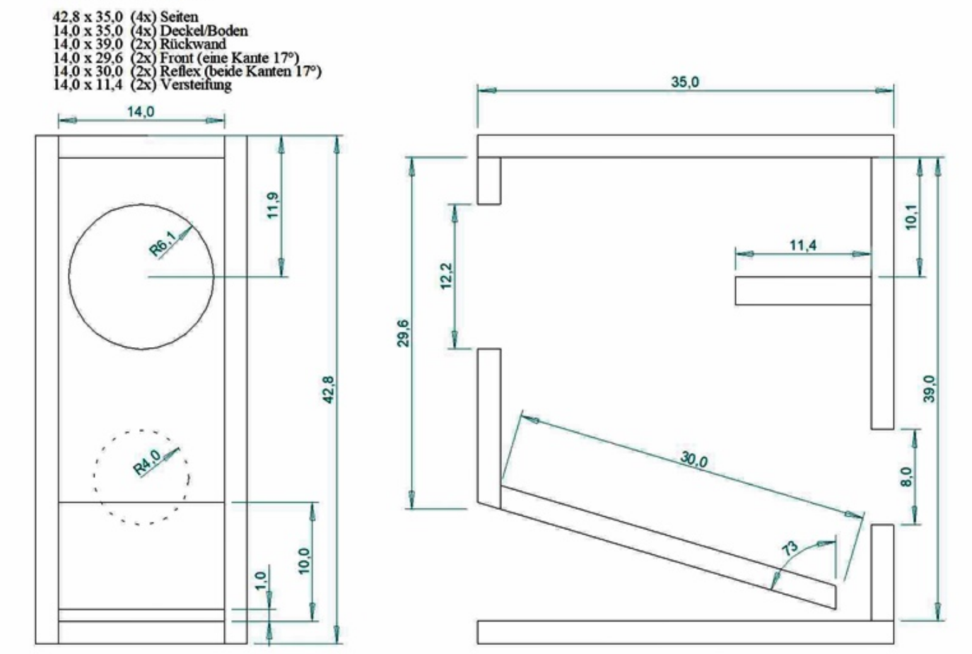

Franz Sh.

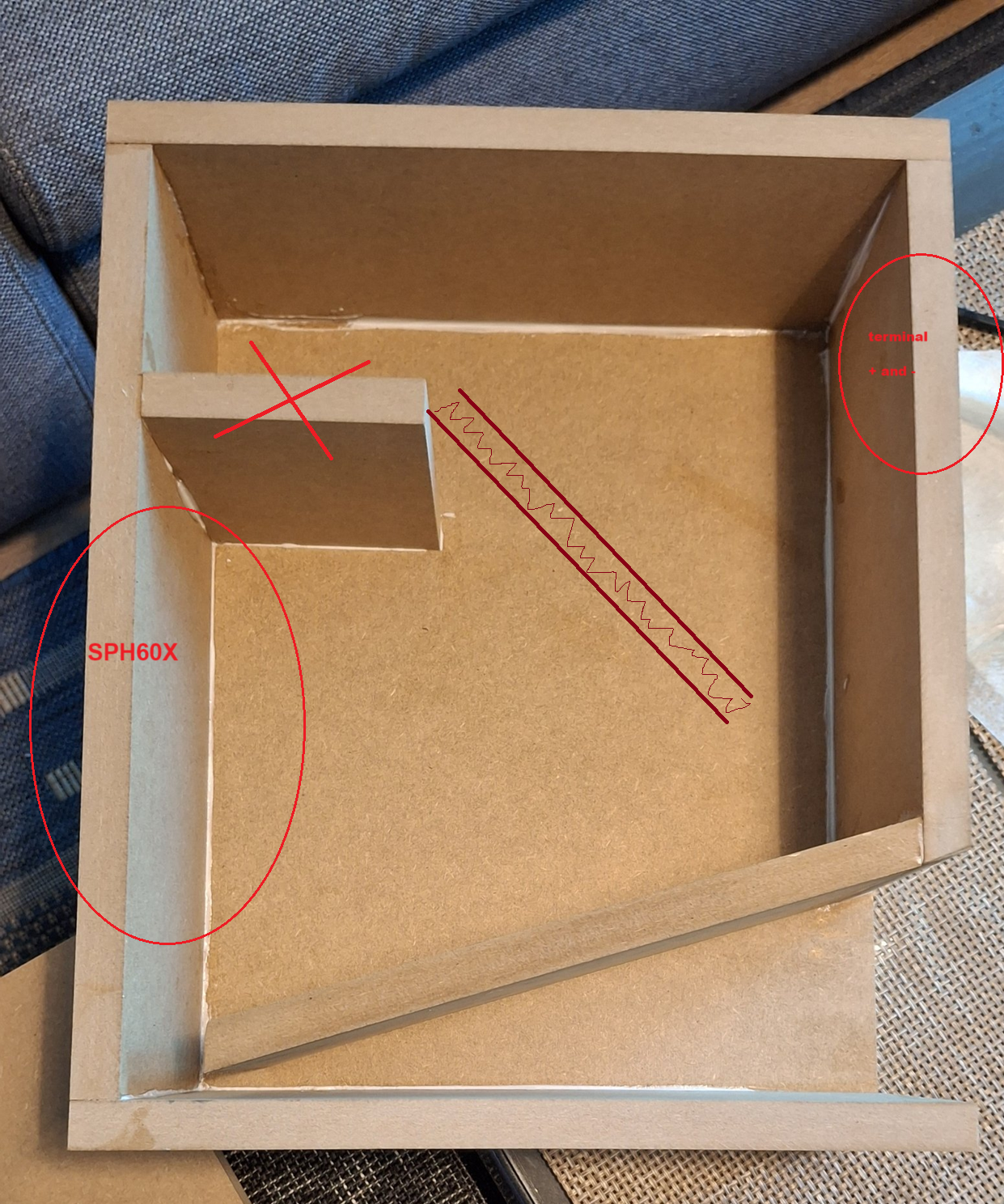

The small stiffening board looks nice, but doesn't help at all - it should be placed differently, perhaps at a 60° angle - and it may take up a little more space.
If
  • the driver now changes its position sensibly, the “clear” dip will also disappear. Damping material, the Visaton polyester stuff ... (or 100% cotton wadding) is a good choice
  • one would like to see the port (the midrange horn!) at the front, than one can of course copy Udo's suggestion exactly, or the Alpha of the horn friends Till and Raffi !
HBt.

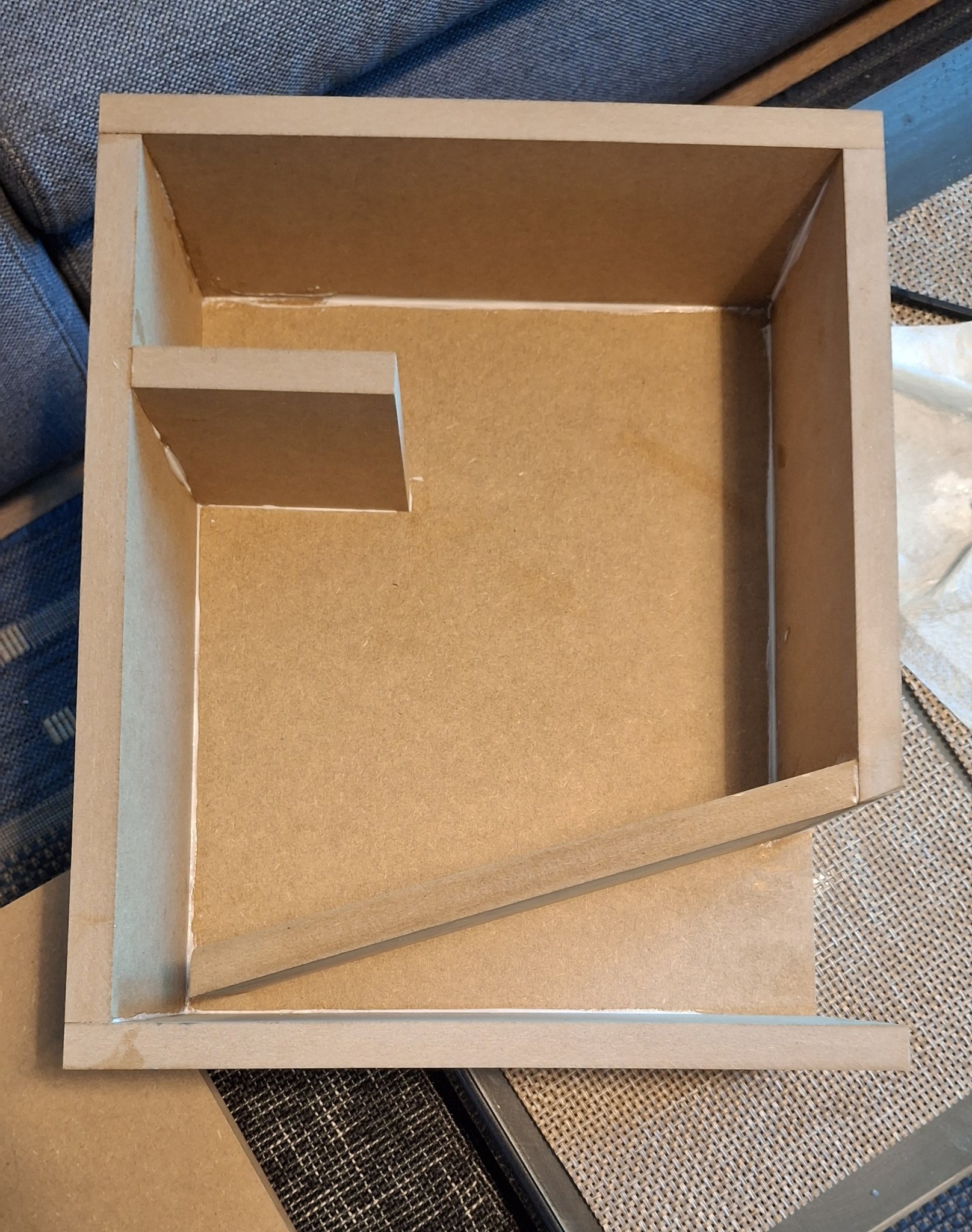

I built Udo Wohlgemuth's version.
The board sits just right? It acts as a stiffener. I wouldn't build it the way you drew it.
The membrane is wafer-thin; the board sits much too close to the membrane.
Secondly, you can control the shrinkage by lining the side walls, at membrane height, with 1 cm of felt and inserting the polyester batting directly behind the membrane, not stuffing it, but plucking it in finely.
What we see at first glance
The little board can stay where Udo glued it in. In the first proposal of the K&T, our Udo had not yet glued the board. He only came up with the board idea later.
Naturally.
Of course not. You copied Udo W.'s latest suggestion.
I would like you to explain this assertion in a plausible and technically correct way. There are no problems in my SPH60X box!
Stuffing is really not a good idea.
I assume the author of this thread has learned everything he wanted to know.
On Udo's famous photo series you can clearly see the procedure, there the stiffening board divides exactly (pi times thumb) the back wall.
This looks completely different in the housing drawing. LS of this type are created in 5min. They are simply fun projects ..!

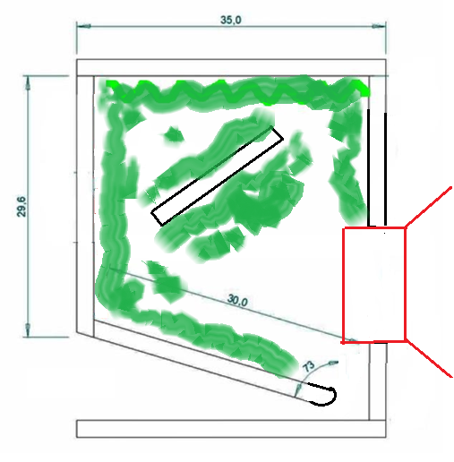

I built the case for the SPH-60x like this.
Initially, I filled the case completely with polyester wool from an Ikea cushion.
However, the following damping is better: the red area is a leftover velour carpet, the green area is convoluted foam.

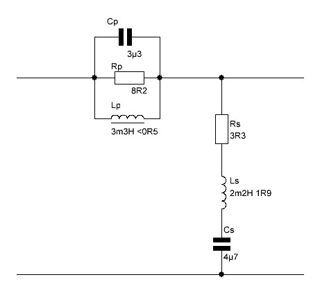

And I equalize the entire frequency range from 20Hz to 20kHz at one-third octave intervals; passively using a broadband blocking circuit (Rp=8.2Ohm, Cp=3.3µF, Lp=3.3mH) and a narrowband absorption circuit (Rs=3.3Ohm, Cs=4.7µF, Ls=2.2mH{+ 1.9Ohm}).

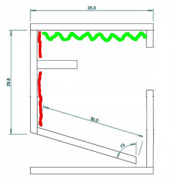

A few details about my housing (I have found all my records in the meantime):
Width inside
16cm
Height inside
29,3cm
Depth inside
31,6cm
The BR board is 28.4cm long, the reflector 16*16cm, AH 25.6cm^2 & AM 64cm^2. The port is at the top and directly opposite the driver.
My baffle has an outer width of just under 20 cm.
It is worth delving deeper into the subject of LS (with this at first glance simple concept, CT193 ). Where should the driver be placed and where is the best place for it? This is just one of the usual questions, because ultimately it's about sound dispersion and not just about the resulting HP, i.e. the BR-like cabinet.
Dear rebuilder, please coat the membrane completely with Visaton's coating (LTS50 is the name of this liquid stuff), including the “swivel cone” - up to three procedures are ok.
HBt.
