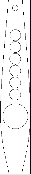

DIAR said:How do I figure out how wide by baffle should be. I know Ted Jordan recommends as wide baffle as possible (e.g. IB). I would much rather have as narrow baffle as possible.
If I use e.g. Tangban W3-871S linear array with JX150, should I choose narrow or wide baffle or possibly a curver baffle to minimize corner diffraction. Do I get better imaging with narrow baffle or is that only a myth. A wider baffle enhances lower midrange but I don't know if it is a good or a bad thing.

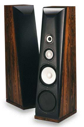

Like you, I like narrow baffles. These also have higer WAF. I kind of like the Theil type baffles. Don't know whether they're easy to DIY or not.
There was also someone that suggested Nautilus shaped baffle which also seems technically good. These would come out wider but would have a more artistic styling to it.
Just some ideas. I might try the Nautilus shape some day.
Theil? I'm not familiar with such baffle 😕

Does anyone know any good internet sites about liear arrays. I suppose that it is essential that baffle is identical for all drivers? I mean can make a baffle which is wide at the bottom and narrow on the top...

The reason why many baffles are oddly shapped or have drivers placed at different locations is that you don't want the wave front to reach an edge at the same time and suddenly expand into open air. So you either round edges (large R as possible) or position drivers/shape baffle such that a wave front reaches the edge through a distance.

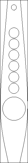

DIAR said:Here's an example. If the front baffle is shaped differently around the drivers, will it destroy the whole idea. In this kind of enclosure every driver will sound different.
Technically they would be different. But there are many factors that would result in different sounding drivers.
1. Interaction of the wave from one driver on the other would result in the center drivers and the end drivers being different.
2. If the line array were in one sealed cabinet. The location in the cabinet would be effected by any standing waves present if damping is not good enough.
3. The baffle is not perfectly ridgid, so the natural vibration modes at different locations on the baffle would effect sound.
4. Baffle shape and the varying distance to any edge would also create sound differences.
It would be ineteresting to know which factors would have more significant influence.
