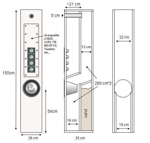

I've been designing a speaker enclosure which has JX150 MLTL (by GM) for bass/bass+mid region. For upper frequencys I have a special enclosure which enables me to change easily between Jordan JX92S, Dynaudio Esotar2 tweeter, Jordan JX53 single/linear array or Tangband W3-871S. The enclosure has a changeable front plate and large volume which can be of cource filled or even used as BR.
Can I fold an MLTL enclosure or should I stick with the tall version?.
Have you thought about MLTL enclosure size. CSA is 289 cm^2 which is 15.3 cm * 18.9 cm. That is exactly how much JX150 needs room (all sides are touching the cabinet walls. Tight spot...
Should the space around the driver be wider so that CSA is 289 cm^2 + CSA of the driver?
What do you think of this?

Yes, you can fold it.
?! The info I mailed you listed 113.726"^2 (733.7147cm^2) or ~3.5596x Sd, which equates to a golden ratio of ~13.56" (34.45cm) x 8.38" (21.29cm). Plenty of room. 😉 If it had been so little though, then yes, the width should be increased, with the magnet up against the back wall if need be.
If you build it this size it would have an F3 ~10Hz higher, though Fb would only rise a few Hz, with transient response slightly degraded due to the too 'tight' a CSA. Increasing stuffing density would cure this though, making it more like a 'classic' TL.
The proposed layout is fine assuming the distance between the array's and woofer's acoustic centers are <1WL of the XO point, and preferably < WL/pi, though vent output will be rolled off ~3dB due to lack of floor boundary loading, and of course the too small CSA for max LF gain.
GM
oh... I miscalculated CSA. Embarrasing
I haven't got any mail from you 😕
Could you send it again, please:
hifisti (at) hotmail (dot) com
I'll have to post a new design later today. I'll try to concider all the pointers you gave 😀

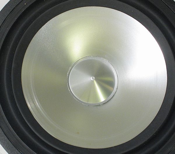

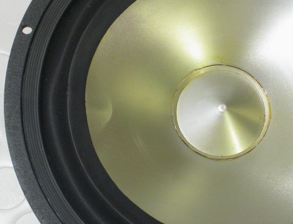

DIAR said:I bought a few JX150 drivers yesterday. I've never see build quality this bad... Luckily they were cheap.
It does look pretty bad! Is that a loose VC cap I see?
Where did you get these from? How much did they cost?
I bought them from a hifi store. They were the last three that they had so I didn't have much to choose from I'm not sure yet how much they will cost (i haven't paid anything yet). Maybe max 300€ for two + one dented. I will do some measurements and if there are some abnormalities, I will take them back.
There is still one another shop which has a few drivers left.
The cap is not loose. Just glued carelessly. They have smeared the cone with glue and even used different kinds of glue. One is glued with epoxy and the other with contact adhesive. Other than the cones the drivers look very convincing.😎
