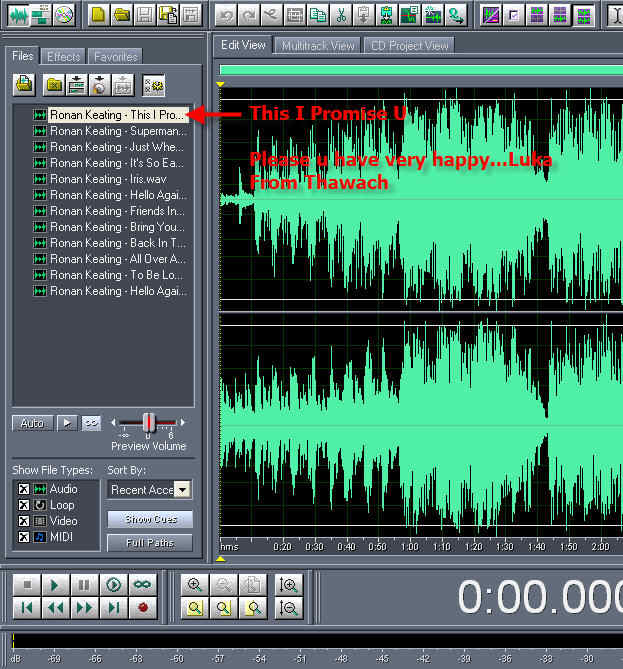

"My love, here I stand before you I am yours now From this moment on Take my hand Only you can stop me shaking We'll share forever Thik I promic lu....do..re me....My darling, thik I promic lu thik I promic lu, oh thik I promic lu, promic lu
Thik I promic lu" the end...lol
luka with u I'm very happy. now I am sing this song follow with ronan keating..lol luka i have just been knowing to has ronan keating Thailand version..my sound is very bad lol Luka i know that's near to close this thraed. Please drink with me :cheers: i wait along time until u finished. moderator Please let me go continue....don't stop me if moderator stop me. i will send the back EMF to moderator. your damping factor may be drop and has a problem with your input.(lol) if some moderator say to me. i will say "moderator my english lg is low quality i cank nok understand"lol luka u and everyone know that has the superman return. now i will say that's here is youngman return.(lol) it happens when i saw the red box. and think in the past. it'make sense about love when i learned at high school. ok steren has the sense about speaker. and ok olson has the sense about wild wild west and the wolfs. lol they don't have any sense about love. luka i would not talk about them very much because they will know about this thread. LOL tonight i will drink and still not sleep until the morning i think sometime Larry to drink with me and happy together. and here is the end of my reply on this thraed........thik i promic lu. lol :drink:
thank you luka and all/😎
