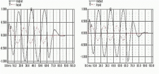

I also include this side-by-side chart of a Peerless woofer-not an XLS-in similar ported and Passive Radiator systems. I found this chart on the net somewhere, I did not make it. It is also included in that thread, on post #6. So you can see a difference, which is evidence on the last small pulse.
However, you should understand that our ability to hear these differences in transient response decreases the lower the frequency, and that the "overshoot" decreases the farther away from the resonance frequency you get.
