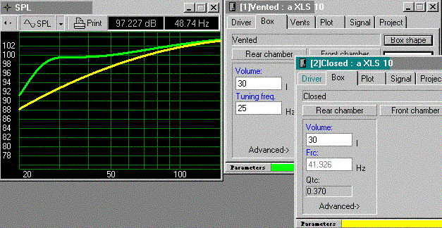

You mis understood what I had meant. I am using the XLS with EQ to get it too do f3 of 40 hz, I know you get an f3 of 80 without this. SO what I had said still stands, oh and excursion isnt really a problem as the mids bottom out before the bass in my set up.
The point of the XLS is lower distortion and much smaller cabinet over the 850146.
It has also been decided at one point that the 850146 sounds best in a sealed cab on the madisound board. I dont know if I agree as I hvnt done ported with it but sealed does sound very good to me.
Non optimal
105 EBP
=ported box Definately. If u dont follow the general rules you cant expect to succeed.
sealed= not a sub in this case.
look at the response!
Definately not optimal,i see no reason to make a sealed box for this woofer.
if u cant fit the ports,then dont try buildign a sealed box with this woofer.Or try if u want to waste money on quiet subwoofers
Sure it may sound good-but very quiet
With all that EQ,youl have no headroom left,and no excursion either-unless you enjoy 90db levels.
What exactly are u trying to achieve/ a LACK of bass? personaly i go for FULL FLAT or slightly overdamped responses!
not completely -lacking -in -bass- responses
and about Madisound forum deciding that 'sealed is best' , an intelligent person ,is one who knows who to copy (eg the right people)
what if they like a 'lack of bass' and a huge roll off?
you cant just say 'they said so,so its true'
Provide facts such as ='with 250watts RMS and 9db EQ i can still acheive 104db '

Bah you dont get it again!
I DONT WANT FLAT TO 20HZ
Im just going for the same response as the 850146 or slightly better with EQ for music purposes. I dont think that f3 of 40hz roll off 9db per octave is lack of bass!
I simulated with BOTH the 85-146 AND XLS
When the XLS HAD EQ added, it played to the same SPL as the 850146 until they both ran out of linear excursion.
The mids in my speakers run out of excursion before the bass does now anyway SO I DONT NEED ANY MORE! on the bass, flat to 20hz? I cant get 20hz in my room anyway its too small pr at least it seems that way.
What music do you know that has a huge amount of 20-30hz material, none of mine!
I said before this was for music and not HT I dont need 20hz or massive SPL, its for music to go to f3 of about 40 hz. So therefore I do have what I want! I will see how it turns out anyway. You may be right but for my application I dont need SUB bass. Im not designing a SUB just a bass box for music.
