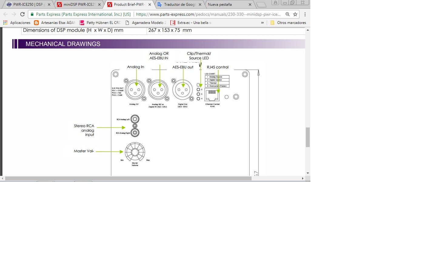

😕 But, I am somewhat confused with modern technologies. Can anyone tell me if it is possible to use the MiniDSP connected to my valve amplifier by means of the speaker output?
Can I connect the balanced XLR Analog 1 and 2 XLR connections directly to the unbalanced outputs of the valvular amplifier output transformers?
Is there any risk ? 😱
To be clearer, can I use the MinDspi connecting just as the Dayton SPA250 would do using the high-level connection ?
I attached the information, thanks in advance, friends, and, sorry my english..

I am not familiar with these electronics either, but 'balanced' to 'unbalanced', maybe this will help: Sound System Interconnection

Thanks for the link. 😉 It has helped me to realize that I have confused the XLR (balanced, line) connector with the Speakon professional speaker connector (high level)
Definitely, MiniDSP PWICE250 can not take the signal from the output stage of an amplifier. Be of solid state or with valves.😡

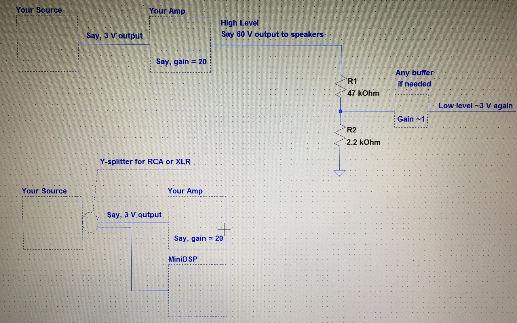

Just use yours preamp output paralleled or place 20 kOhm to 1 kOhm divider and you will have common line level from your high level.
How would this be in a basic circuit?
Could you draw it? Thank you !

Ohhhh, different languages sometimes cause misunderstandings ...... I do not understand that phrase, but you can rest assured that mine is very serious. What happens is that I no longer have the neurons so agile.
The diagram is excellent, thank you very much !!!
The buffer would be a series resistor to balance impedances, am I correct? An approximate value would be 47 Kohmn ?

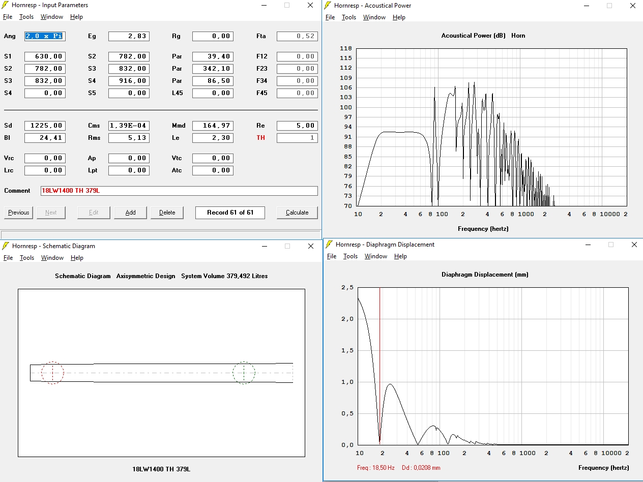

20 to 80 Hz flat, that's exactly what I need ......
but VAS 379 liters ..... it's too much....😀
No, buffer is a some kind of follower with unity gain, it must have high input resistance (in range of megaOhms) and low output impedance (in range of Ohms/milliOhms).
High input impedance will keep divider from any loading and low output impedance will keep you from hearing wires/connectors/etc.
Balancing impedances for single-ended source needed with balanced receiving for keeping good CMRR.

But WAF has rebelled these days and I do not know if I can embark on making a new cabinet. Problems of size, of course, is always the same in marriage...😀
So I had an idea, but I do not know if it's good. You know Troels DTQWTII, what do you think of connecting MiniDsp only to the bass section? 2 x Eminence DeltaLiteII will be able to descend to 20 hertz without having mechanical damages? . 😕
Remember that I do not have SET, but push pull valves Prima Luna. Then I would not really need the specific network to reinforce the bass zone as it was created by Troels for 300B or similar. I could undo this divider easily because I have provided double connection binding post terminal in my construction, and connect the PWRICE250 ....
I leave the Deltalite 2510II links to see TS (xmax seems small for use as subwoofer ....)
