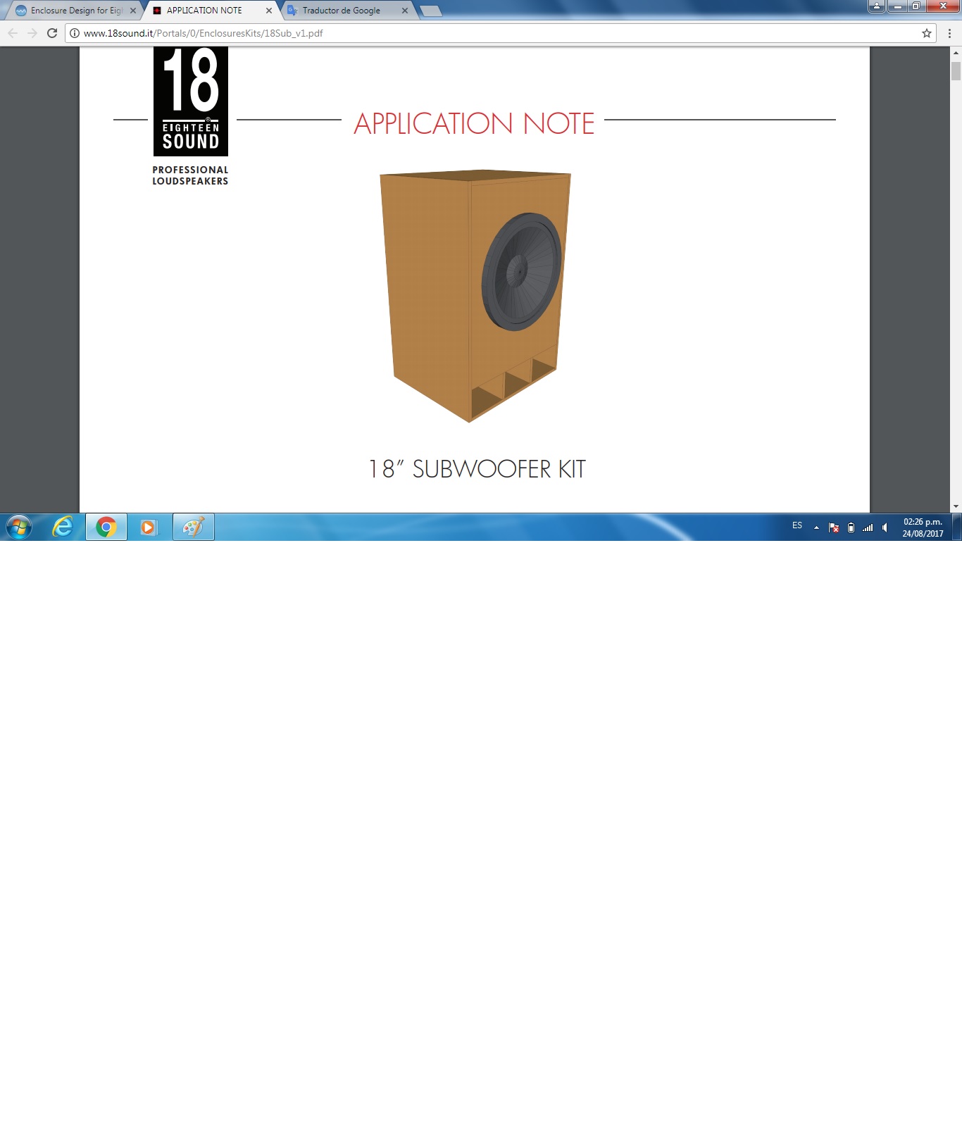

Do you have plans for those sealed boxes?

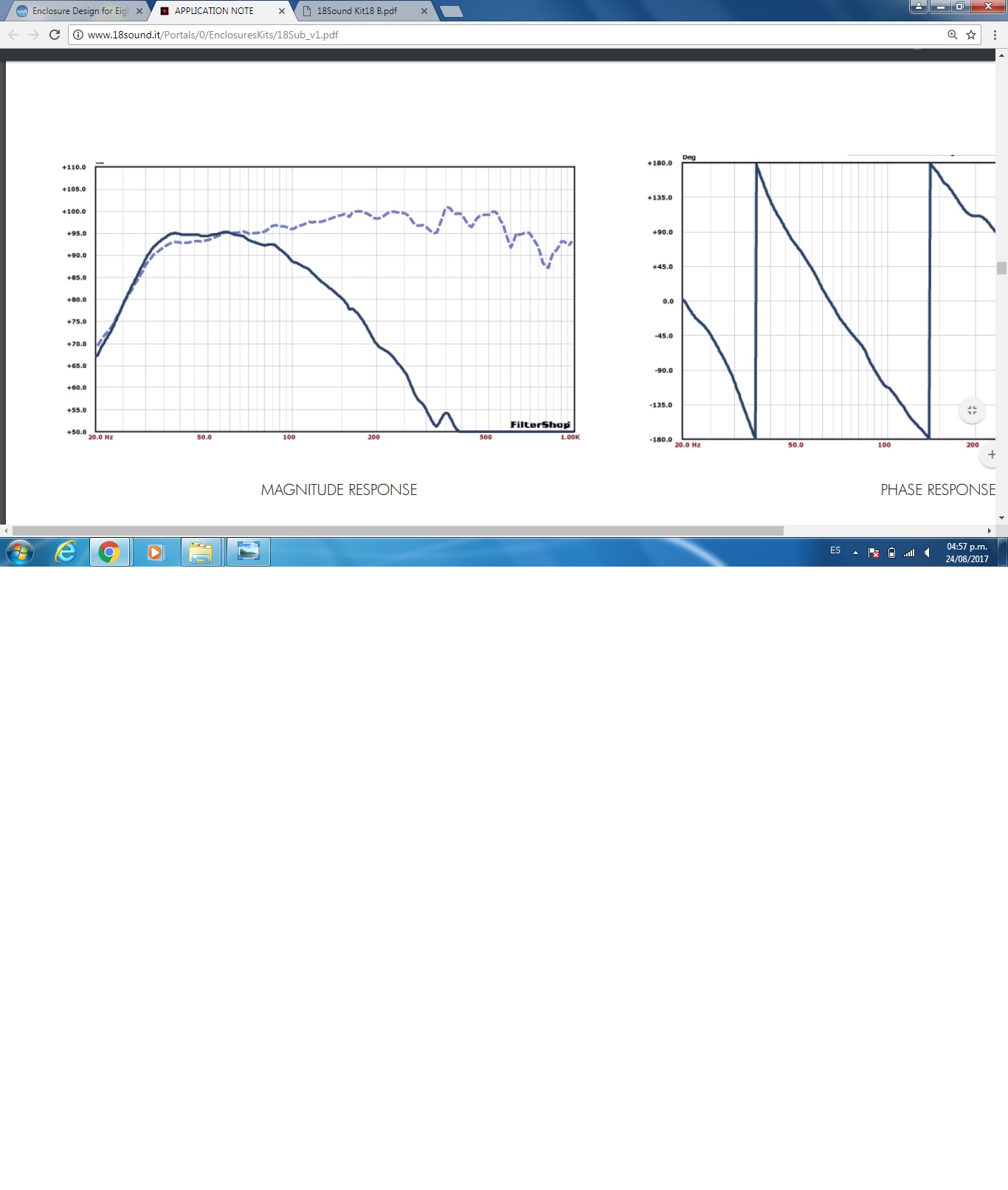

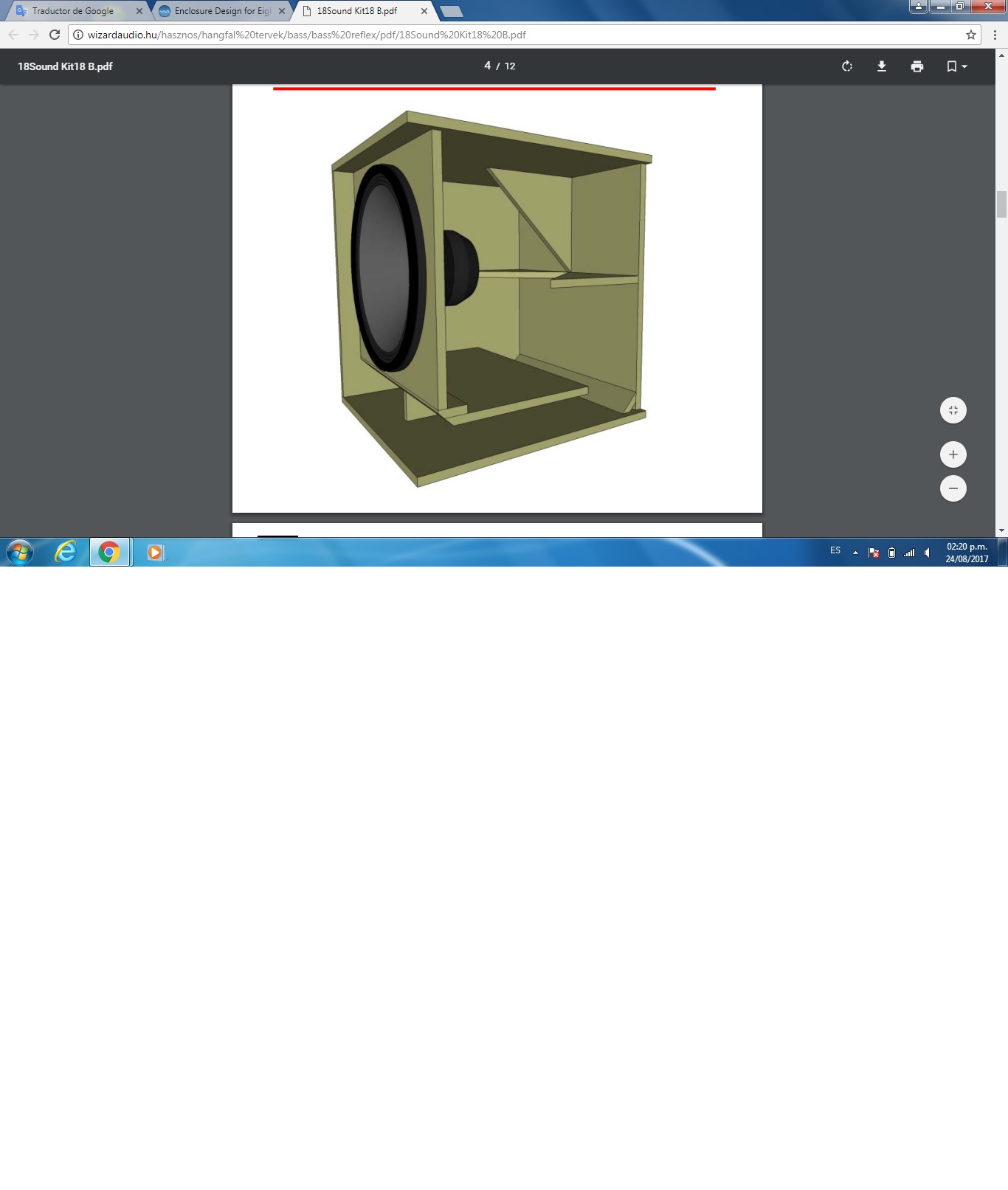

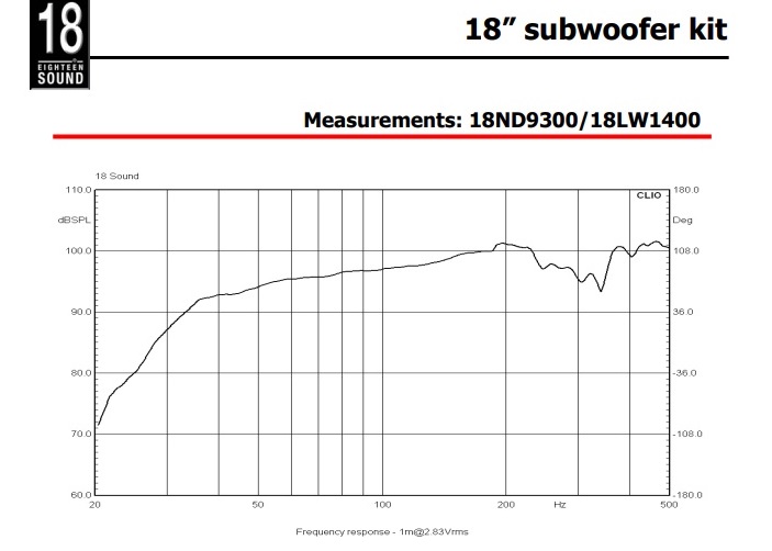

They also serve for 1400 like this design?
http://www.18sound.it/Portals/0/EnclosuresKits/18Sub_v1.pdf
I have not been able to find sealed box plans for 18LW1400...

According to you they are too big and tuned too high for your application [app]. All the design details are in the '.txt' file I uploaded, but you have to have Hornresp loaded to install/view it. I am not setup to draw it with dimensions, bracing, etc., details, just do sims.

Of course your comments are welcome, thank you.

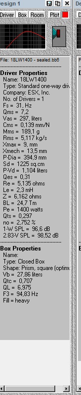

Ops, 😱 Here bespav attached a sealed, is something similar in liters to your cabinet? I see it very small, only 28 liters.

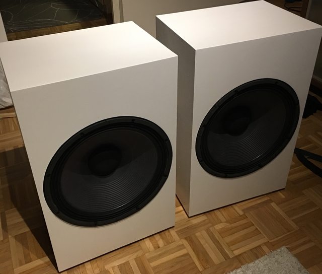

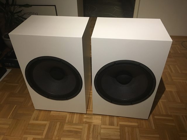

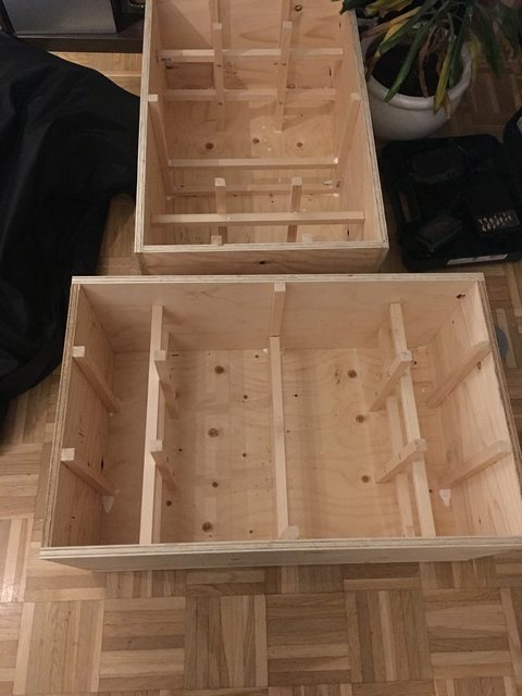

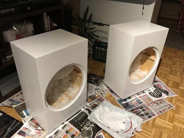

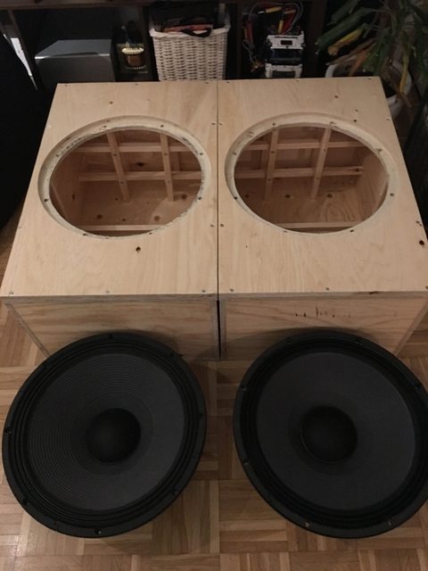

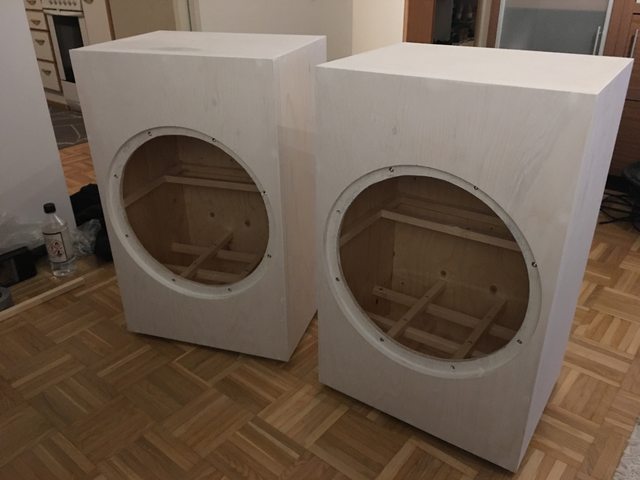

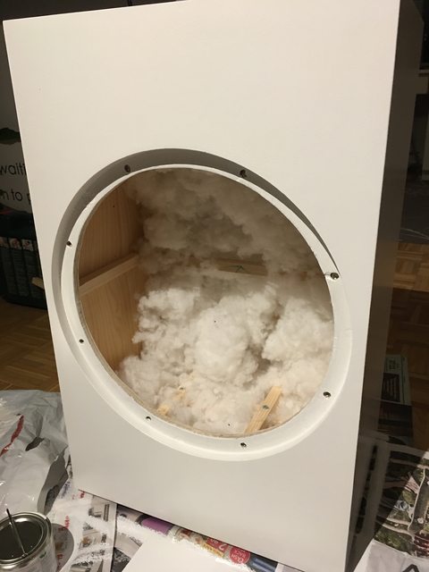

I don't have particular plans for these boxes but here is few pictures of my project.
These are made on 18mm plywood with front panel double thickness. Braces inside are made of 30x30mm bars. Stuffing inside is from Ikea pellows.
I like them very much ! 🙂
No matter that you do not have the plans.
Are 120 liters each or adding the pair of cabinets ? 😕
Very thanks and regards 😉
