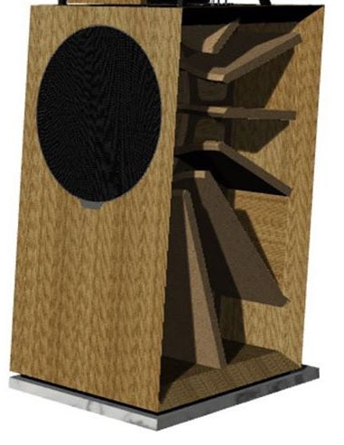

Depends on the frequency. As i suggested in my first post the mid enclosure in the esser Nautilus speakers is a good example. Something shaped like a teardrop.
In the plan view our trapezoid miniOnkens resemble a teardrop and they do have an audiably lower diffraction signature than the rectangular ones or the Classic Golden Rario variations:
And while i am digging out pictures, here is a DM302 cutaway:

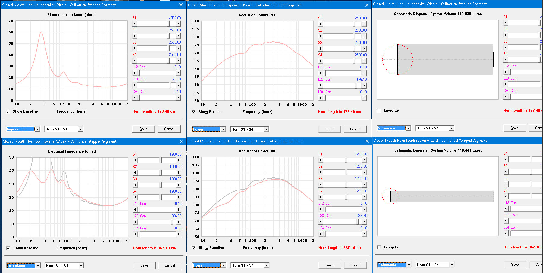

All this convo and not one mention of transmission line, tisk tisk, the study of transmission line enclosures covers resonance, bracing, and its potentials...the “aperiodic” constant CSA TL being the epitome of the box less sound (with a box 😉. I’m not saying to build a TL but rather to see what the constant CSA fully stuffed TL is capable of and use these aspects to tune your own design. For example, the idea that internal bracing can be used to create stiffness as well as raising the resonate notes caused by internal reflections, at the same time. Or the idea that the only way to kill the backwave involves channeling the wave through a line, folded or not, sealed or vented, in unison with heavy damping material....
Somehow I am saying to build TL....a sealed one...and it doesn’t have to be 1/2 wavelength, the length of the sealed TL is somewhat a non issue....or if going vented, figure out how resonant you want it to be, and build something with a decent amount of folds or at least using the knowledge to create your bracing scheme. Damping material supporting your resonance goal.....
Just in case there’s some more learning for me? Did we figure out some other way to kill the backwave....making TL obsolete?
Whereas I would suggest you refer to reliable rather than unreliable sources. Lookup what resonance is in an engineering text book and understand why stiffness is wholly irrelevant to the magnitude of the motion at resonance and why damping determines it. Measurements are few and far between because of the difficulty of separating the sound radiated by the cabinet from that from the drivers but there are some and they are usually informative. But by far the most useful source of understanding is to simulate the motion of the cabinet+drivers and the sound radiated using normal BEM/FEM engineering software. This will quantitatively show you what is going on everywhere and why.Michael5039 - As a fellow aerospace engineer, I recommend you read as much of these old threads as you can, then make up your own mind.
The mechanical design of a cabinet is a straightforward engineering task requiring little more than the application of conventional engineering principles (which obviously need to be known) in order to push down the level of radiated sound below audibility. Little-to-nothing is required in terms of innovation but there are the usual trade-offs in terms cost, complexity, size, weight, etc... On the other hand if a cabinet radiates audible resonances it is unlikely to be strikingly obvious except in the more extreme cases. It is unlikely to be a significant factor in the overall sound quality of any reasonably competent speaker.
Not three, i have mentioned them
And please, you sow half-truths that are misleading. I like TLs, but alignments are not the subject of this thread.
Most TLs (almost none that are intended to do bass) are aperiodic. Most are intended to use th fundamental quarter-wave resonance to augment the bass.
A half-wave line has to support a half-wave. If it is tapered down as it is further away from the driver it can be shorter than a 1/2 wave but it still needs to be the same volume.
