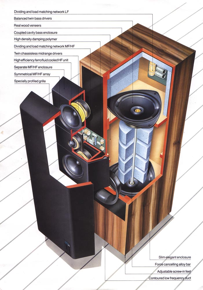

I referred not only to the woofers, the midrange units had magnet assemblies fixed to the back of the enclosure in order to decouple the drivers from the baffle. Smart engineering.
attachment.php
dave
