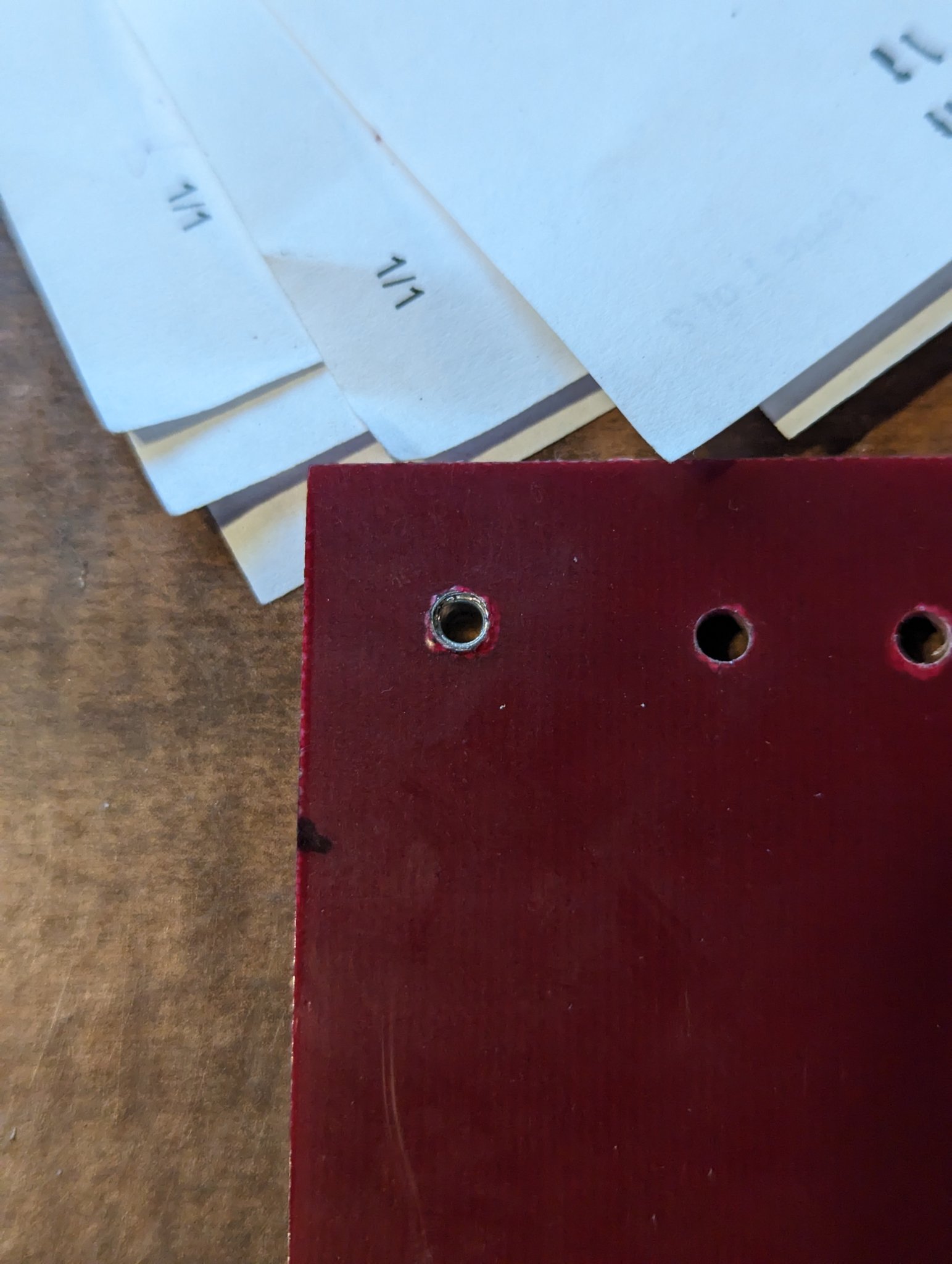

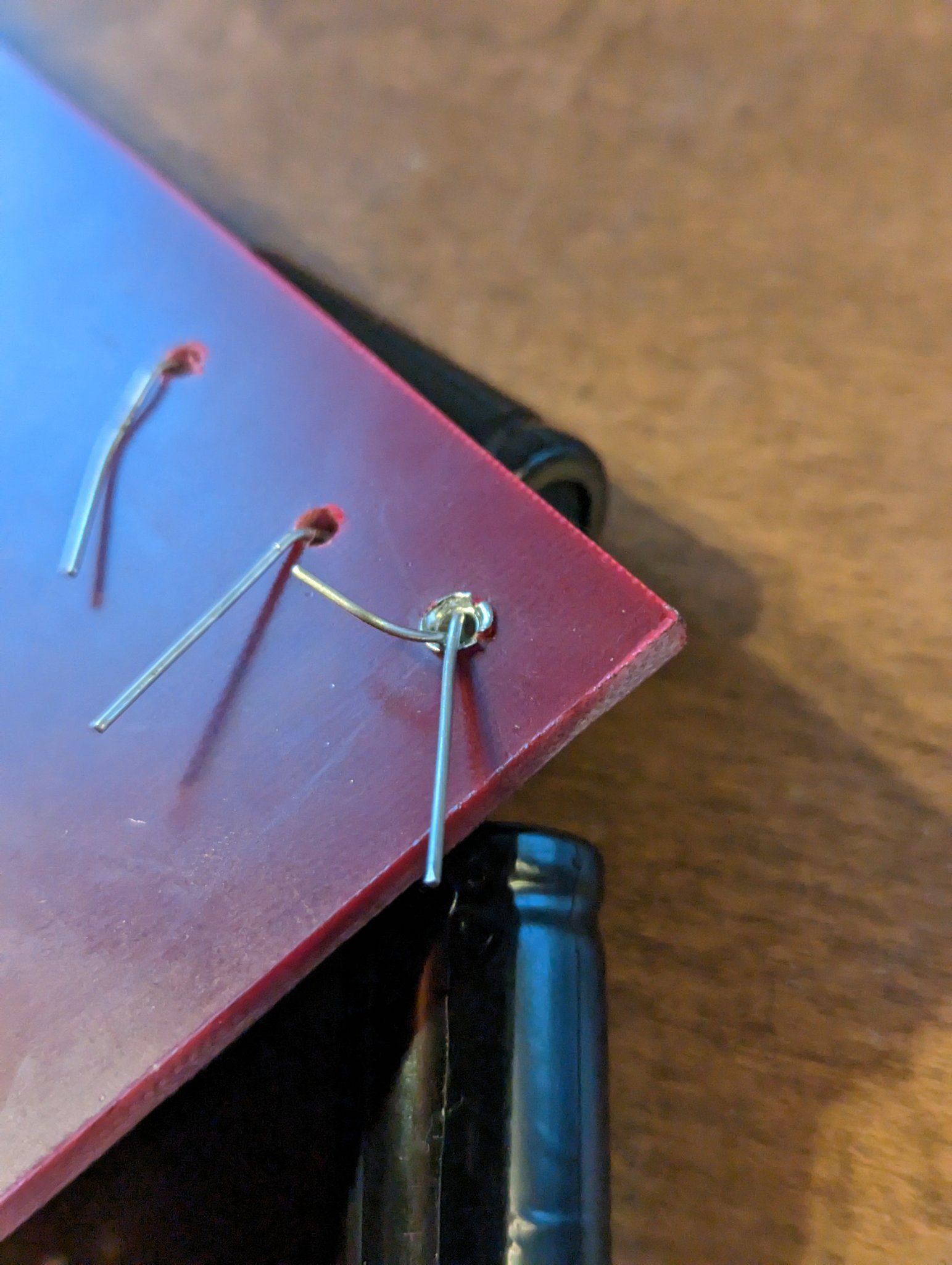

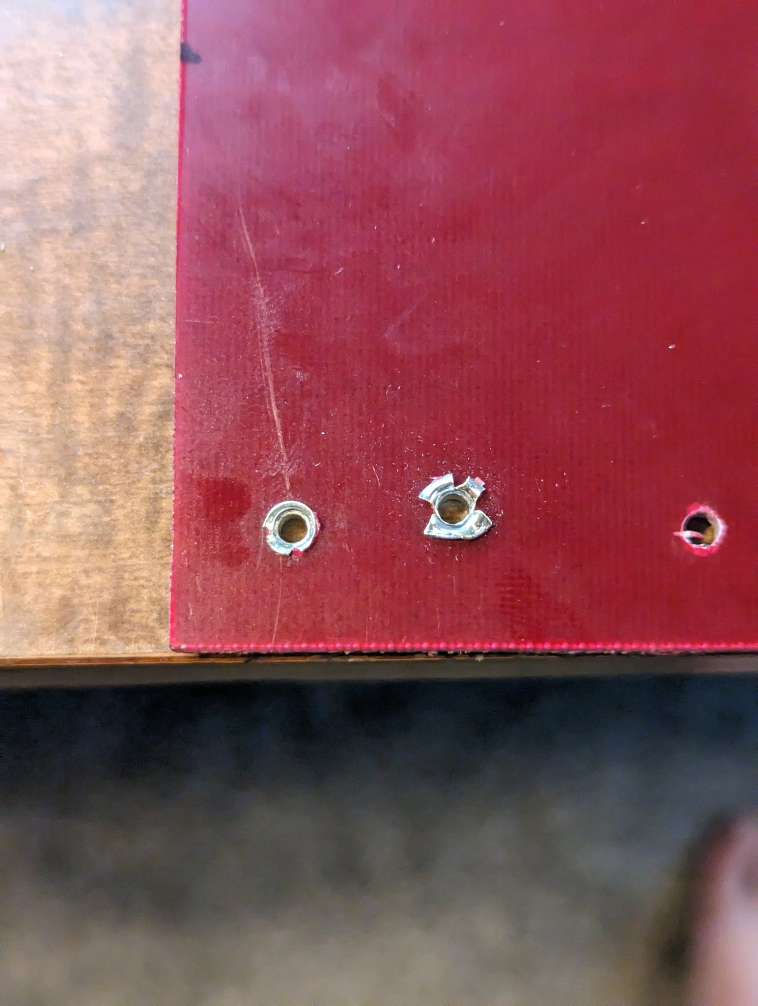

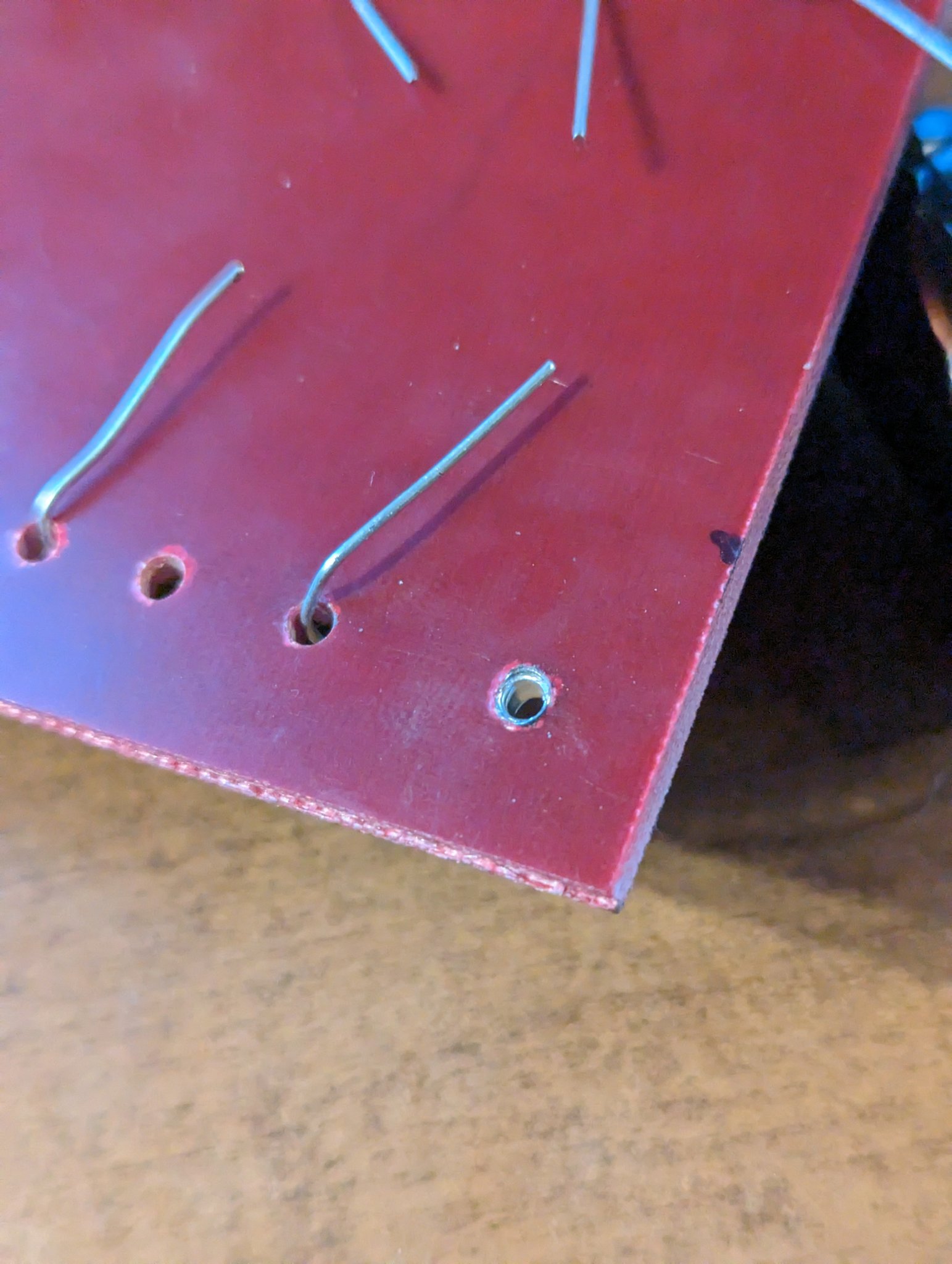

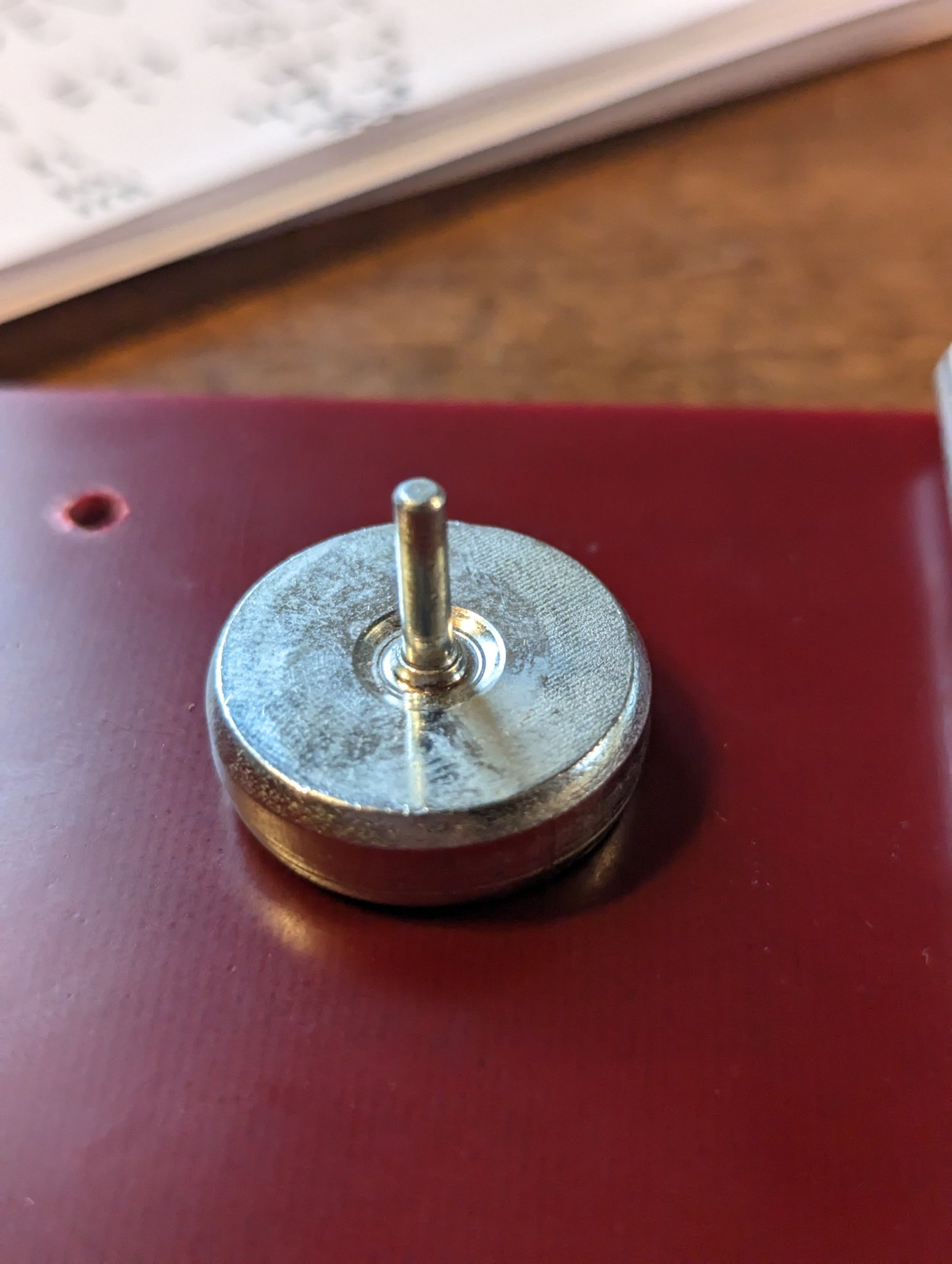

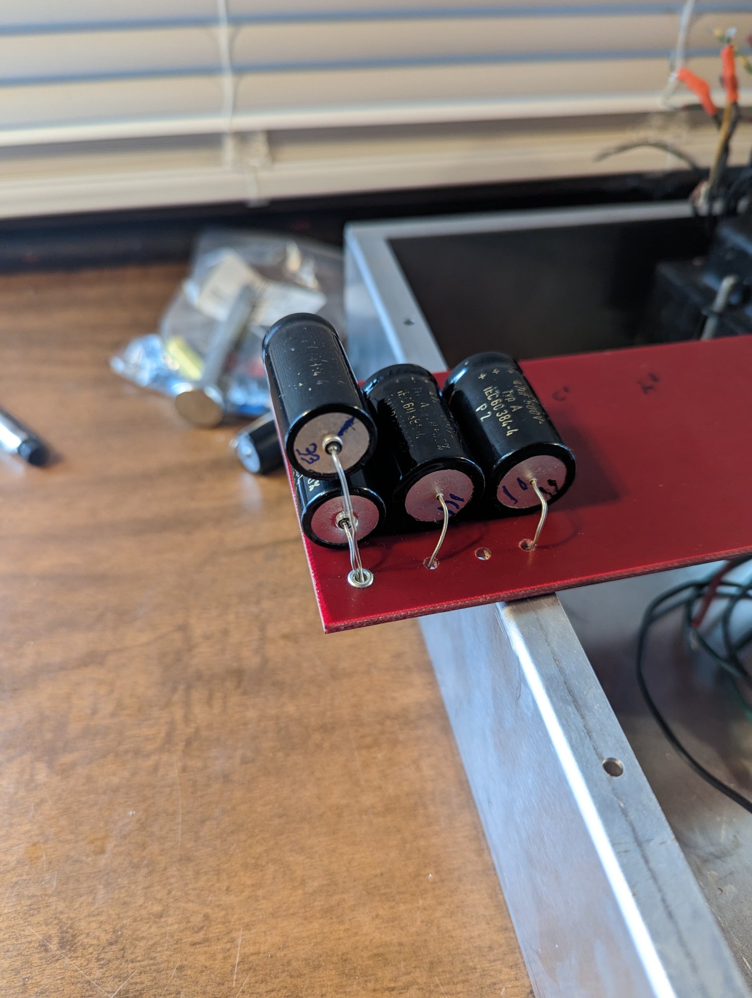

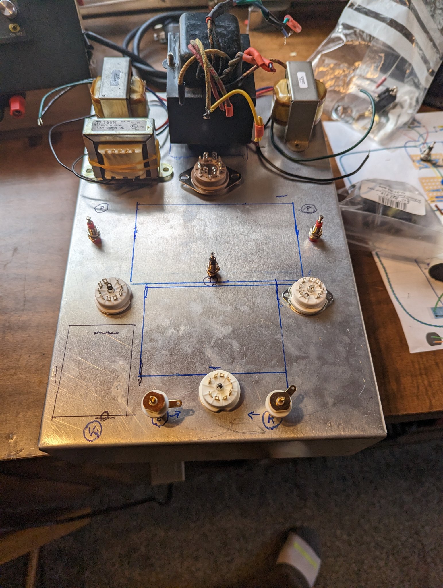

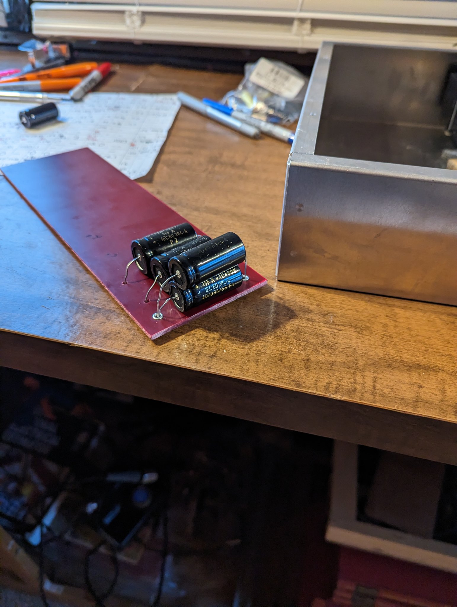

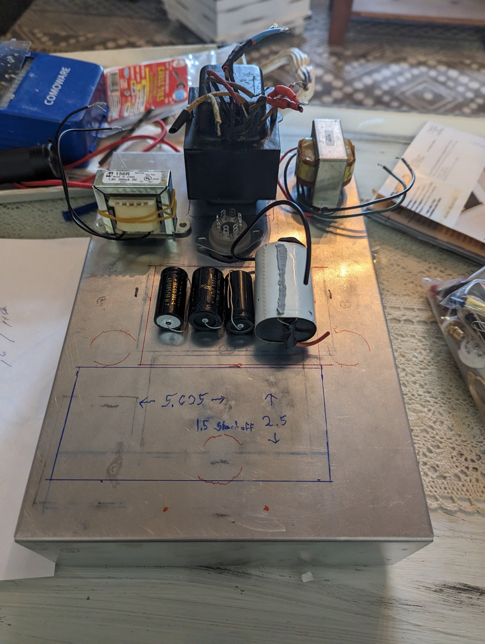

My enclosure dimensions are starting to fill up quickly! I'm measuring clearances in an attempt at a custom turret/eyelet boards for the main components. PXL_20230214_175948343.MP.jpgPXL_20230221_161028199.MP.jpg
I've found a budget path to a fender style eyelet board.

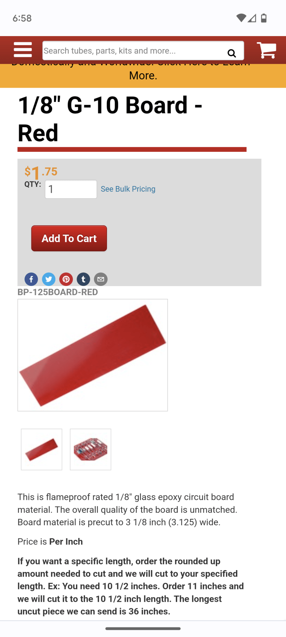

-Red g10 board-tube depot (price per inch)
https://tubedepot.com/products/1-8-g-10-board-red
-keystone electronics eyelets from digikey.
They have different sizes so I ordered a few to try out what works.
Keystone-model #16 and 46. .187 brass tin plated.
I also ordered 15 and 45 unfortunately they aren't long enough at .156.
(the bottom didn't mushroom)
Unlike the 46 & 16.

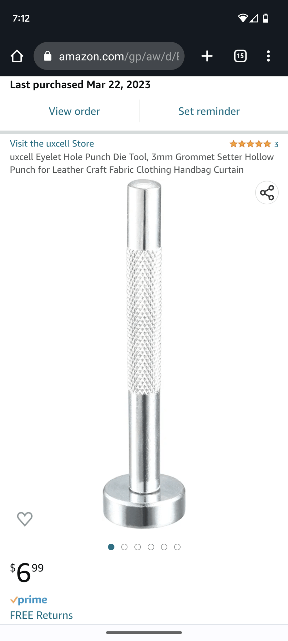

The punch is just a cheapie from amazon
