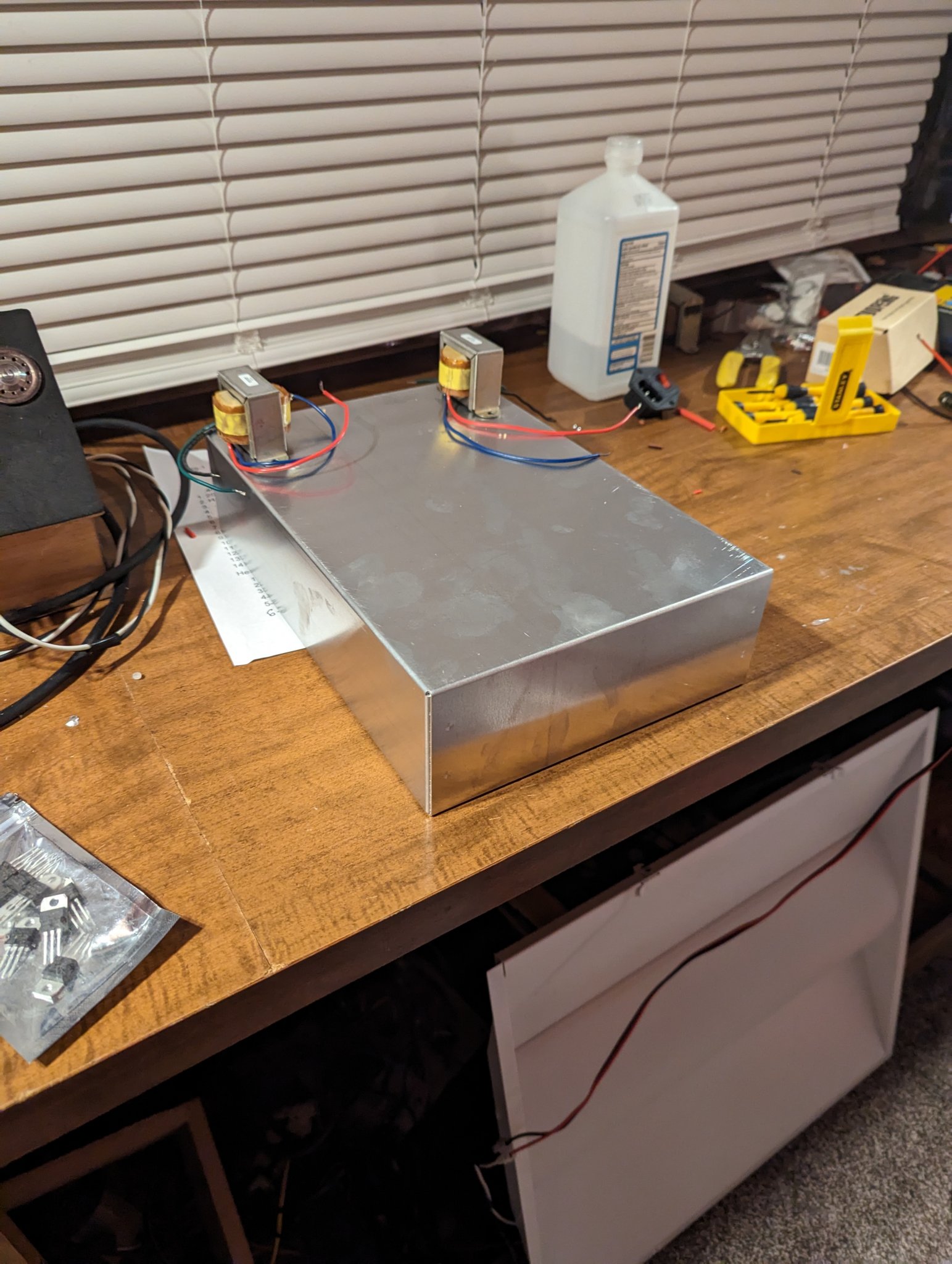

I'm about to start building a single ended amp on a 12x8x3 aluminum enclosure. (I need the space for a beginner) it's going to be point to point and I'd like to learn how to use turret boards for the capacitor bank
I want to do it long ways (inline)with the transformers in the back then the output stage and finally the 12ax7 input at the front.
My questions are..
-What size screws are best?
-Is it ok to mount phenolic terminal strips before each tube and make the connections there before jumping to the tube pins?
-i want to do buss type grounding scheme,but I'm unsure of how to route it with the speaker terminals in the back. Shouldn't it start at the first filter capacitors -output tubes-speakers-then connected to chassis at only the input stage?
-what is used to suspend and isolate the 12-14 gauge bus bar in the air is it goes from stage to stage
-do you clock the tube sockets so that certain pins face each other for short wire lengths?
-can the feedback, zobel circuit and speaker +&- land on a terminal strip. Then from there take 2 wires to the speaker terminals.
-should the feedback wire be a shielded design and what type.
-is it ok to use solid core wire to make neat bends (is pre tinned stranded even better for this?)
-undecided on weither to mount the choke and output transformers on the underside of the chassis.
I know it's a lot of questions and I appreciate any help I can get. I'm right in the middle of ordering supplies and I'm stuck on a few things. scan0001.jpg

Honestly it's way easier to develop good habits by starting in a big enclosure, the margins for a quiet layout are greatly increased. Is that one of the Bud industries boxes or Hammond? My most used size is the 10x8x2.5" Bud industries AC-1418.

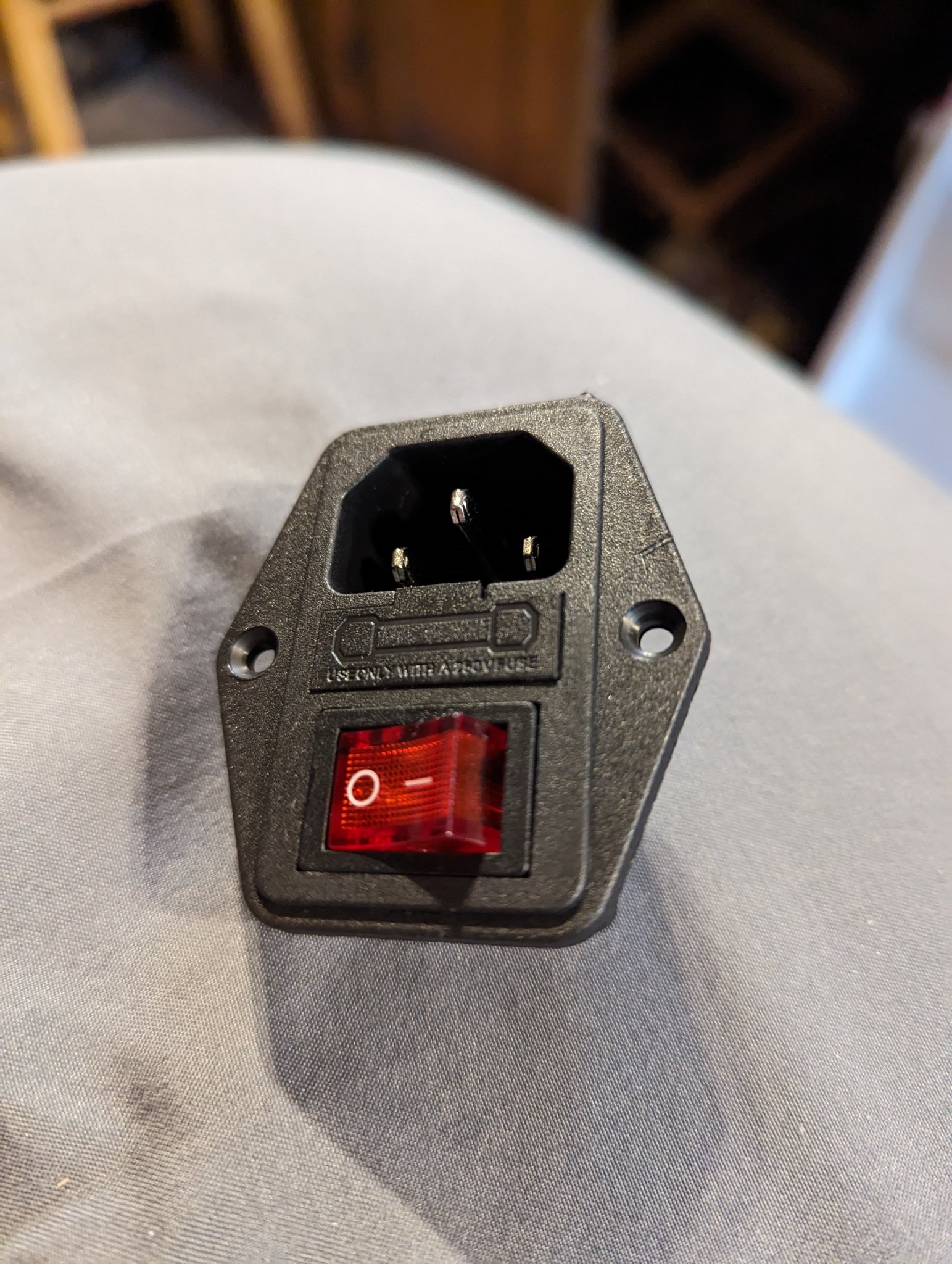

12x8x3 I got it off Amazon for a nice discount. I went with the 3 inch because I have a iec plug for the side with built in fuse and switch. It's kinda tall and it allowed me to keep my primary wires to one side of the enclosure. PXL_20230113_164054418.MP.jpg
