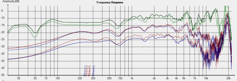

Dave (P10) lent me two matched pairs of EL70s. 1 pair stock. 1 pair enabled. I'll be posting some more details when I get around to it, about listening impressions. It should be noted at this time, that the only differences I could hear, were in the treble range, which is the only region showing a measurable change. I did prefer the enable treble range, however it looks like it measured worse. I measured AFTER I listened.
Stock (spliced at 350hz)
enabled (spliced at 350hz)
Other than a gate NO smoothing was used.
It doesn't appear to me that enable gives better off axis dispersion. This was also confirmed before measurements in my listening session where standing up out of my LP killed off the upper treble range.
EDIT - I'll explain this more in detail later, but the differences between these pairs was more than just enable. Dave gave the enabled pair his full treatment of cone treatment, and a smoothing ring around the magnet where it meets the basket. Dave could offer more insight as to what was done.

...the only differences I could hear, were in the treble range, which is the only region showing a measurable change. I did prefer the enable treble range, however it looks like it measured worse.
Ryan,
Once overlayed differences are not much... within the realm of unit-to-unit variation.
You heard no difference in the soundstage?

Ryan,
dave
Soundstage changes weren't detectable to me between units. You're right, the FR differences are easily within unit variations, and mic placement. As I had to move things around to change between the two.

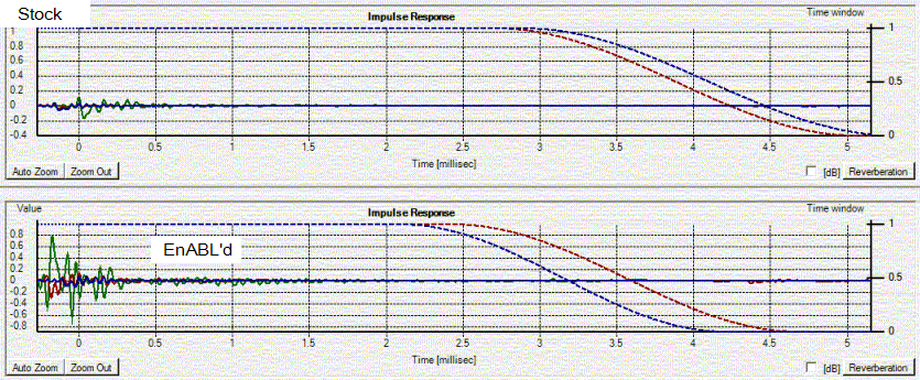

Comparing the impulse response of stock vs EnABL'd is interesting.
Any ideas on why is there such a difference?
Alex
They were measured one after the other. The scales are different. But, still some differences. I'll zoom in better and post some larger screen shots of the impulse when I have some time. Other wise, I can't really explain it. The baseline was a combined nearfield and 1m farfield spliced at 350hz averaged 50hz either side of 350hz. So the impulse looks a little goofy for those. I might have the unspliced impulses saved. I'll take a look when I get the larger impulses.
Where did you place the start of the window? I would expect to see the window on the rise side fairly close to the impulse.
This is not surprising.
Dave
Starts around 3ms. Why near the impulse?
For those interested (I should have taken a picture), the speaker was elevated to 1.2m above the floor in a room with 2.4m ceilings. The speaker was a minimum 1.7m away from the nearest wall. The mic wall measured 1.0m away from the baffle. The mic was measured 1cm from the dust cap in the nearfield test. The floor was dampened with some blankets, although that is more for peace of mind rather than it actually doing anything 😉
HOLMAcoustics resets the start time marker to the beginning of the sampling IIRC. At least it always did with the settings I was using. If you don't set the start time marker to a point close to the actual impulse, then the data includes pre-impulse data that is room background noise which does not represent the response of the driver alone.Starts around 3ms. Why near the impulse?
