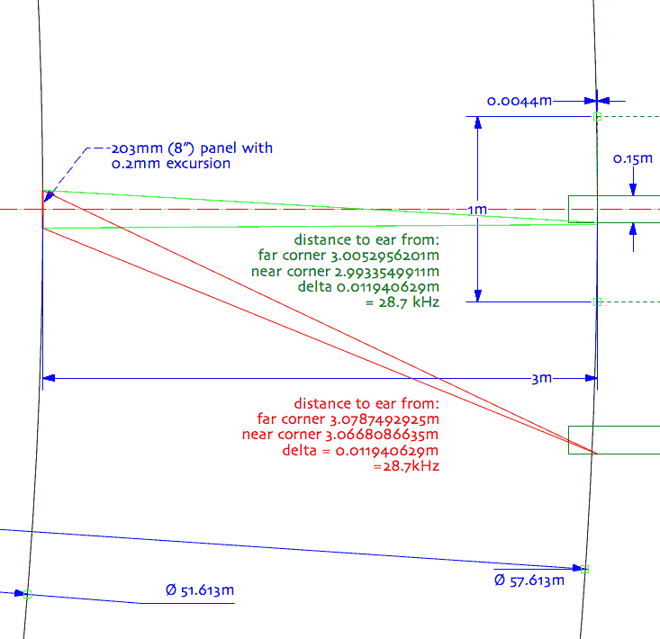

Flat panels are attached for support, usually around the periphery. These attachment points do not move. There is a transition region to central area, movement of the diaphragm is not flat. More significantly, at frequencies with wavelength significantly short in relation to the surface dimensions, the polar response shows a wave that is anything but flat across the spectrum. This is simple geometry based on distance to each radiating point on the surface.
The polar response is not the wavefront.
Now if you want to argue that it does emit a flat wave, then at any listening position other than the extreme far field, that flat wave will create a non-flat response at your ears due to geometry.
Your argument largely ignores the reality of the geometry. There will start to be combing somewhere above 7-10k, if the planar was a perfect picton, with output diminishing towards the clamped sides higher.
Some details:
1/ flat panel with 0.2mm excursion and 8" (203.2mm wide -- about the size of an acoustat panel). 0.2mm is a lot and except at loud volumes in the bass likely orders of magnitude larger than normally encountered.
2/ 3m listening distance. I never got that close to mine.
3/ average adult distance between ears of 150mm
4/ on axis analysis (mono)
5/ off axis analysis (2.5m separation of stereo pair)
6/ CAD program dimensional readout turned up to as high a precision as allowed.
dave
Actually, it is. When considering polar response of a panel and a wavefront, it is 3-dimensional, not 2-dimensional. The horizontal polar response does not come close to characterizing it. You would have to show the results of the full front hemisphere, the complete polar response, to do that.
I think that you would have to something similar to what Geddes is doing in his efforts to impute the response at the source by measuring a large number of points at a distance and do so on a plane in front of the panel system.
I had a ribbon, Apogee Centaur Majors. One single ribbon over a 10" woofer, not the full-range ribbons, it was a very narrow single ribbon. Extremely sensitive to tiltback due to the ribbon, even a few degreess unless one was at an extreme distance. The need to listen at a far distance simply reinforces my point. From what I recall, all Martin-Logans use curved panels. At least those that I recall seeing did. From what I see now on their web page, that is still the case. That alone would eliminate any possibility of those having a flat wavefront. Acoustats are closer to flat wave initially if they are perfectly uniform displacement (I'm not convinced of that, either), but the height of these requires little or a very specific limited range of tilt, just as my ribbon did. You still must listen at significant distance and within some limited vertical range. That "flat" wavefront does not sound the same at the extreme end vs. the center.
But again, this is still diverting the issue. No one here is adding Enabl to the moving diaphragm of a panel and I doubt that anyone in their right mind would do so.
I'm looking for responses related to the claims made to driver diaphragms actually modified and in this case, those have all been dynamic drivers exclusively. These are the ones on which essentially all claims have been based.
Dave
