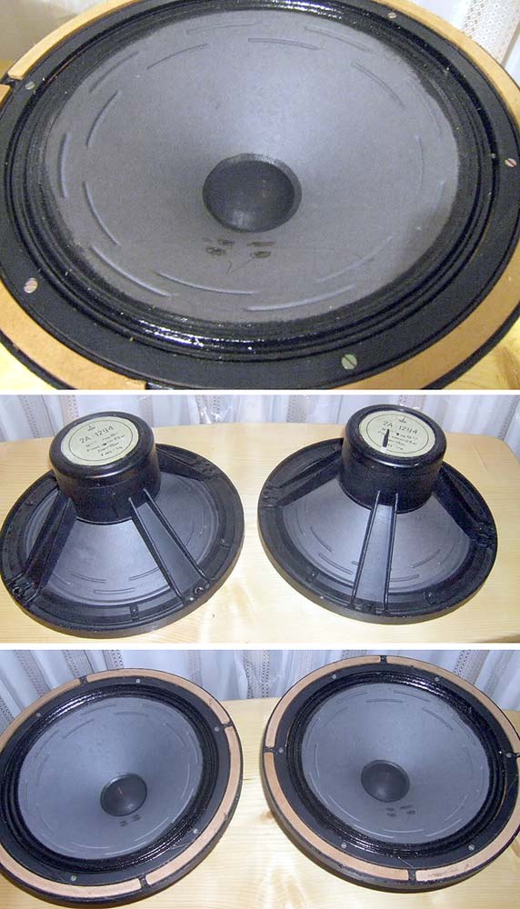

Those have been mentioned before... they deserve to be permantly attached to this thread, the eBay auction will disappear.
dave
