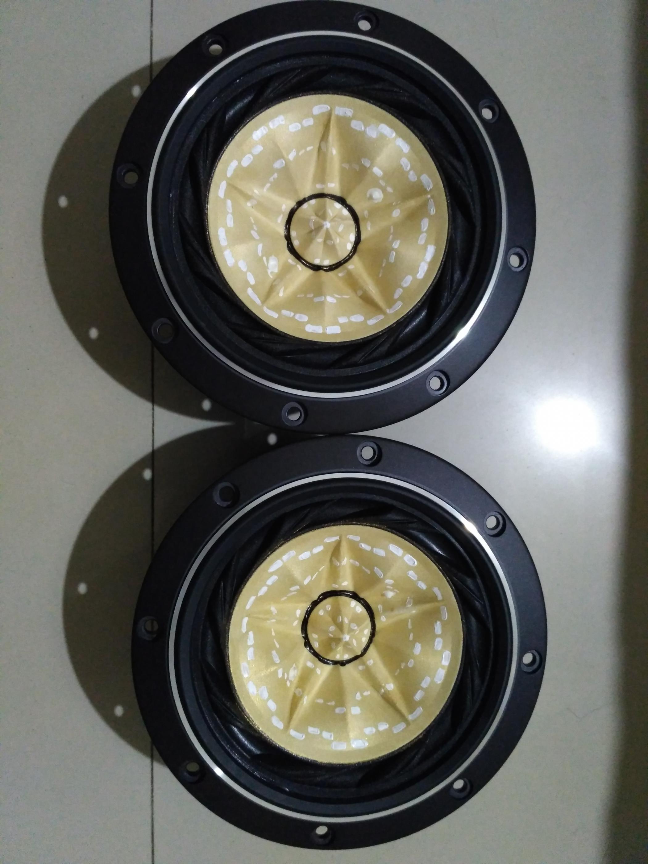

Thank you Bud, for your response. I have done the 'tap test' on the Fostex drivers.
Found ringing in these 3 areas:- (1) Right around the circumference where the conical structures are the widest. (2) A concentric circle around the middle of the driver cone and (3) close to the dust cap where the smaller conical structures are the widest.
This means, like most other drivers three sets of EnABL rings are needed. The dust cap/phase plug would also need a pattern.
The difference from other drivers, I think would work best is to divide the circle into 20 divisions, instead of the usual 18. This would treat the contoured surface more equally and evenly.
The diameter of the largest ring would be 3.75" (at the edge of the cone near the surround) and the smallest would be 1.5"; the diameter of the base of the phase plug is 1.25'.
The larger of the middle rings would be 2.5" diameter.
Bud, do you think that my assessment is alright? If you concur, I would be grateful if you can provide me with a pattern set.

Hi Samuel,
I cannot judge your placement for rings from the picture and your meaurements as I have no idea what size the driver is. I can sort of guess.
I would expect to place a ring set on the flat just past the cone surface deformation and another, a triple ring set, at the dust cap / cone joint. This would follow a gen 1 patterns locations. Pulling a tap test on this driver has me concerned. When you found the points of ringing, where on the convolutions were you taping? Were you out on the large open area or on the sharp spine?
If you could provide another picture with a ruler laid across the cone with the edge just at the half way point this would help.
I don't actually have a way to change the pattern divisions without rewriting the Auto Cad lisp program that generated the original pattern sets for Gen 1 applications. I wrote that thing about 30 years ago and haven't looked at writing programs since.

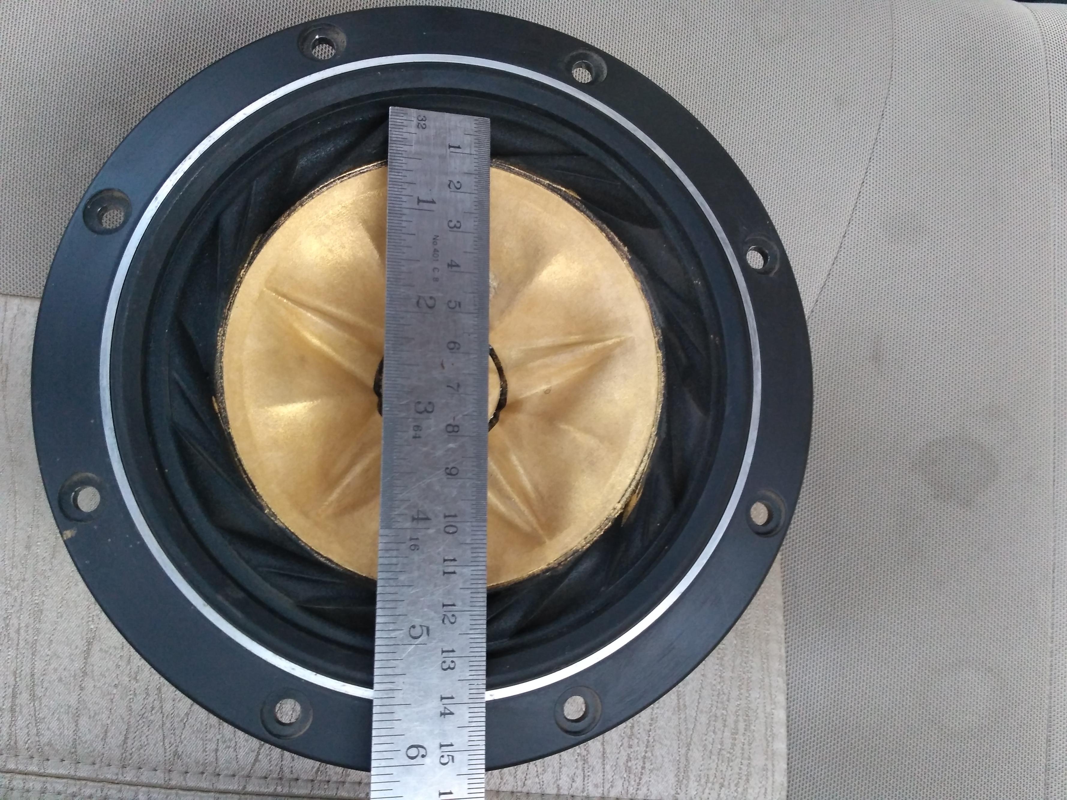

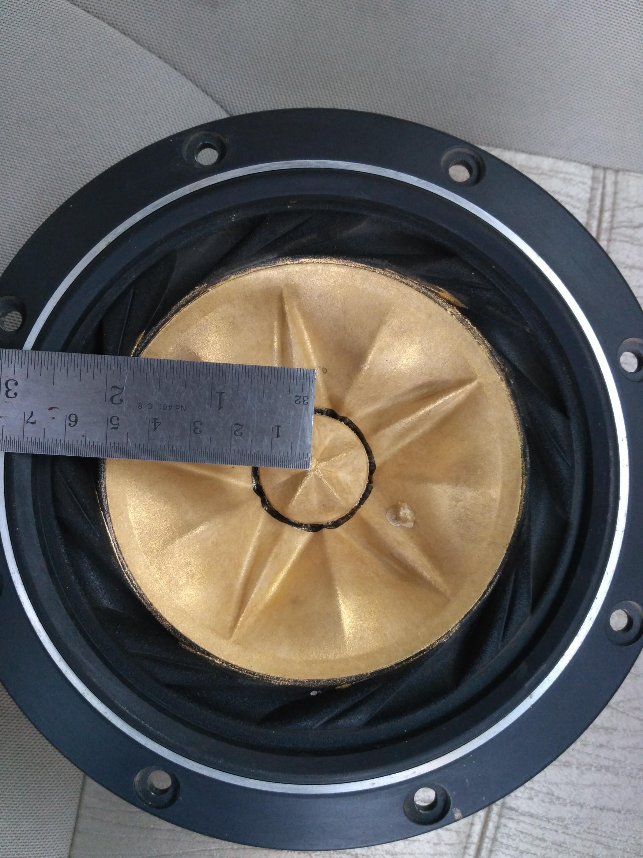

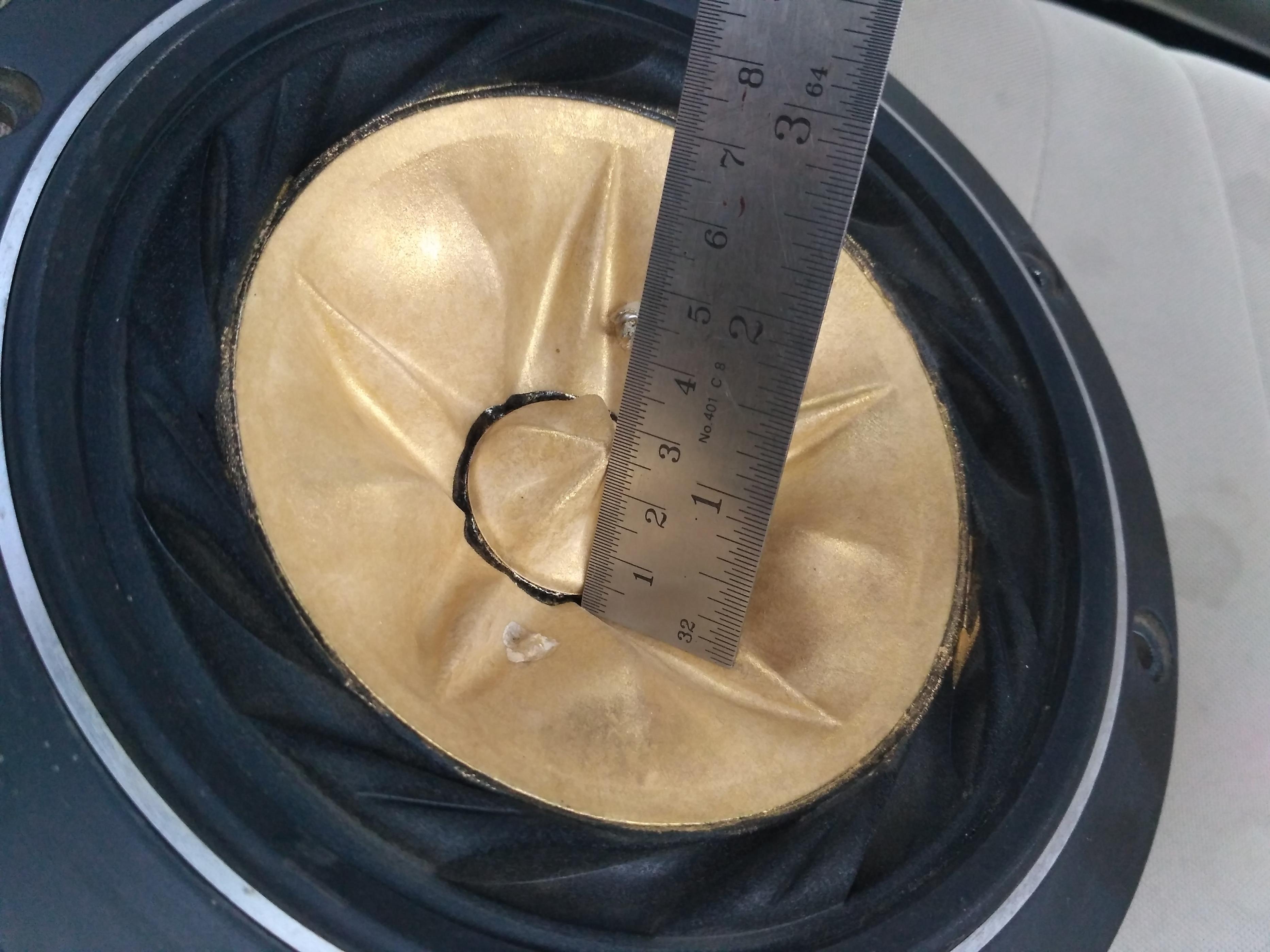

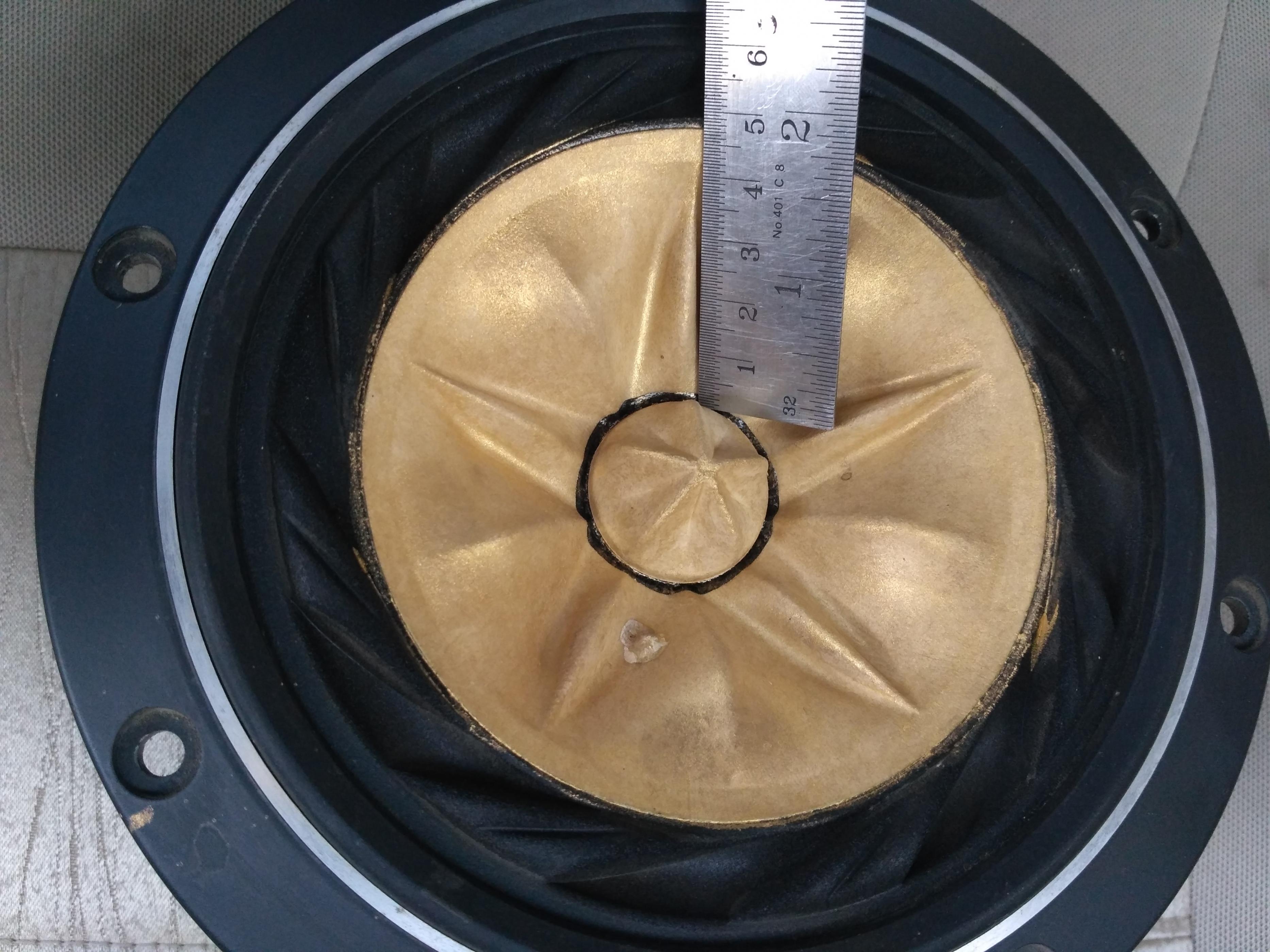

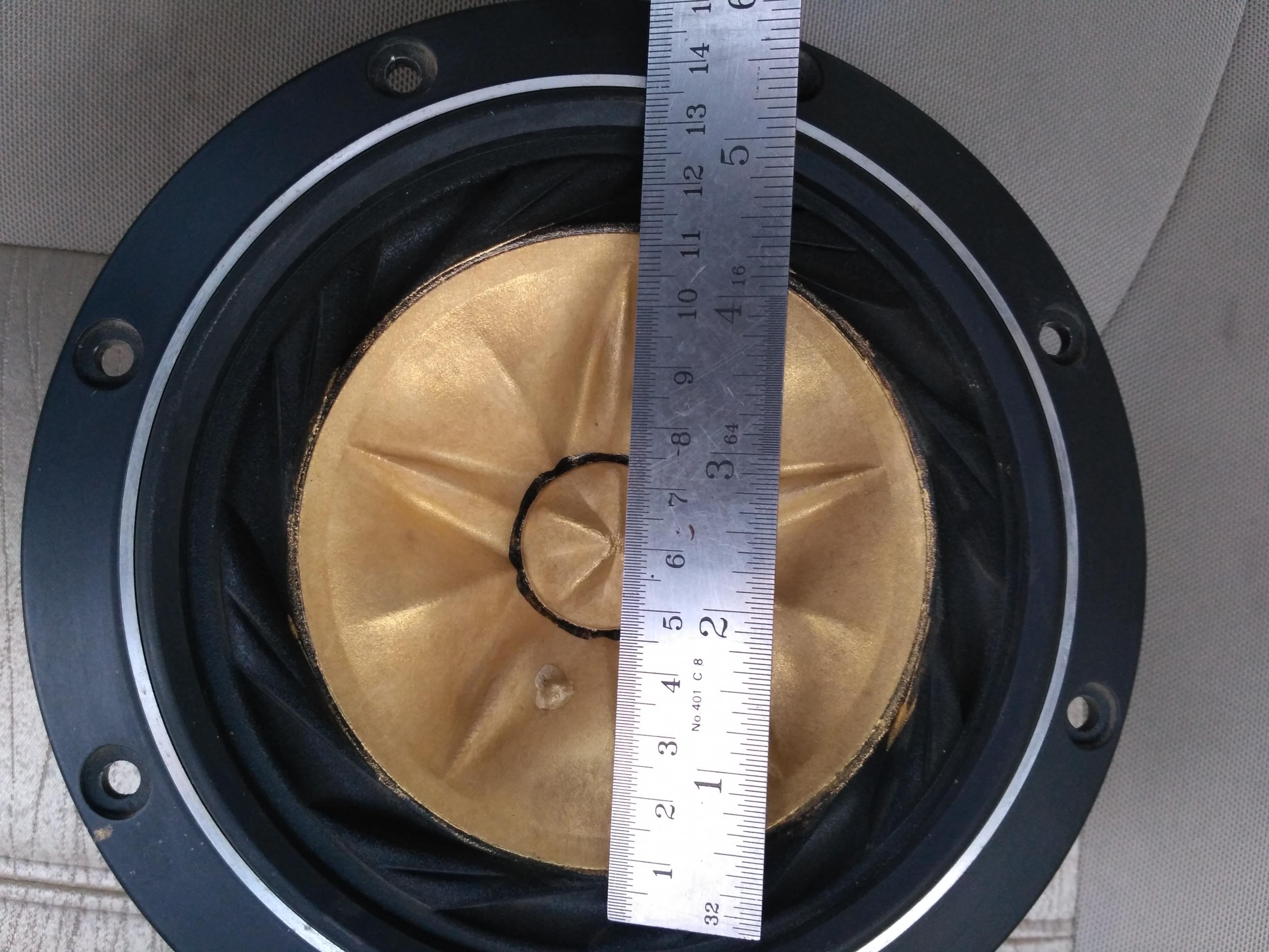

Bud, thanks again for your response.
I found most ringing in the large open areas of the big and small contours. I did not tap directly on the spine(s), but I heard an increasingly damped sound as I neared the spines.
I would deeply appreciate if you could point me to the differences between Gen I and II patterns.
If possible to help with patterns, perhaps the attached pictures might help. Even otherwise, they should help for more informed advice.
Thank you.

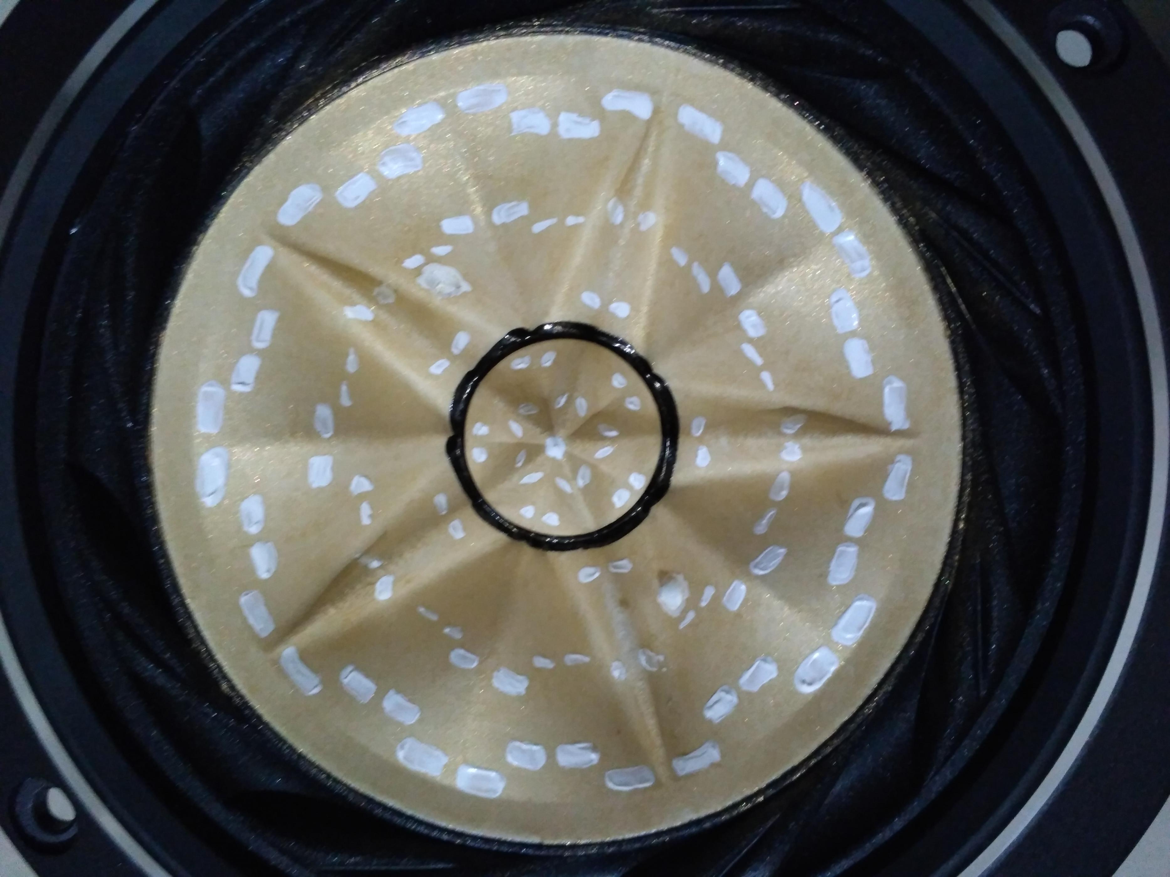

Thanks once again Bud, for your guidance and encouragement. Though not very accurate, but with no pattern, stencil or guide, I went by my own judgement and applied the EnABL rectangles by free hand. I think they are pretty ok. These are a pair of brand new Fostex FE168Sigmas. One more conformal coating is to be done. I plan to listen to these before starting on the old pair I have. Here are a couple of pictures to show the outcome thus far.
Hi Sam,
Sorry to not have been much help here. Illness has once again taken it's toll and with Dave in even more difficulty,
neither of us could come to your rescue. However, I have no argument with what you have done. I might suggest taping radially on the open surfaces just to see if the actual pattern of ringing follows a perfect circle or if it has a shape specific to the open area, one more conformal to each area.
Bud
