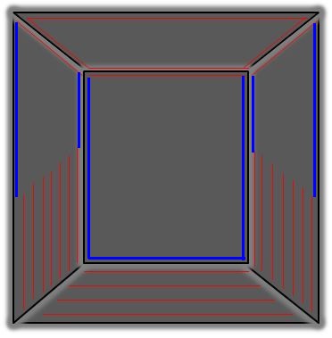

OK, so for the inside, this covers the bottom and 2 sides. This leaves the top, the back and the front. I cannot do anything to the front because there's no space to manoeuvre and you're saying that for the top and the back, I treat only the complete perimeter right?
Also, what should the height/width of the red colored area [the distance between blocks and the cabinet inner edges] be in the attached pic?
Yes treat the edges only of the top panel and the top edges of the back and side panels.
One block height i.e. 2.5mm for your cabinets.
Great questions. Please ask more questions as needed.
Alex

In the attached pic, on the inside of each surface I've marked areas in red where the pattern has to be run. Can you please check if I've understood correctly?

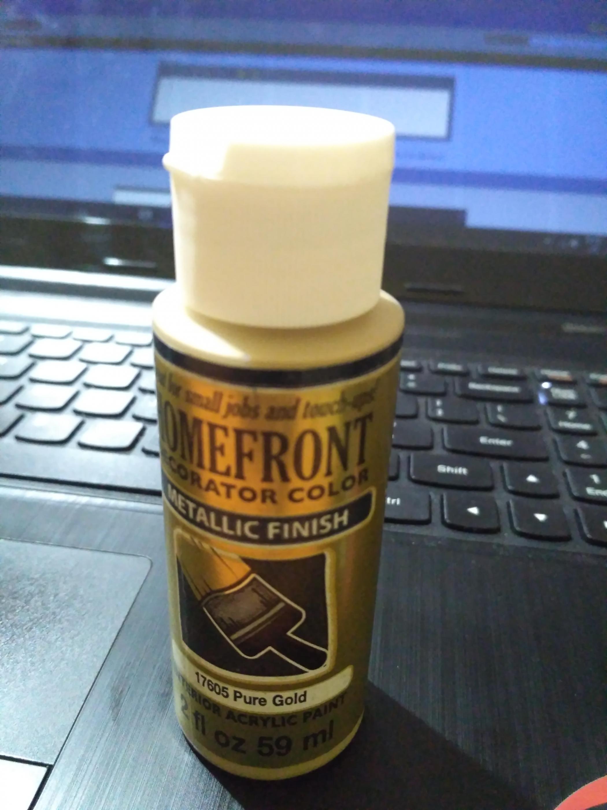

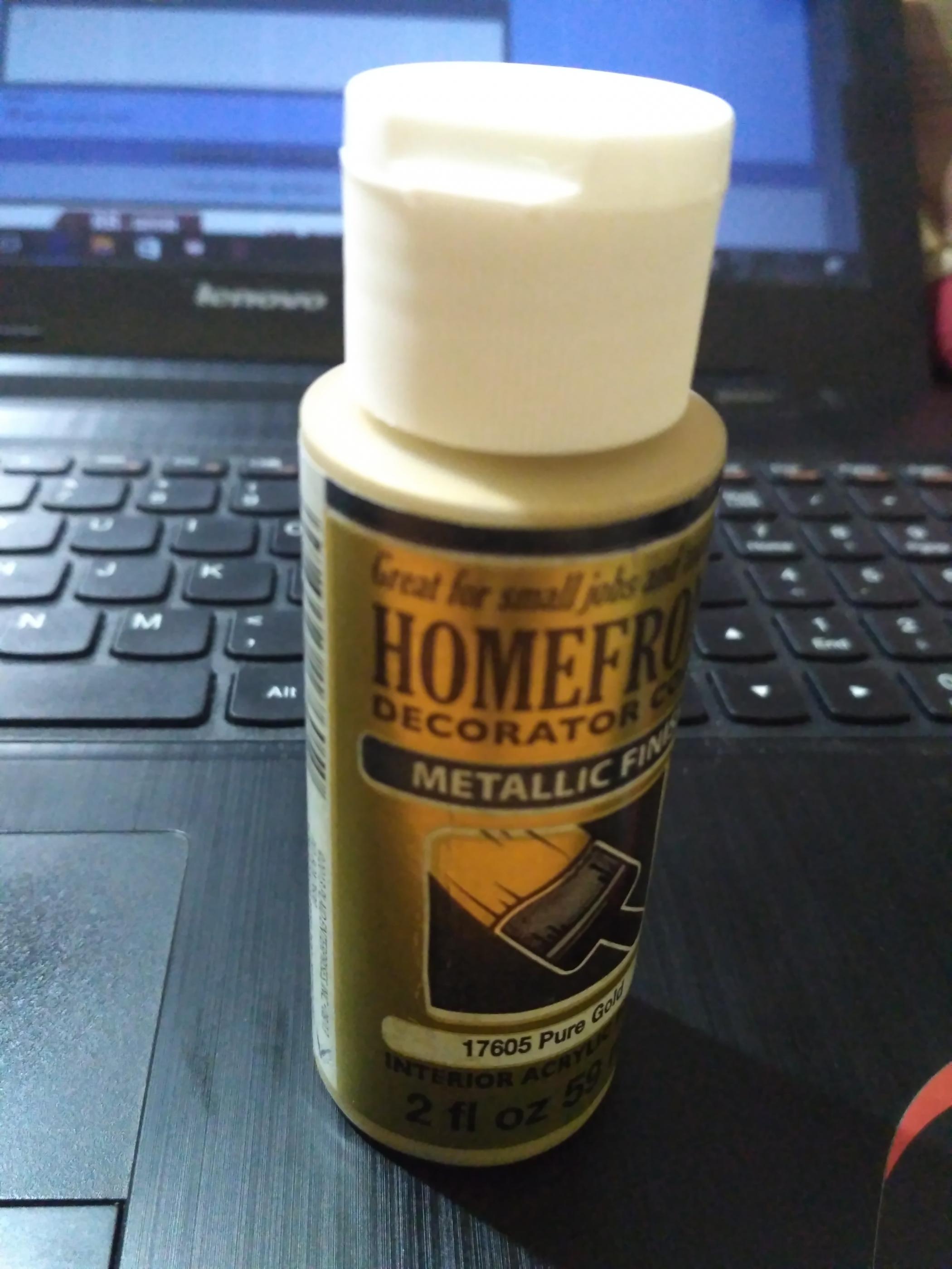

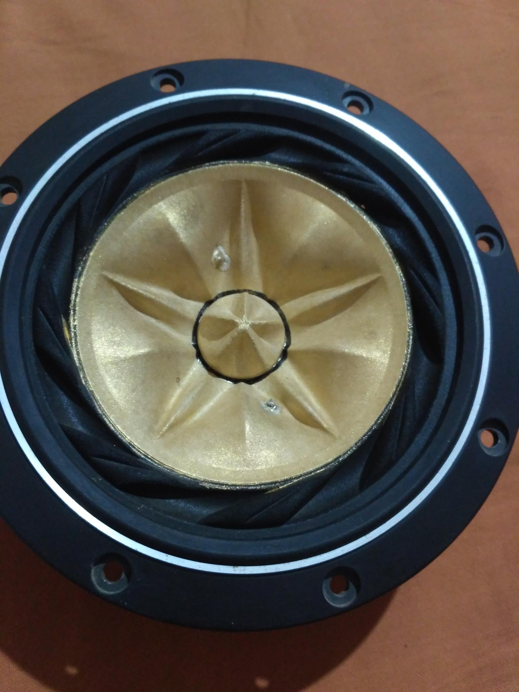

I have applied a coat of a Water based Acryl which I was able to locate in Kuala Lumpur from a recent visit there. MicroGloss is not available anywhere within my reach.
The attached picture shows the treated speaker and the Acryl container. I applied a first coat as my speakers were getting affected by fungus.
I would be very grateful if anyone could provide me with a EnABL Pattern set for the Fostex FE168Sigmas.
Thanks in advance.
