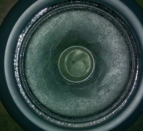

Attached is a picture of what the front driver now looks like. I have some questions:
1. I have not coated the dust-cap. Would there be any benefit in coating this?
2. I have downloaded the generic EnABL pattern pdf drawn up by Dave. If I want to apply this pattern, where should the outer line of blocks start? At A or B marked in the attached picture?
3. I'm in India so the closest to the Floquil paint I have found here is this which I think should be OK. What do you guys think?
4. I had some of the acrylic paint lying around so to test it, I first used it straight off the bottle. Dipped an old fountain pen nib in it to draw a block on brown paper. The paint had a thick consistency but applying it into a block was not too difficult and it formed a skin quickly. I then diluted it with 50:50 ratio of water to paint and tried it. Was too dilute but I noticed that if I drew an outline of a block and then dropped a small drop of this dilution inside the block it would spread nicely within the outline. But, when this dried, the block didn't form a "bump" like with the undiluted paint. How critical is the "bump"? Should I be even diluting the paint in the first place? Should I dilute it with a lesser percentage of water?
5. I read that after the blocks are applied, a coat of Microglass needs to be applied. I have no clue what Microgloss is so can someone point me to a link describing this or if any of you know, can you let me know what it is made of? I will have to see if I will be able to source an equivalent here in India. If not, do you think I should go ahead with just the EnABL blocks sans the final coat of Microgloss?

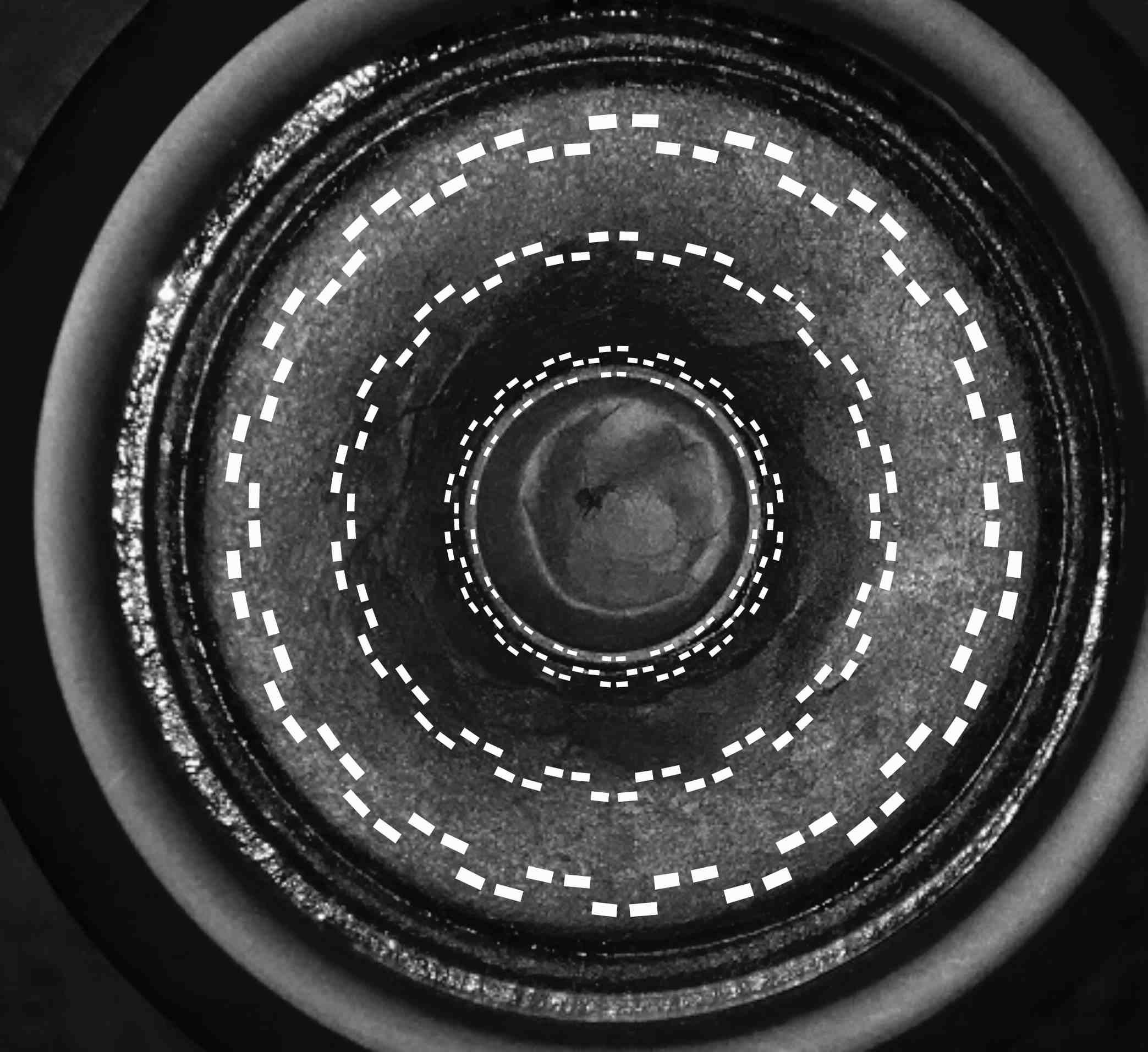

Had the time, so here is the first pic. Use it to tap test the driver to make certain you hear a change in decay direction of the tap, for the mid dome ring set. The others are generic, would be there regardless of gen 1 or 2. Gen 2 would likely have another ring set out on the cone, closer to the outer edge rather than in the mid point. Again a tap test will pin point that location.

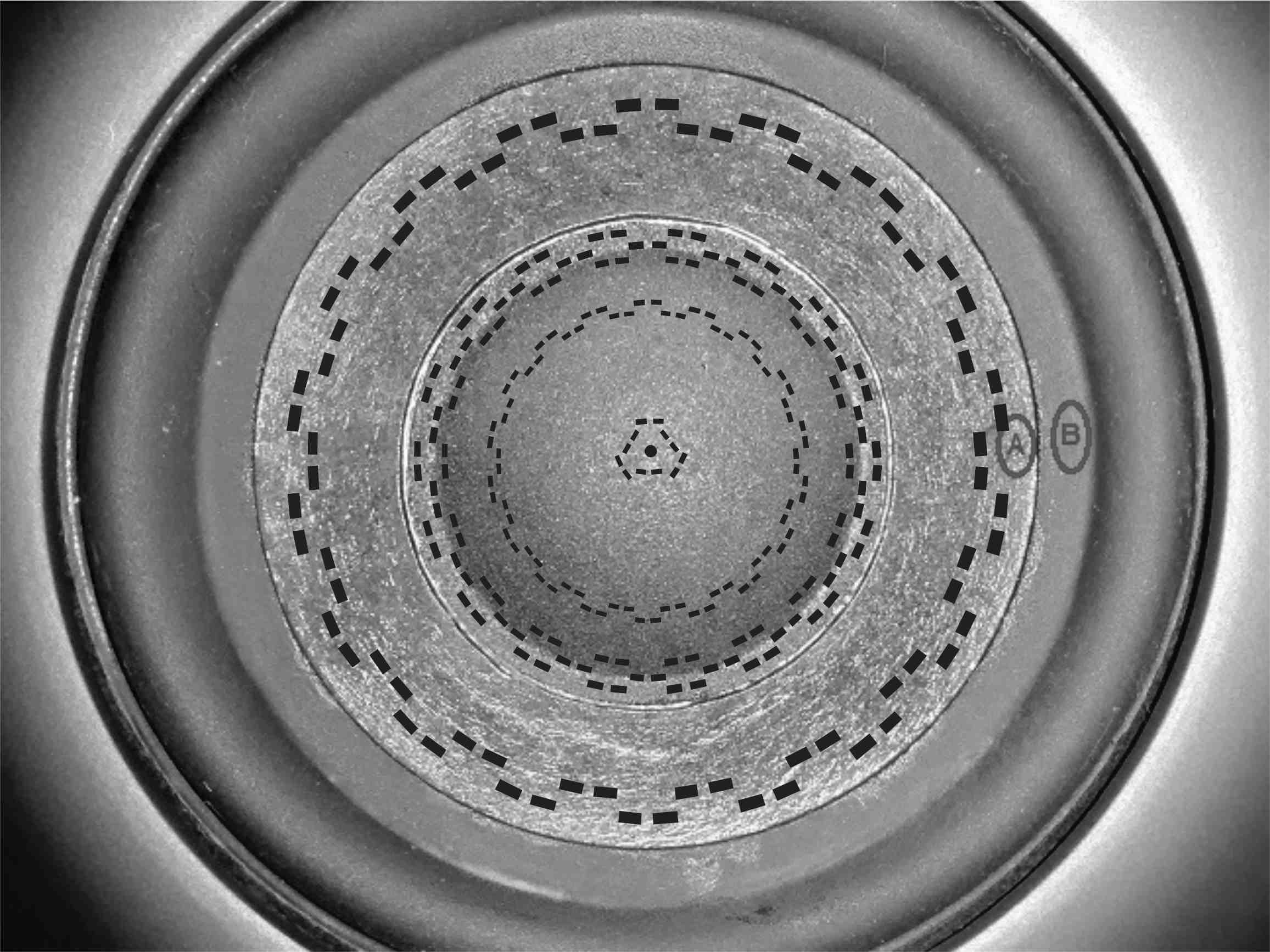

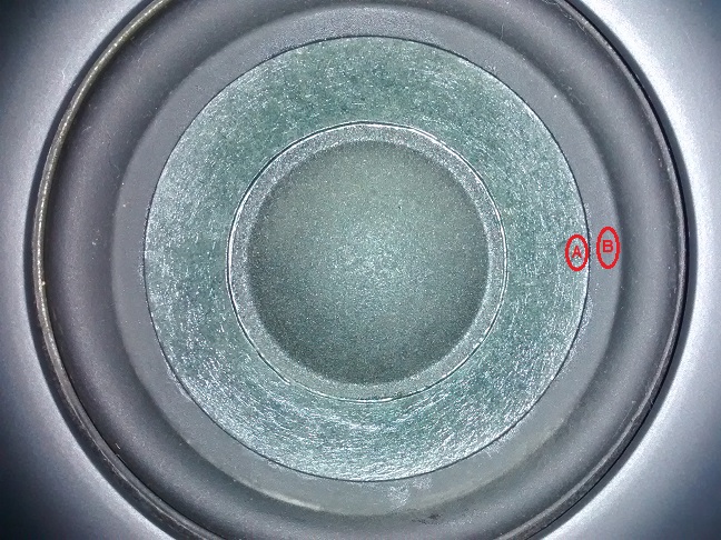

If you can take another picture like the woofer pic , one of the tweeter, I can show you where to put the patterns for it too
Thanks, Bud. If you can provide answers to some of my other questions (below), I'd appreciate it:
I have not coated the dust-cap. I'm assuming that the EnABL treatment needs to be done after coating the dust cap. Is this assumption correct?
The acrylic paint used to draw the blocks - should ii be used straight off the bottle or is it to be diluted with water? If diluted, by how much?
I will post a picture of the paper cone tweeter today. I'm assuming that this cone will need to be coated too before EnABL'ing it, correct?
I noticed this earlier if it helps..
Don't
Put Gloss on ANY driver and not also place the patterns on it. Instead you can use PVA only to coat the cone, dust cap and foam surround and end up with a much better sounding driver than one that has only gloss on it.
Thank you Allen. I guess that means I have to coat the dust cap too.I noticed this earlier if it helps..
Do not coat the dust cap until the patterns have been applied. Don't coat it with the modge podge / elmers white glue / PVA material in any case. Once the outer rings on the cone and dome rings are in place and everything has cured for 48 hours, you can then make some judgements about higher than piston produced frequencies. The outer cone ring provides a return to phase normal for higher frequencies and while I doubt this driver is used above 2 kHz it's still going to have output above the nominal cross over frequency, as cross overs only cut the signal by about 40 dB.
Don't dilute the acrylic paint that you make the EnABL pattern with. You want that 0.002 high bump.. Not because it is a bump, but because it provides variable stiffness to the spot on the cone that transverse waves rise from as they bounce around within the diaphragm, until they are fully damped.

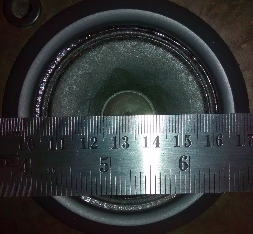

If you post the pictures with and without a ruler laid across the top of the basket, centered, with the measurement edge just above the cone center point, I can make up the ring set guides that will allow you to apply the patterns in the correct places. I use the same tools for generating the PDF you can print out and cut the pattern guides from. Drop them onto the cone, center and apply the pattern just above the guide.

For the tweeter do not coat it with anything until all of the patterns have been applied. The mid cone pattern might well move out larger in diameter or might not be needed, so leave it till last and listen carefully to the tweeters in that condition.
Then, probably, a 10 to 30% gloss to distilled water coat on the cone only, but not in a soaking coat, rather in a one side well drained brush load. If there is still beaming from high frequencies you may need another ring, on the center dome and a spot in the center of that dome. I doubt you will want more than a 10% gloss to distilled water mixture on the center dome and that not applied as a soaking coat but as almost a dry brush application.
So, these things go together in layers of application with listening for phase coherence, even dispersion of higher than 4 kHz frequencies and perceived sound field.
