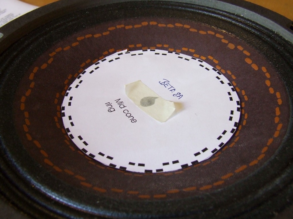

I have attached the pattern guide. Do pay attention to the need for applying an acrylic damping (post it note) type of glue to the back side of the cone, between the mid cone ring and the outer cone ring. The Beta 8 has a very brash Raleigh wave out there and until you get it sorted they will be over dynamic and bright. Once settled they are extremely clear , dynamic and if you have enough power, VERY LOUD!!!!!!!!

Question for you Bud, if I may: with the Beta and Delta pattern rings - should I use the complete Delta set for the front and the Beta rear ring on top of that? The main difference appears to be the inner dome ring, which is smaller on the Delta patterns.
The other thing I want to know is why a couple of the patterns have a space / ring around them - is that meant to be there or just an artefact of drawing them up? Or is it to illustrate how set in from an edge the patterns will be when painted?
Do I simply print with no page scaling or margins (as I've done), cut out, and paint around the outside edge of each pattern ring?
Sorry for the questions, just not sure how best to use these nice pattern sets that I've printed and cut out.

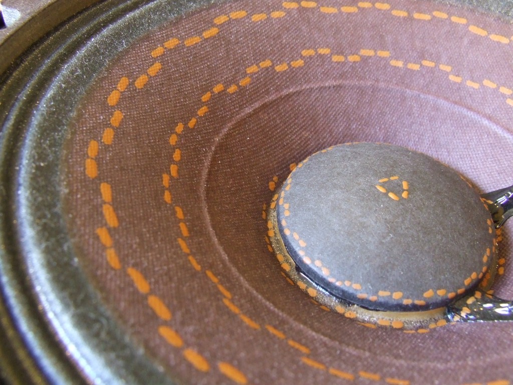

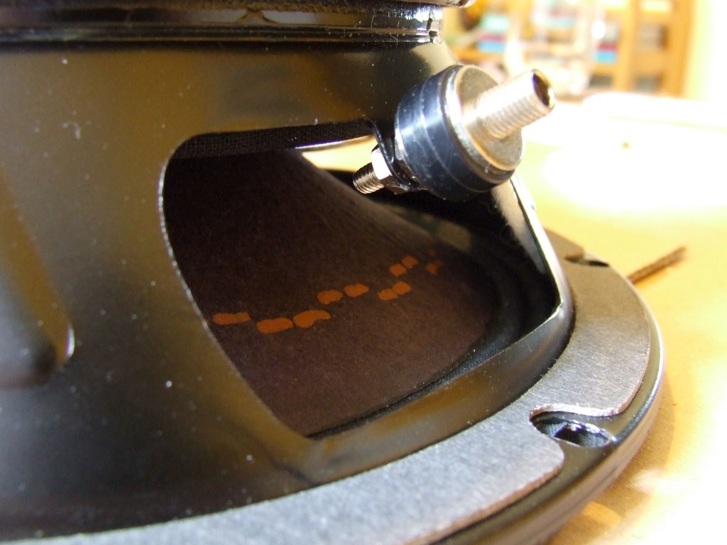

I went ahead and did some patterns. I'm listening now and I'd say the sound has improved but, just as you said Bud, the emphasis/resonance from these drivers is more prominent now. Otherwise I seem to have a more dynamic and richly textured sound. I'll do the paint-on treatments in the next few days.
Excellent workmanship Simon, you are hired!
The damping material is an ever sticky paper glue that is sold in woman's craft supply store for scrap book purposes. It is an Acrylic glue and, placed on the back side, from the ring across the suspension to the frame, will kill that resonant emphasis. You can get an idea of where it is coming from, by using the back tip of your pen tip holder and tapping in a radial fashion from VC to surround. Just beyond that mid cone ring the sound will become sharper and louder and if you listen you can hear that it is coming from the entire circumference of the cone.
As for Gloss coat, I would mix it 25% gloss to 75% clean water and apply just one coat on the cone. I would also add a round dot of paint in that center triangle and a drop of PVA on top, if you have it, to quench the beaming from the dome.
