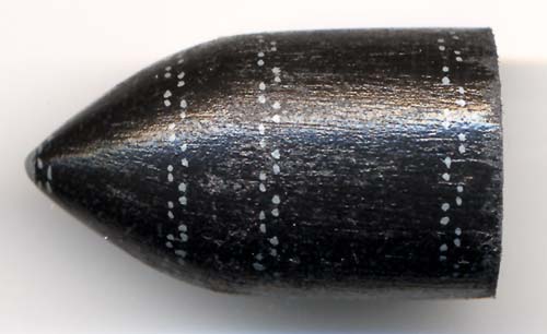

Please do yourself a huge favor and don't EnABL those drivers.... first. I will assume, hopefully, that you have read the tutorials on how to EnABL drivers with the tools you have ordered. Reading is not a substitute for hand eye coordination practice. You need to have at least 4 drivers under your belt before attempting something you care about. And then there is the whizzer. These are real beasts to tame, it can be done and I do know how but you will need many hours of listening to EnABL'd drivers before you can determine what is wrong and where it is coming from.
The problem here is that the improvement is not just a little bit. It is actually a very different sort of thing from what you will be used to hearing. On one hand it is quite subtle, being more detail at ever lower levels and on the other hand it is quite misleading, with all of the usual clues about speaker stress having disappeared.
I am sure you can deal with these issues, but not for your first speakers EnABL'd and with whizzer's added to the mix.
Bud
