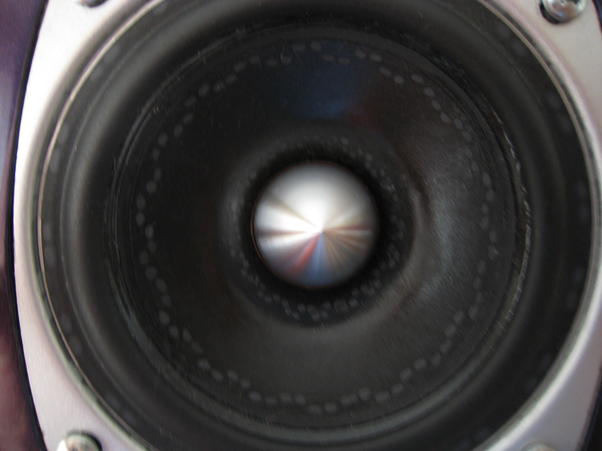

Hi Alex. I have done 1 set with Mod-Podge and 1 set with C37. Treating paper cones is well documented like Scan-Speak and Seas for example. It provides an audible improvement in reducing break-ups. As Planet10 said, it is easier to EnABL a coated driver as the paint does not soak into the paper. All I'm reporting is what I hear. I would love to be able to hear a dramatic improvement as I've given this procedure a lot of time and thought and Budp has been very helpful offline. I am not really thrilled about my next option of going to some $1,250++ pair of Snell's or Northcreek monitors but this is the route if I can't get these Tang-bands to work acceptably.
As for the quality of my work. As Budp says Murphy will quickly show you how easy it is to be less than perfect. "You can really fool around with how it is applied and with what degree of accuracy, and still get the same audible benefits." Hopefully the attachment is here and you can judge for yourself.
I am planning on adding 2-3 more coats of C37 to #2 and then EnABL'ing it. We will see if that gives an audible improvement. i will use a thinner pen and try to get more of an arc than blob although I see this as esoterics than for audible improvement.
