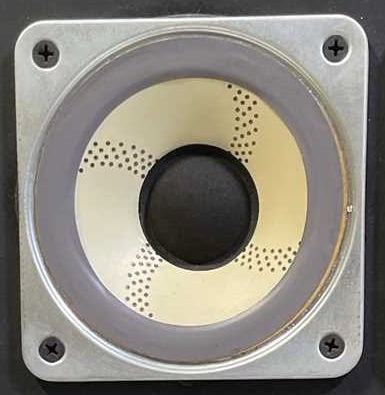

Global number, shape, pattern and global localization of EnABL dots are the same as in the patent. Sorry, it is clearly the case here and it is "blind following" for me.I can't honestly say that sounds like 'blind following' to me, since that normally implies total acceptance of everything, without question or variation, which clearly isn't the case here.
Decreasing cone resonance is what is wanted. If the applied dots are too small in area/mass, they will not change anything.Yes. But that is assuming it's actually wanted / required.
I agree. But how will we know when the optimum is reached? You have to apply more and more, to the point where it is clear that anything more is harmful. Do you really think that EnABL dots are the optimum?From a practical POV also, when making permanent mechanical modifications, it's usually better to start with, or simply use, less rather than an excess.
But what if those dots are not enough and defeating the cone resonance require more? Maybe conventional "ring" applied to the cone with diluted PVA (or something else) close to the cone surround is just enough?you may not require more [more not necessarily always being 'better' or beneficial, especially in these cases]
Or, to take it to a silly extreme in other direction - we'd all be painting those silly EnABL dots to the cone.Otherwise, to take it to a silly extreme, we'd all be nailing sheet lead to the cone.
So the additional rings Dave regularly added, the unit-specific positioning etc. [which you've already accepted] now don't exist and are 'blind following'. We obviously have rather different definitions. 😉Global number, shape, pattern and global localization of EnABL dots are the same as in the patent. Sorry, it is clearly the case here and it is "blind following" for me.
According to whom, in the first case [since it may or may not be]. And nobody appears to disagree in the second [for practical purposes: since they exist, they will make a difference, period, although whether it's within audibility threshold is another question]. But the location, position, mass and stiffening requirements vary on a case-by-case basis, so blanket statements that 'it doesn't do anything' are twaddle in the same way that any other dodgy physics are.Decreasing cone resonance is what is wanted. If the applied dots are too small in area/mass, they will not change anything.
They may be. They may not [assuming you're after damping in the first place]. But this 'what if' business is pure speculation on ephemerals, and back to a case of condeming something simply because you think something else might be more effective, without knowing the conditions. And it might. Or it might not. Equally, people may care. Or they may not.But what if those dots are not enough and defeating the cone resonance require more? Maybe conventional "ring" applied to the cone with diluted PVA (or something else) close to the cone surround is just enough?
Which is just mud-slinging without an engineering argument.Or, to take it to a silly extreme in other direction - we'd all be painting those silly EnABL dots to the cone.
You don't like it. Fair enough. That's your right. I'm ambivalent myself, for the reasons above & others -from my POV the original speculated mode of operation is wrong, and the entirely generic positioning unlikely to yeild much of value except in some very specific cases. In its adapted form, with unit-specific positioning & additional rings & other blocks etc., then it's rather more likely to have some form of effect, subtle or otherwise. That's just basic physics, mechanical engineering & acoustics, like it or not. People can debate whether something might, possibly, perhaps, maybe more effective in a given situation or in general, but it's castles in the air, since unless they're going to do a comparative test, they don't actually know, and the can't generalise from that any more than the reverse is the case. If they care enough, they can try. I don't. So I haven't. And I'm not going to either.
Not in EnABL2. The ringsets take the same form, their placement is quite different. And one often finds addition places to put the rings. The midcone ring on FE126/127 was a first application of that, and the new pattern on the FFxx5wk dustcaps shows the power of getting feedback from the actual cone in order to placew the spots.
Current EnABL looks visually somewhat like what is in the patent, but better ring placement is a big step forward. At this point patent is only of acedemic interest.
dave
They do exist, but "unit -specific positioning" still is under the description of the patent, including the patent claim 1: "the features in the pattern extending along and adjacent to at least a substantial portion of said discontinuity". The term "discontinuity" is defined in the page column 1, rows 37-39, and is place where the discontinuity is formed, and of course, the place where the dots are most effective. I know thing or two about patenting - pictures are for illustration only, wording in the patent claims is everything.So the additional rings Dave regularly added, the unit-specific positioning etc. [which you've already accepted] now don't exist and are 'blind following'. We obviously have rather different definitions.
Description "regularly added additional rings" means that there are cases where there are no additional rings, like this Dave's example of "improved" EnABL v2 :
We can see that the number of double rings on the cone is the same as in the patent: four. No additional rings! Also, there are EnABL dots on the driver mounting plate/flange - are this for "cosmetic purposes" also, or according to the patent claims?EnABL v2
Maybe we have different definitions for "blind following", but we must have same definition for the number 4.
That is all that cone needs. You will note that the rings are not in the same place. This is a particulr 4” cone.
The similar 5.25” has an extra set of rings, so do the dustcaos — as do the 4”.

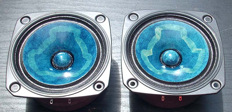

Coating the whole cone, or part of it, with materials like diluted PVA, varnish, ModPodge, WetLook etc. in order to change the mechanical behavior of the speaker cone is proven with numerous measurements, and there are no measurements for EnABL dots to prove they are more effective. Even without knowing the conditions, physics teach us that there must be some minimal/critical amount of something (EnABL dots area and/or mass) on the cone, to have any audible difference above the hearing threshold.But this 'what if' business is pure speculation on ephemerals, and back to a case of condeming something simply because you think something else might be more effective, without knowing the conditions.
There is a engineering argument - there must be some minimal/critical amount of something (EnABL dots area and/or mass) on the cone, to have any audible difference above the hearing threshold. Until that, it is a castle in the air....without an engineering argument.

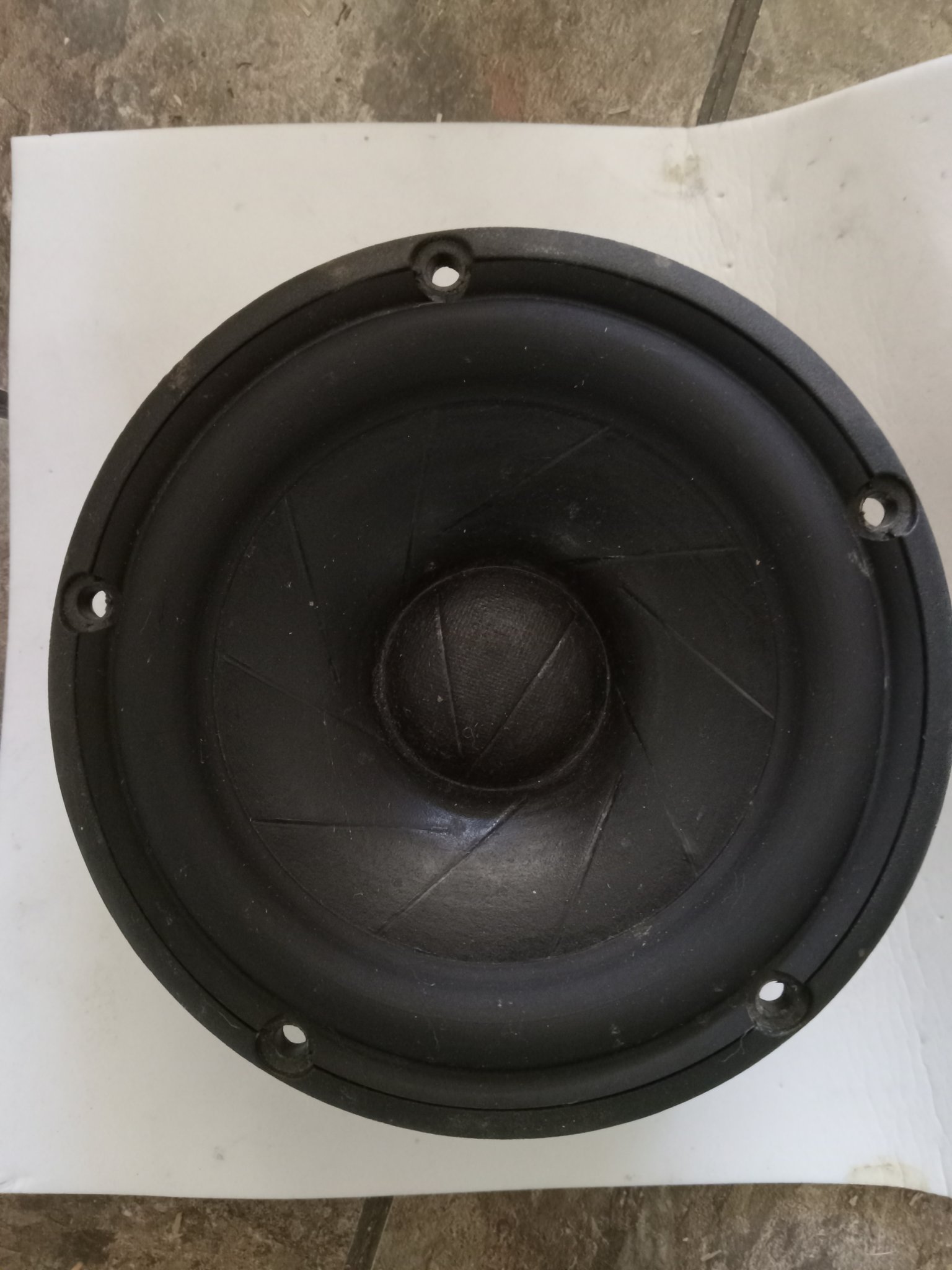

the second more clearly shows one part of the stiffening that was applied
Damar. Love the smell (in small quantities). Mike MacKenzie gets credit for figuring out/inspiring the pattern to help curb HF resonances.
A much more recently the use of ZIG 2-way on the back at bthe surround cone overlap also helps (FE/FF)

I believe that EnABL patterns disrupt standing waves by creating new distributed and discontinuous reflecting boundaries in addition to those created by major boundary reflections from cone-surround, cone-VC, and cone-dust cap boundaries. Local reflections from pattern elements are out of phase with major boundary reflections, so they sort of "de-tune" the standing waves.
Micro Gloss coating disrupts standing waves by different principle. Because speed of sound is different in the paper layer and the Micro Gloss layer, the standing waves in the two layers would be at different frequencies, so in the sandwich they interfere with each other. I guess BudP empirically determined that effects of pattern and coating are additive.
There was a body of research about visualizing standing waves on speaker cones. They found complex patterns of radial and tangential SW at frequency multiples. I did my best trying to find it on the web but failed.
A simple way to visualize standing waves is to use light particles, e.g. sand or sawdust. If there are standing waves, the particles will clear from humps and collect in the nodes. This cannot be done directly with a typical speaker, but a test speaker with flat radiator can be constructed specially for this purpose. If EnABL changes standing waves, that would be a proof that can be extrapolated to regular speakers. I am going to do it sometime this year, but now I am too busy with more urgent things.
