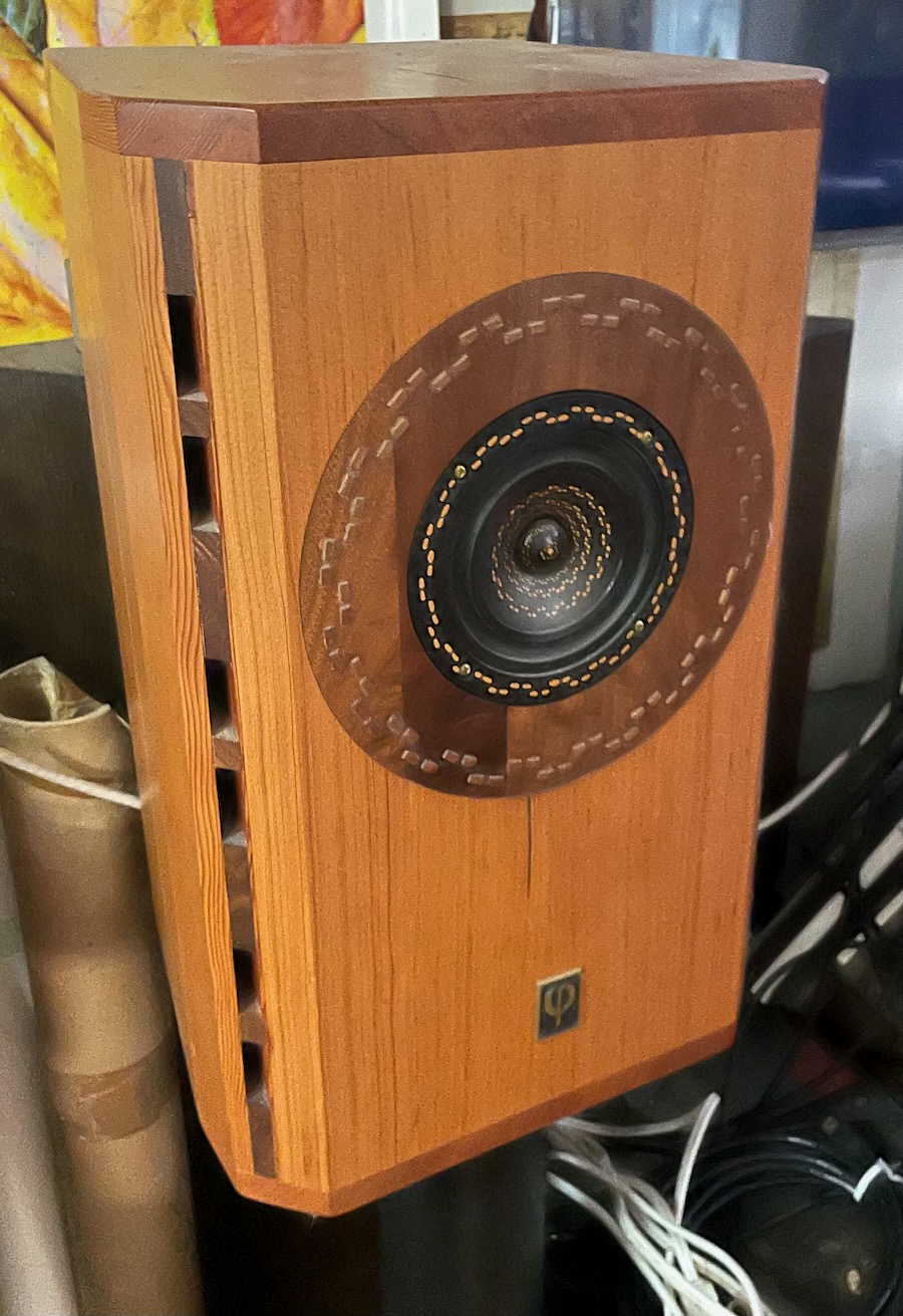

Having had a look at the patent, it mostly mentions "discontinuities" and "patterns". Since we are talking about wave propagation it is implied that the discontinuity has to be relevant to the propagation mechanism, creating scattering centres. For the waves on a loudspeaker cone, embossing or placing a dot of paint might be sufficient. Drawing on the cone with a felt tip pen probably is not. For some effect to take place in an enclosure wall, I would think something else is needed, e.g. a cavity (not such a good idea in a loudspeaker enclosure) or an embedded higher density material of the right shape. As a homework one could of course run the full FEM simulations to see what happens, how much mass is needed, and what is the magic behind the pattern.
From the patent is is obvious that higher density material is not important, but only the specific pattern of painted dots! 🙄For some effect to take place in an enclosure wall... an embedded higher density material of the right shape. As a homework one could of course run the full FEM simulations to see what happens, how much mass is needed, and what is the magic behind the pattern.

As for wideband drive units, they're not all created the same way, so there are variations in terms of progressive [or otherwise] decoupling of parts of the main cone and / or transitions to additional sub-surfaces e.g. direct-bonded central caps, additional bonded sub-cones etc., so the actual functional / resonating mass of the moving components at a given frequency is unlikely [especially above the notional piston corner and certainly the VC point-source corners] to be equal to the total Mmd relevant to LF measurements at / around Fs / F0. This goes right back to Altec's decoupled biflex designs & earlier [later for that matter] less specifically decoupled types also. So ignoring EnABL itself [since different approaches exist, it's difficult to pigeon-hole it anyway] & simply speaking in general, localised changes to the mass / damping / rigidity of the substrate are likely to have some effect, especially if the starting substrate mass at & around that point is already small. It won't necessarily be large -in most cases it won't be, but the laws of physics mean that there will be something.
Speaking generally, that doesn't mean anybody is obliged to blindly accept everything that is written in a patent in total [or part]. Dave is an example of one who simply took elements of this particular idea and adapted from there.From the patent is is obvious that higher density material is not important, but only the specific pattern of painted dots! 🙄
I have given that some thot … easier to CNC a pit than preserve a bump thru finishing.
