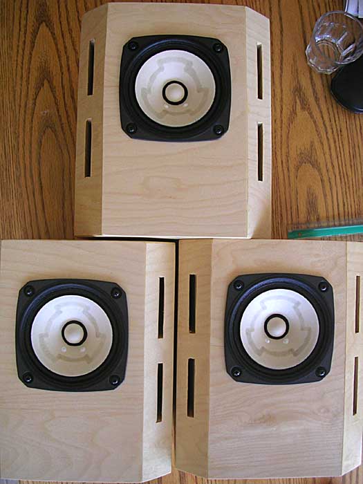

Let me say at the outset, I believe I am far more sensitive to the treble 'issue' than most 'normal' folk. The FE127 had a big following several years back and many people loved it (I bought them because of that reason, also recommended by 'planet 10').
My self-diagnosis is that I have a bit of hyperacusis going on.
Hyperacusis - Wikipedia
I think there are others with this sensitivity. A poster I haven't seen for awhile called 'InclinedPlane' used to comment on his impressions of certain full range drivers that leads me to believe he and I have similar taste. I have also observed fatigue after several hours from too much 'brightness' from well-regarded commercial 2-way speakers. The PMC FB1's I own are a tad bright and don't pair with all my amplifiers. I've read other people have found this but they were widely popular. I will 'upgrade' the tweeters to fix this one day. I also once owned a pair of Grado SR60 headphones that made me want to shoot myself through the head - treble response looks like the himalaya. No idea why any normal human could ever suffer using those things.
Anyhow, the box and baffle step are unrelated to the treble harshness, they relate to bass-treble balance. Over time (some months) my ear/brain became less tolerant to it and instead of tiring after an hour of listening I simply couldn't bear the speaker after several minutes. I'd catch myself tending to avoid playing certain types of music, searching out for tracks that were more conducive to my ears.
My boxes were too small, at around 6 litres (see attached image), they were half the volume of the 13 litre Fonken Prime (?) and I was not getting acceptable bass. But I had planned all along to use them with a supporting sub-woofer. It was for my HT set-up.
In the end I gave up on full-range for HT and now use full size tower speakers for fronts and rears. For music I still like single driver full range speakers but not the Fostex driver.
The attached are the last 127 ring set I published, 2012. Print from Adobe reader with full page control. Usual setting is for less than 100%. Cut out and drop onto cone as Dave shows. The mid cone rings will go a long way towards eliminating the 7k peak.
Thank you very much.
My only question is : What is the Back side outer ring ? Is it really applied on the back of the cone ? How do you do that ?
Not easy to apply the back ring, but dots go on like the front side. With the pen tip held upside down. Cutting the ring guide and threading it in around the cone is interesting though. I usually cut across the guide on a shallow angle and manage to tape the ends together. Exact placement for this pattern is not crucial. If you are not using the driver open baffle don’t bother with the back pattern.
