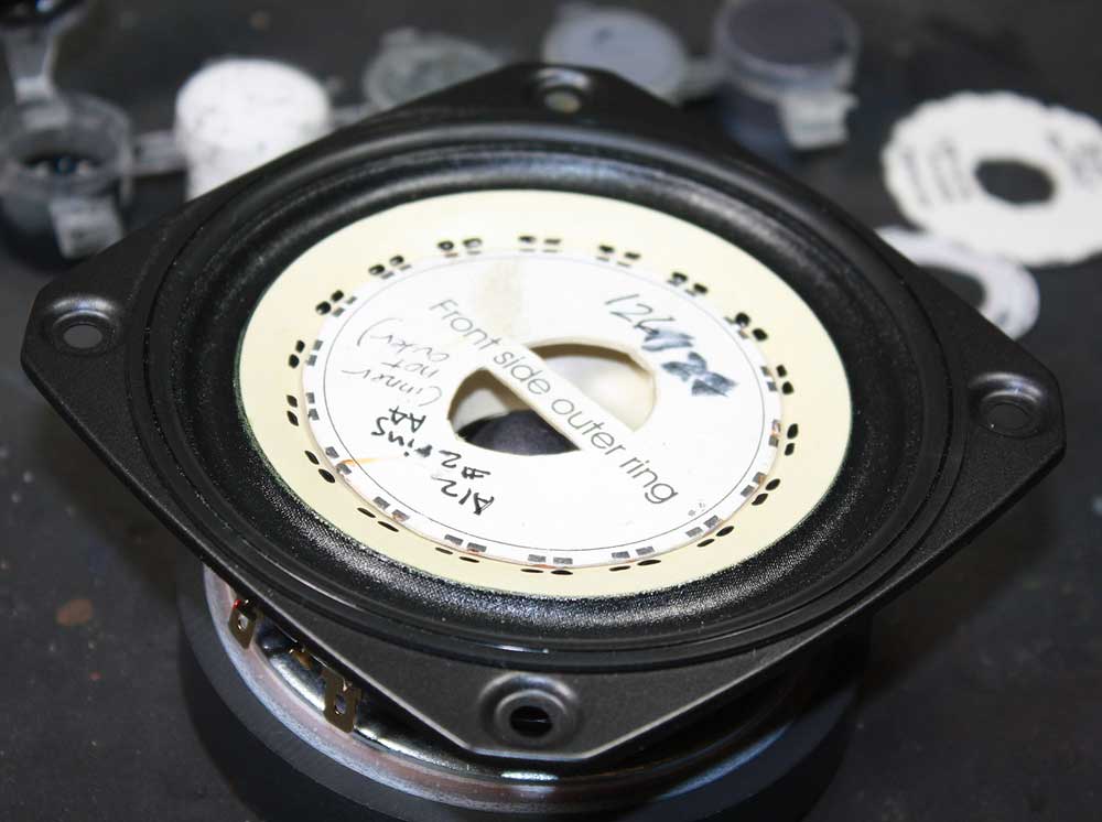

after building the fonkens with my good old FE127s i am very pleased with the speakers. They sound really well, only the 7k raise kills me. It lets my fingernails rotate upwards 🙁. I know that this is the typical FE127 cone sounds, that occur if untreated. Living in germany makes things problematic, because its hard to find the right fluids. I found ModPodge at a local store now and will apply the trifoil pattern. Where can i find exact dimensions ? Where on the cone should the first ring be and where the second ? How wide should the line be ?
And what paint do you use for the polkadots ? The brands you describe are not available in europe. What are they intended for? Perhaps i can find some replacements.

My experience with some basic damar treatment was no improvement in the treble shriek but the sound lost some of its magic so rather than ruin any more of them with coatings I sold them. Trying a line level notch filter first is at least reversible and perhaps tunable.
The trifoil pattern is done with damar varnish (try a fine art ssupply store), i’ll have to dig out my template and measure to give dimension (althou they might be buried somewhere earlier in this thread). Then thinned modPodge over the whole cone.
Spots are done with non-metallic acrylic train paint. After the spots 2 coats of 50% gloss and 1 on the dustcap (another acrylic used to coat decals on models & model trains).

Thank you very much dave. I found the dimensions of the rings in the thread, was blind before. Its 9mm and 17mm.

I found the fluids and also understand how to paint the trifoil. Now the only question ist, how do i use the enable dots template ? How do i bend the template. Painting by hand is a no go i think, but i am not sure how to create a working stencil for the dots.
I can dig out the templates and give you the dimensions i use. The FE127 uses the same templates as the FE126. 3 separate ringsets plus the dustcap.
Because of the nature of the paint that is being applied a stencil will not work. Each of the some 310 spots needs to be applied by hand using a calligraphy tip. One puts the template of the cone, use it to apply the outer ring, carefully remove the template (it is VERY easy to smear the paint on removal), and then use the just applied ring as a template for the inner half of the ringset. Let it dry and then do the next ringset down. Repeat until done. A4, A5, #56 calligraphy nibs.

Read posts 13-17 in this thread for Bud’s basic tutorial: EnABL - Listening impressions & techniques

Thank you 1000 times dave. At this moment the dammar is drying, i think i will apply the mod podge tommorow.
I will read the thread you pointed to first, but at the moment i do not really understand how to use the template for the dots. Being a computer science guy, sometimes im a little slow on mechanical stuff 😉
Do you have a picture how i should hold the template ? This would help a lot.

The dimensions would be very nice, i cant find them anywhere.
Do you have a picture how i should hold the template?
That will come. I have yet to share them.

Thanks, i thought way too complex. Of course, this way it functions best.

The templates have not changed for the current FE126En. The template i will release is generic. You can then take the dimensions — i just need to dig out the templates and measure them — and cut appropriately.
