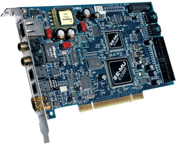

All the 1616 heads are interchangeable. the M version has the AK5394A ADC the non M version an AK5385 ADC. The AK5385 has slightly higher noise and distortion and the noise shaping corner is around 40 KHz where the AK5394A corner is past 100 KHz.
I'll post more notes on these in the next few days. Having to fix them I'm learning more and this is as good a place as any to share the details (so I don't forget).

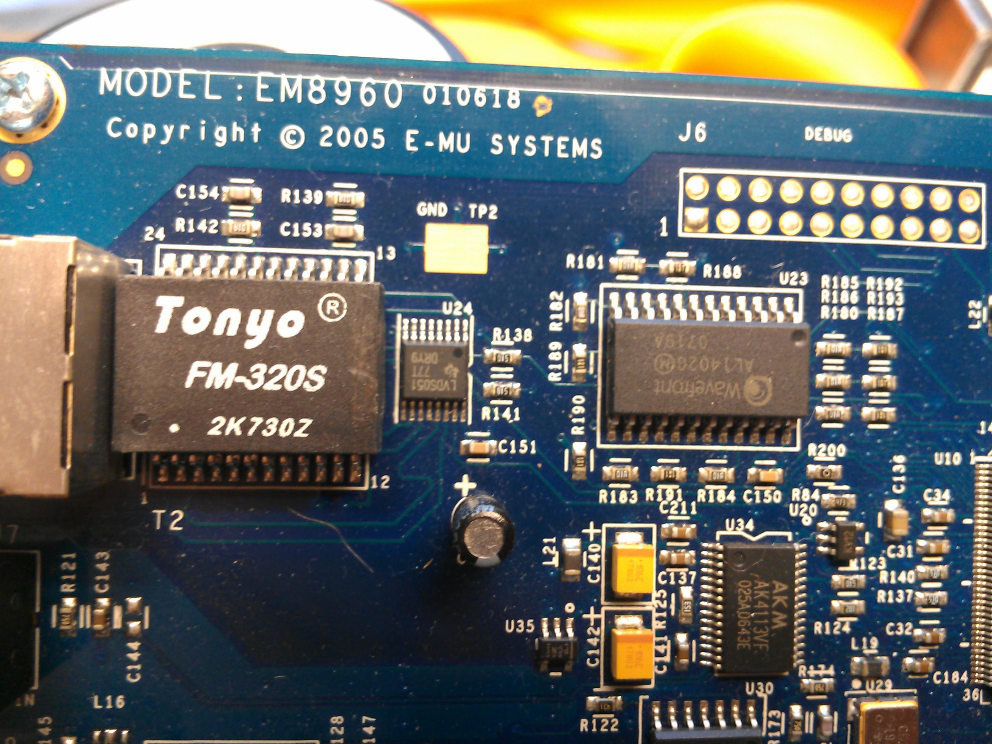

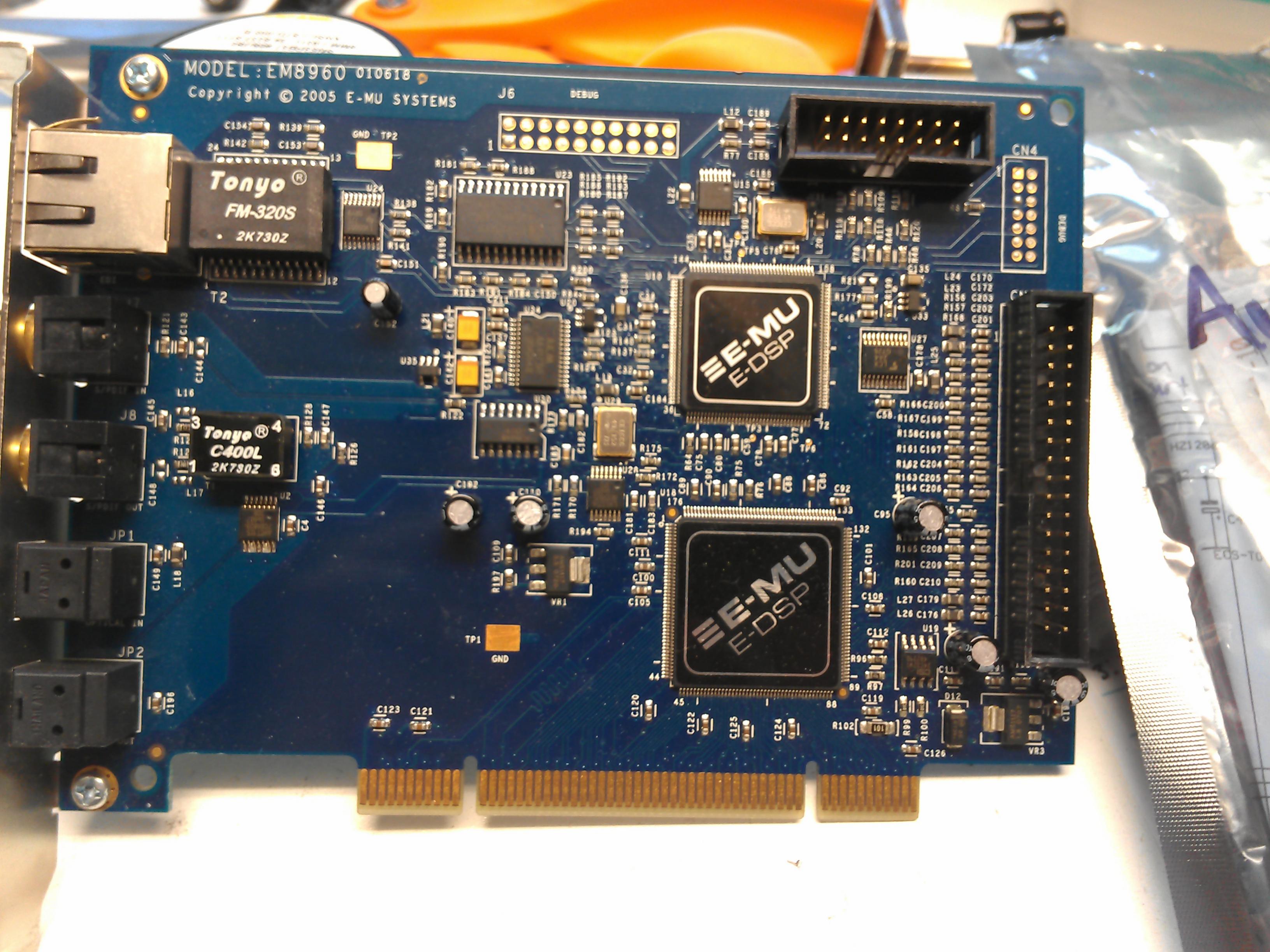

Here are some closeups of the newer EMU1010 card, identified on the card as the EMU 8960. I got one that worked fine with the associated 0202 analog card but not with a 1616. Once I was certain it was the card I figured out that the digital IO chip LVDS051 was toast. Probably someone connected a network cable to the port and cooked it. In any case (on my second try) I got the replacement chip, replaced the bad part and the card is working fine.
The part number is SN65LVDS051PWR for the TSSOP package.
When I figure out what I fried on the 1616m's I'll post those details. That damage was more extensive- taking out both cards in the box. It looks like the DC-DC converter and the Xylinx CLPD both got cooked when I crossed the pins on the board to board interconnect. It will be a while before I have made progress, waiting for parts now.

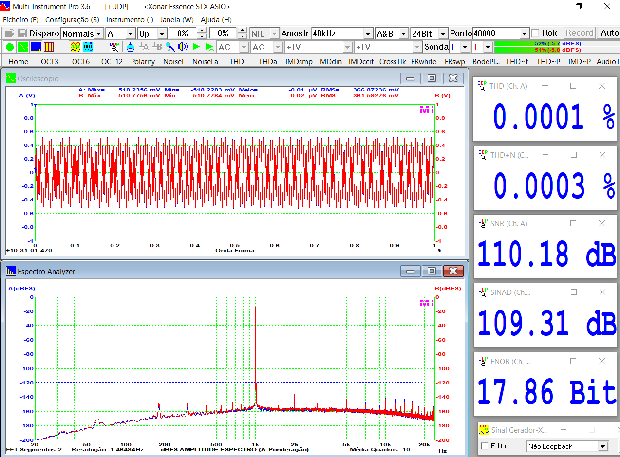

I'm using an Asus Essence STX plus a Virtins software for measurement.
The 1kHz THD, THD+N and SNR reached, at -6dBFS (1Vrms), the sweet spot in my system, 0,0001%,0,0003% and -111dB (-116dB at -0,2dBFS, but THD rises to 0,0002%).
I achieved these values after replacing the original opamps to LME49990 (using a SMD to DIP8 adapter).
In the end of the scale the THD residual values are the same of the original ampops, but the original sweet spot residual was 0,0002%THD.
The ASIO driver is the native one for the board (Asus) running on Win10 machine.
Those are remarkably good measuremnts for an STX. You must be doing something right.
Yep,
I just use a good mobo, PS and put some copper shielding in the STX pcb.
The PC configuration (shut down the network card, disabling power energy modes, adjust the latency of STX etc) were important too.
But the system is very sensitive, at these noise leves, to connectors and cables length and quality. I achieved these values in loopback mode with short cables.
