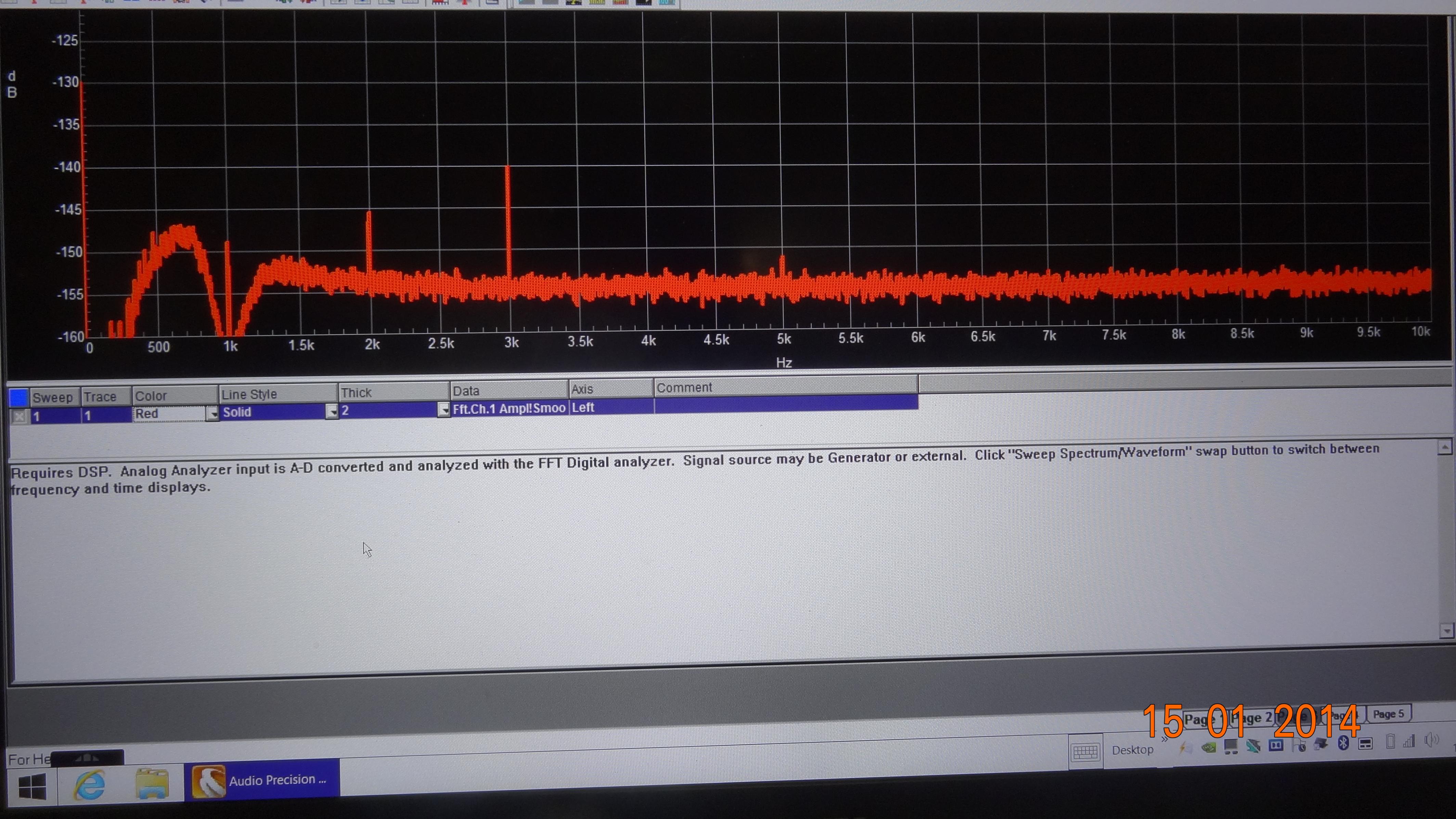

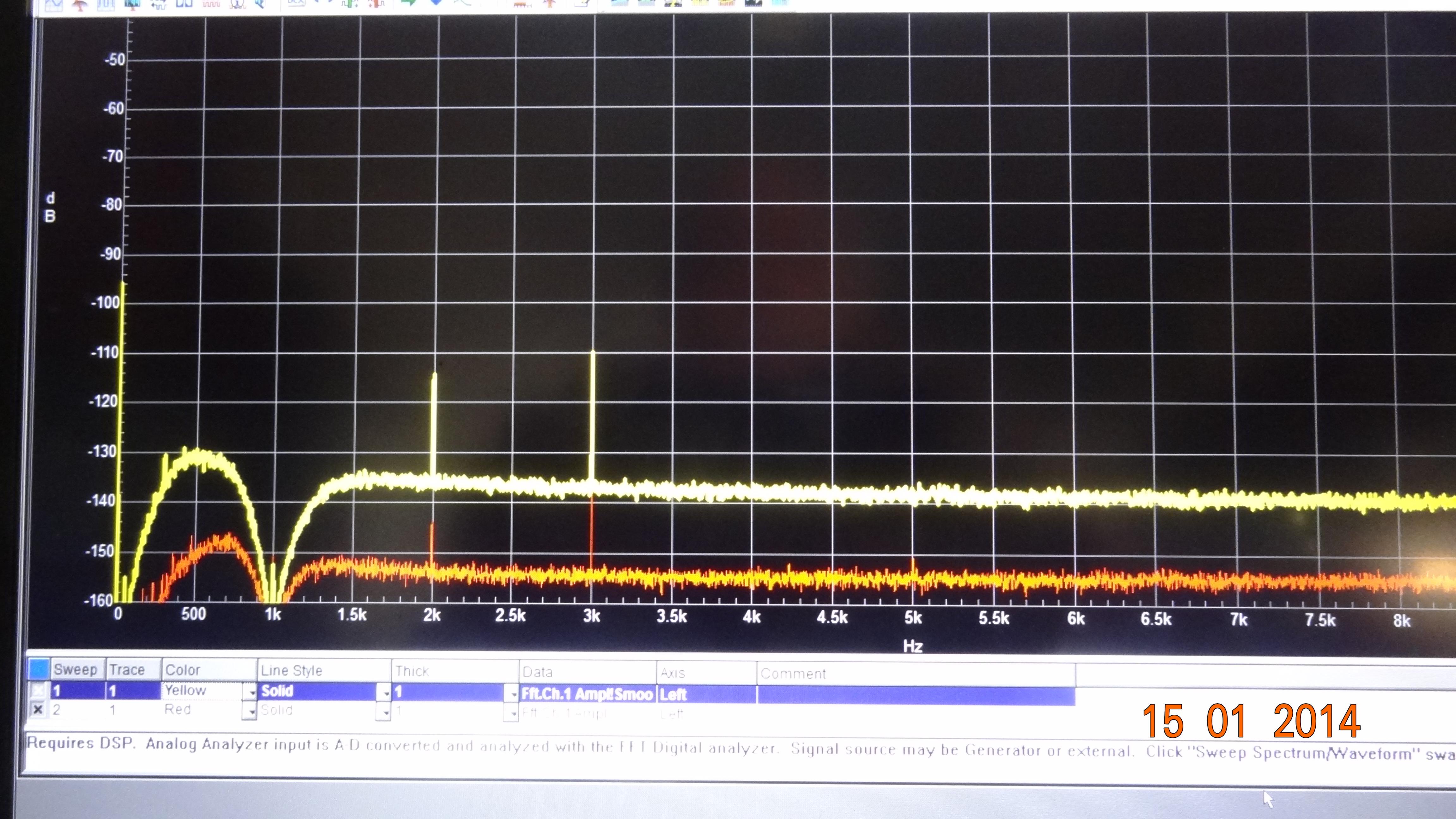

I'm not sure what you are driving towards. I have posted a way to confirm level accuracy at these low levels while making distortion measurements. Verifying ultra low distortion is extremely difficult. If you know your source is clean you can then verify the harmonics using the above techniques. I would use a CLT-1 and see what I get at the higher harmonics since its the only device I know if that is essentially free of HD3 and up. But its really clumsy to use.
Its easy question --- how good/accurate is the data at or near and below -100dB being shown by anyone here?
After looking at QA400, all are now suspect to me. [Unless they use a notch filter, I dont trust any of them down there]
Thx-RNMarsh
PS -- hope the CES was fun and good for you. Glad you are back. 🙂
A-P 2722 internal source-analyzer loop:
