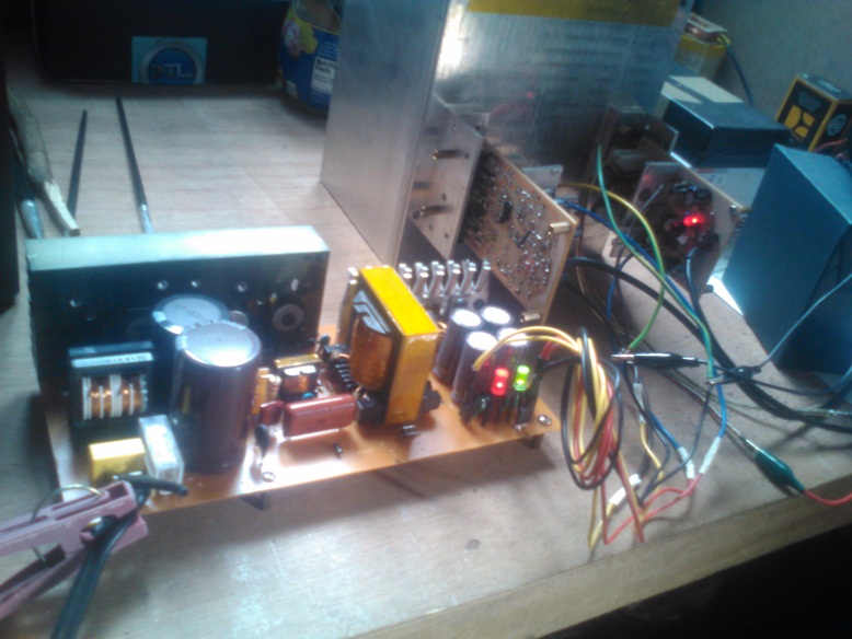

Hi thimios!
Find the sprint file in the attachment, my build is part hand drawn because I modified it to accomodate IGBTs, it is Detex Audio circuit self oscillating smps topology. It is very popular in this part of the world, you can join the Indonesian group S.O.S (self oscillating smps) in Facebook and find out how are they doing it. SMPS is very challenging to DIY you should try it, you have the equipment..😉

Oh yes..this reminds me of my Tekukur build, I don't have Sanken's so I used 2sc5200/sa1943 with some values adjustment, it sounds powerful in my diy smps....😉

Could be an smps topology issue? Self oscillating seems to be popular to audio enthusiasts in this region..the Indonesian group that I mentioned above are doing it differently, the secondary caps are made of multiple small value caps and they are using toroids rather than EE ferrites most probably to boost regulation efficiency and they are pushing it to work above 100khz fsw (Detex default is about 100khz).

BTW..from what I gather magnetizing field of toroids is confined in the center and the fringing flux that occurs is suppressed. (fringing flux is bad to audio am I right?) I intentionally placed my smps build near the amp with everything exposed to see how it affects the operation. So far I haven't noticed any audio disturbances visible to the eye and audible to the ears..but I'm no expert here...🙂

There are tutorials on Yuotube on how to construct the traffos, diysmps.com had plenty of reading materials on how to do it homemade. I think you are capable plus you have measuring instruments. 🙂
This is my modification.

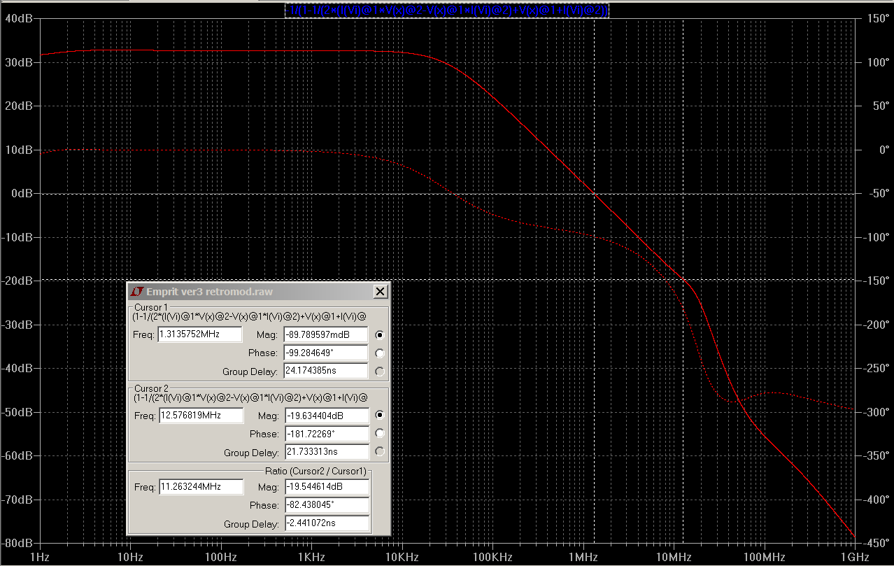

Emprit Retromod
Dear bimo,
As an exercise, I started with your .asc file from post #20 and modified it to Retro mod. The results are as below. Kindly comment on the results.
--gannaji
Dear bimo,
--gannaji
Dear bimo,
--gannaji
Good stability.
You should build it and measure it.
If the measurements far away from simulation, maybe your pcb layout is bad.
The LTP tail voltage and current regulator with LEDs is a bit cumbersome in the retro version. Can it be made simpler ?
