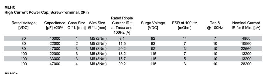

Thanks for that. I was a bit scared of the extra capacity so I removed 4 (40,000uF) of the existing and adding 2 x 47,000uF. Should push it to around 170K uF. Hopefully not too much for the transformer.
Successfully installed 2 Mlytic 47000uF in each amp. connected using 2 x 1.33mm solid core copper wire used as earth in houses, as could not source any good cables. I will try some silver 1.5mm's later.

I used the M-Lytic 47,000uF 80v specs below
