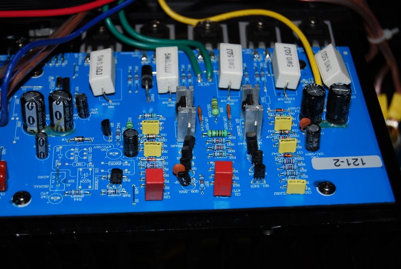

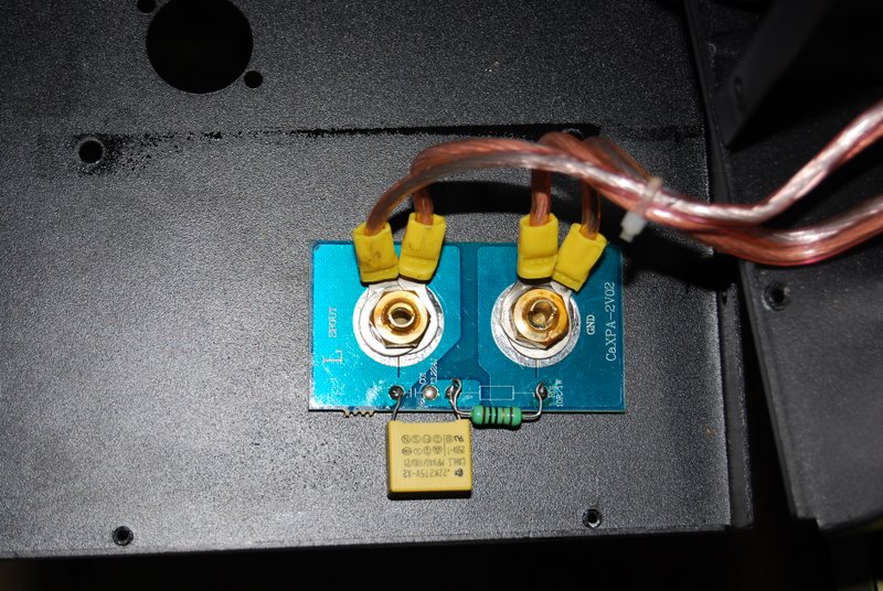

Erin, if you happen to open your XPA-2, could you take a picture it's amp module PCB. It would be interesting to see how it differs from the XPA-1's modules.
I'm about to install some new signal wire in it so I will take a photo for you either today or tomorrow. 🙂

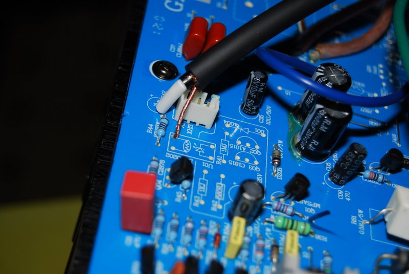

Replacing the wire from RCA to PCB with Klotz AC110

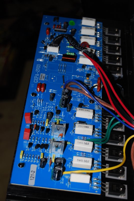

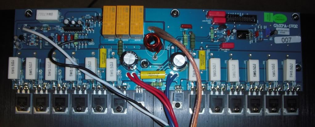

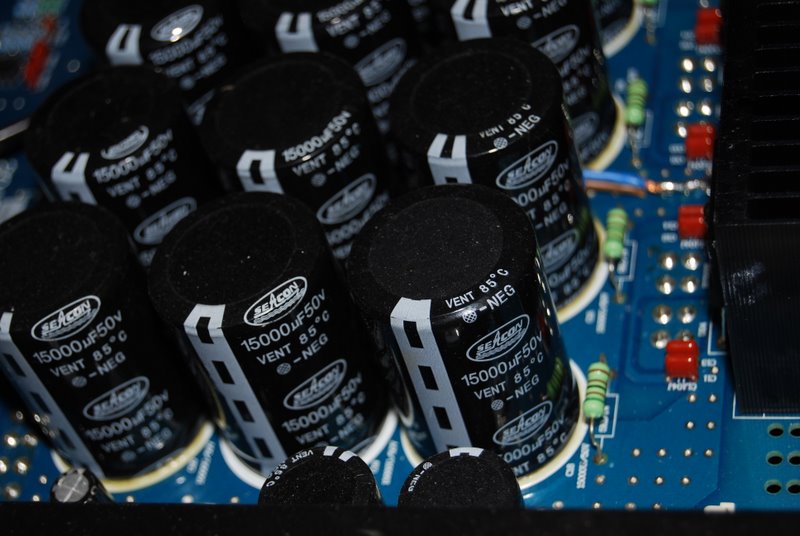

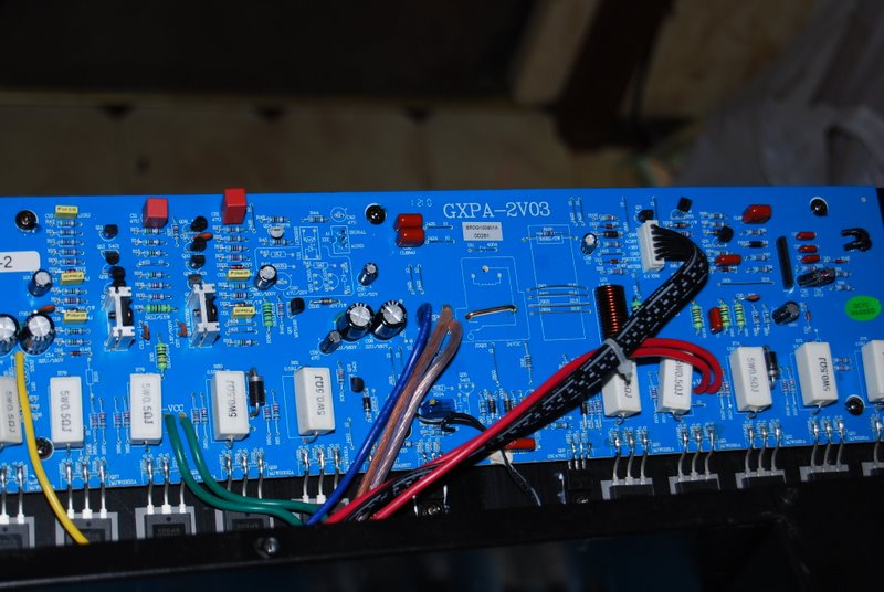

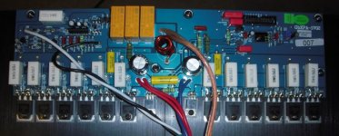

XPA-1 vs. XPA-2
Legis, I put both photos together on one post... hope you don't mind me using your photo.
As can be seen the XPA-1 has nice thick tracks and nice capacitors.
XPA-2 has thinner tracks and not very nice capacitors.
In practice though, the XPA-2 sounds very nice.
But not as nice as the XPA-1. Yes, I have heard both. 😉

Thanks erin for the photos! I always thought that XPA-1 is very close to XPA-2 (mainly difference being that XPA-1 is bridged) but it definitely seems that these amps don't haver similar amp modules. Very good and neat job on both board.
By the way, I'm going to change the XPA-1s' emitter resistors to non-inductive Mills, and change the value from 0,5ohms (like XPA-2 also has) to 0,22ohms (and up the wattage rating to 12W) so I get over double A-class region with the same bias voltage that is used originally (approx. 10mV measured over one bias resistor, changing little to resistor to resistor). Also the output coil's damping resistor will be changed to Mills, as it's also directly on the signal path like emitter resistors. The wires that go to speaker terminal will be changed to long grain solid core copper and for the two big 4,7µF DC removing caps at the preamp stage near the inputs, I thought that 250V ESA-series Clarity Caps would be a good choice, mainly because of their size (they are also reasonably prized). 🙂
I could also change the two caps on the amp modules (I think they are bypass caps between voltage rails and ground), and one "HF shorting" cap between the voltage rails, but ESA-series does not have right value caps so maybe I just leave them be. Maybe some ultra low loss factored polyprop caps would give better HF filtering though but the change can be very minor. There are also other caps (Wimas) but I have no idea what cap is on the signal path.

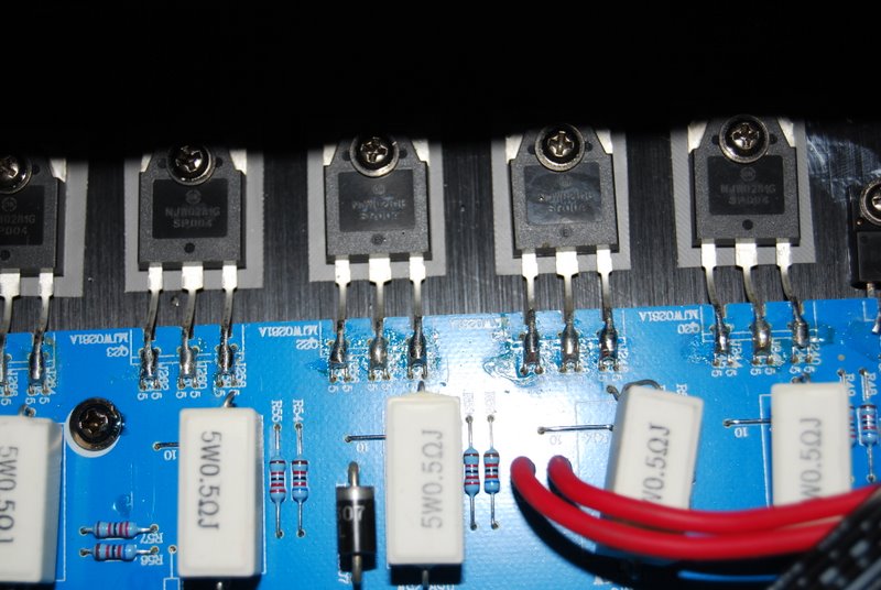

I notice that both the XPA-1 and XPA-2 have trim pots on the output stage. Do you think this is for DC offset or idle current bias? One channel of my amp idles hotter than the other. I would like to match the bias on both channels. I guess I will have to experiment to find out. The reason I have not done this allready is that the wiring is quite short and it is difficult to get the output stage out, whilst still being connected, and also measure bias, and turn trimmers..... and not short something.....😱

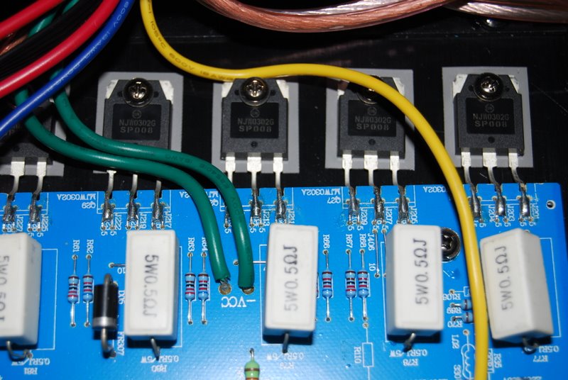

That's bias voltage pot in XPA-1, I would be inclined to think that it has same fuction also in XPA-2. I have tried to change the bias voltage but found out via measurements that the stock setting of XPA-1 (approx. 10mV voltage drop per emitter resistor) is optimal, regardless the usually recommended 15-25mV. Higher bias rises H3 in A-class region and the amp produces more odd order harmonics also at higher power (50-150W @ 4ohm). For this reason I will change the emitter resistors to smaller ones, to be able to increase the bias current without changing the bias voltage.
If you just want to even the bias balance between the channels there's no harm done for sure. If you have measuring equipment you could try different bias settings, it is not sure if XPA-2 is optimally biased. Have you been able to measure it's power consumption in idle?

I have not measured its idle consumption across the emitter resistors. I think it may be more tricky with the XPA-2. there is not much room to work with the output stage out.
But since you suggest the trim pot is for bias, I will try to give it a go. As I am sure one channel is lower than the other.
I am also now encouraged to replace the emitter resistors with 0.22R
Are you suggesting I need to increase them from 5 Watt to 10 Watt resistors ?
Since the amp power will be the same , 0.22R resistors will see
half of the voltage compared with 0.5R , hence they will dissipate
half of the previous emitter resistors values, so 5W models suits perfectly.

I ended up removing the Klotz cable that I installed inside the amp and reinstalled the original cable as supplied by Emotiva. The original cable sounds very nice.
I also did one mod. The original audio signal wire runs underneath the power supply PCB through the same hole in the chassis parallel with the speaker wires and power supply wires. I drilled two holes in the top of the side plates so I can run the signal wire on top of the power supply PCB. It means the signal wire is shorter and separated from other wires. I think this sounds better than the original way.

Thanks for the photo of the XPA-1 board. It seems to be very nice quality.
The XPA-2 uses Elna Starget DC blocking caps. they can be replaced with any (as long as it fits) film cap of 2.2uf or greater, 5mm lead spacing, and this does make an improvement. (I used wima 3.3uf)
The XPA-1 looks like a really nice board to work on. It appears to use only film capacitors. You could upgrade the sound by replacing the "Sounder" brand film caps for something better. The "Sounder" brand is OK, but not as detailed as some.
Anyway, the XPA-1 sounds so good stock, that with carfull selection of quality components I think that amp could be transformed into the stuff ledgends are made of........
