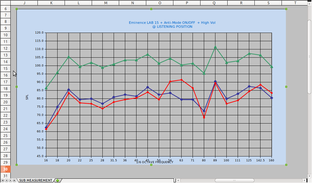

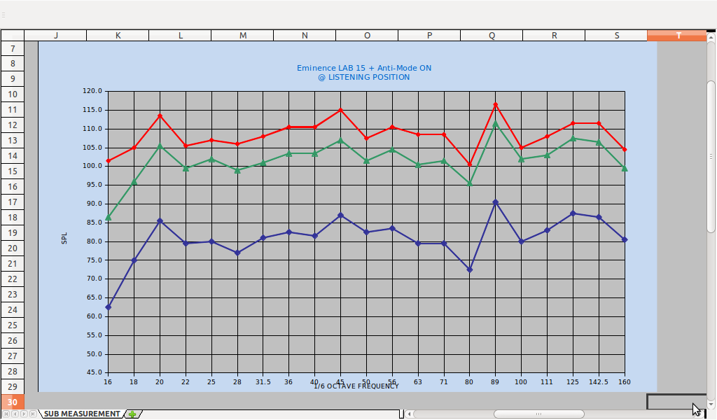

Here are some measurements made from my listening room of the finished Eminence Lab 15. +3dB EQ@20Hz and Xover@80Hz.

Real room response seems to be F3 20Hz and ~100dB SPL@20Hz.
With rock music system plays nicely ~100dB and with bass tracks ~105dB. Main speakers don't like to played any louder. 🙂

The acoustic problems in the room were so annoying so I bought Anti-Mode 8033 S-II.
It took automatically six freq sweeps...it lasted for ages.
The sound is bit quiet now. I think those peaks are now flattened and I can hear some new sounds which were hidden under.
The input signal to antimode clipped with 1:1 cables so I'll try 1:10 cables or I'll make new cables with adjustable ratio.
