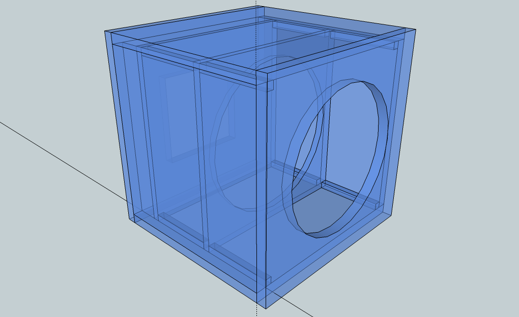

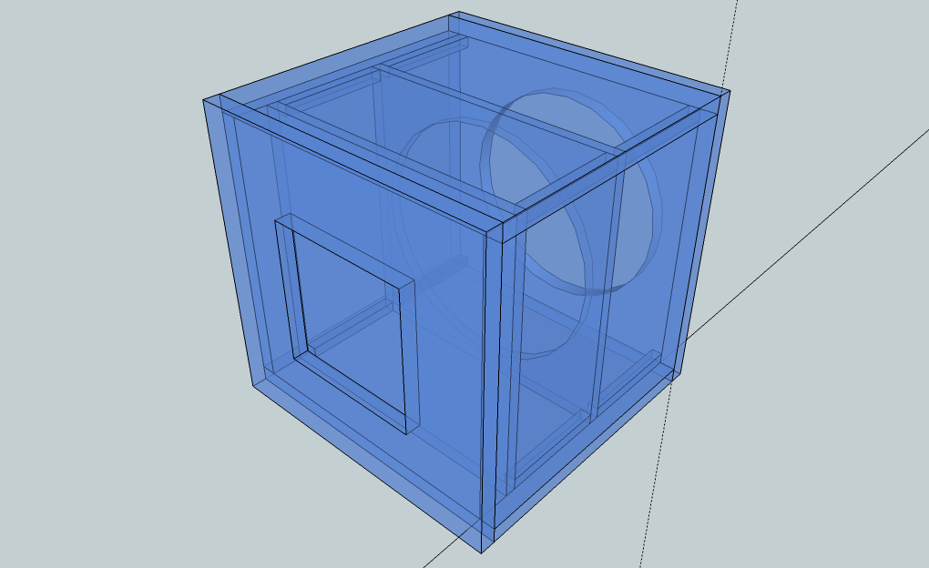

Hi Veke76,
That looks nice. I would add cleats in all the corners, and account for their volume as well as the volume of the compressed filling material, and the back of the woofer.
Bracing needs little bit more work. Chamber behind driver is bigger and needs more support. I made a mistake and the driver comes deeper than I thought.
The actual volume is about 57L and acoustic volume is 68L. I will stuff it 24g/L of damping material which is alot and it will increase the volume plus 20% to 68L. Some may disagree with this but I want same output as in the sim of WinISD. Next choice is to make 500x500x500mm cube which would work even without stuffing. Actually I modelled it at first. 🙂
http://www.nousaine.com/pdfs/Box Stuffing.pdf has some info on stuffing subwoofers. On sealed box 24g/L is ok but with bass reflex maybe 12g/L.
Hi Veke76,
Yes, this would be easier to build. I would add at least one cross-brace on the panel separating the woofer chamber from the amplifer chamber, slightly offset from the middle.

I decided to go for the 19mm MDF and double baffle. My "workshop" didn't have big enough space and tools for this project so the carpenter will assemble the enclosure. I just do sanding, paint job and installation. I'll have it in 2 weeks and then I get to do my work on it. 🙂

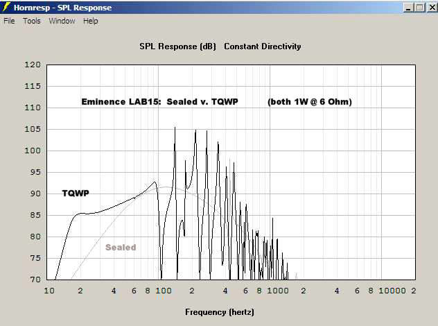

I am also looking at Lab 15 for my DIY sub in a 2600cu.ft. dedicated HT room. I am looking to place the driver in passive sealed enclosure with lot of polyfill. Wondering what the volume of enclosure should be so that I get decent extension & output down to 20hz.
Hi vinodk,
Do you already have the LAB15s? If not, I would advise to look at other drivers, e.g.: the Epic 12" that PE sells outperforms the LAB15 in a sealed HT application. Or go for a different enclosure, e.g.: a T-QWP looks promising for the LAB15
For HT use and 20Hz I would go vented enclosure. At sealed enclosure F12=25Hz and max spl @20Hz=110dB(in room). A few designs from eminence -> http://www.eminence.com/pdf/LAB_15_cab.pdf
Hi vinodk,
T-QWP = tapped quarter wave pipe
T-TQWP = tapped tapered quarter wave pipe
These enclosure forms have been advocated in this forum by bjorno, and seem to result in home speakers of high quality. If you use the search you should be able to find any number of examples. Here is one:
http://www.diyaudio.com/forums/subw...band-w8q-1071f-8-x-12-box-reccomendation.html

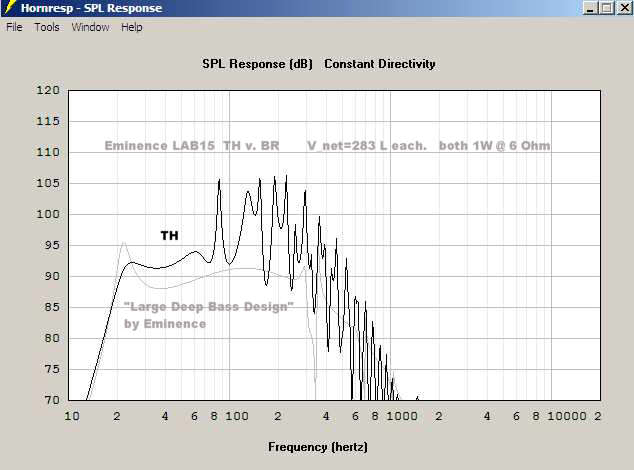

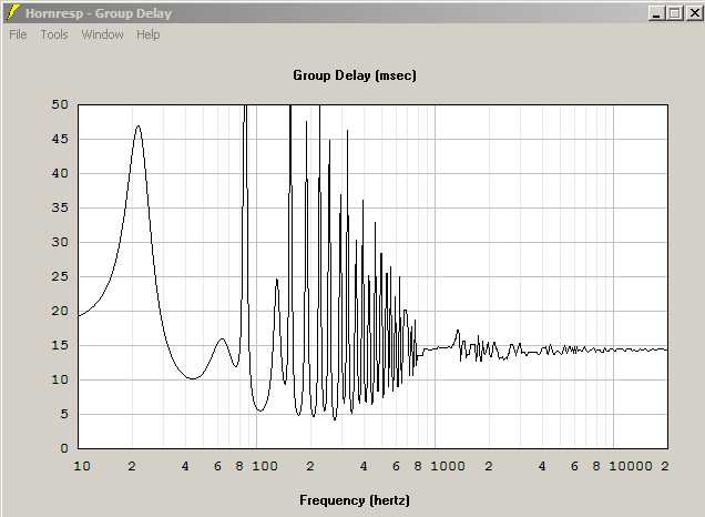

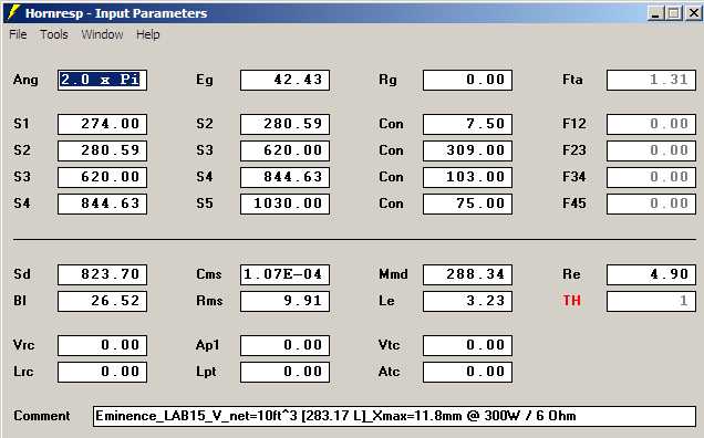

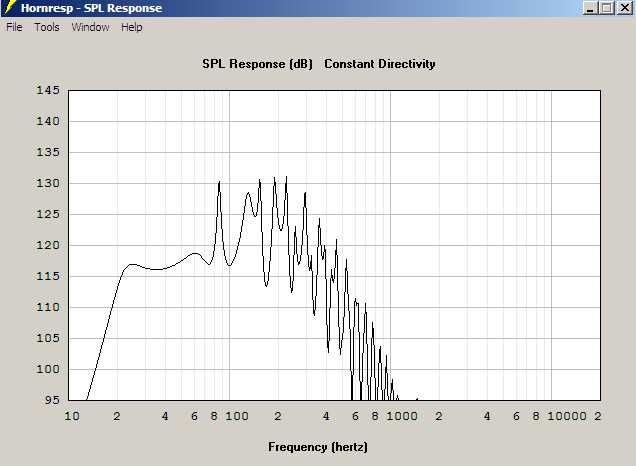

Hi Veke 76,
A TH would work nicely for HT, if you have the room for it, about 400L_net minium. Much better low end than a BR.
With Large Deep Bass Design port air velocity and group delay becomes issue. It peaks 26m/s@22Hz. It should stay below 17m/s. Group delay 56ms@22Hz. It should stay below 18ms.
Any similar problems with TH?

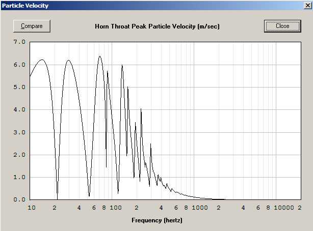

Hi Veke 76,
I think particle velocity is where the real advantage of the TH over the BR comes in:
My 67L sealed enclosure and highpass@12Hz and lowpass@80Hz will give nice sim output down to 18Hz in room and 110dB@20Hz in room. That's enough for me. 🙂
