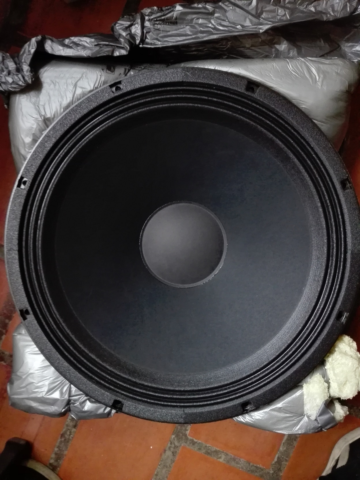

Eminence Delta Pro 18 A in prism sealed 150 liters

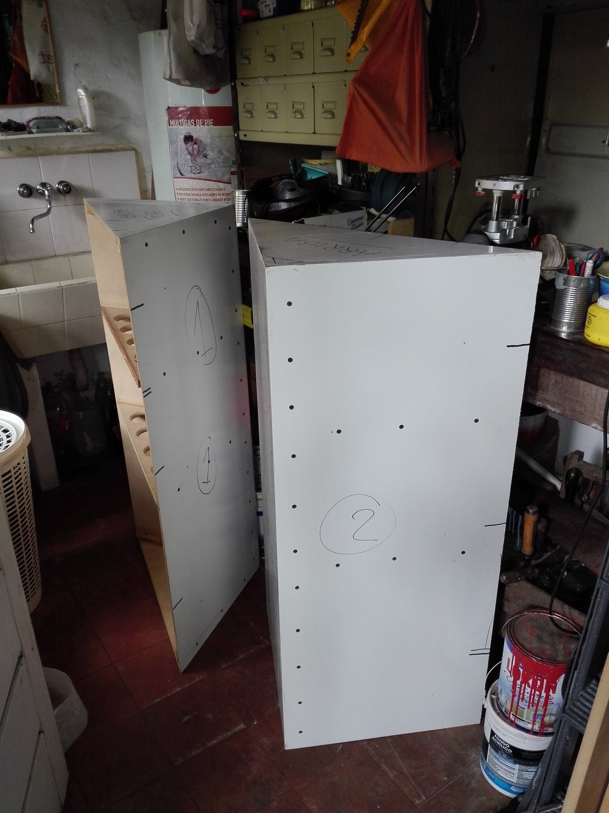

The work is delayed, it has rained a lot to work abroad.
Waf has rebelled :eek: and forced to remove my tackle so they have gone to the sink waiting for the weather to improve....:eek::D

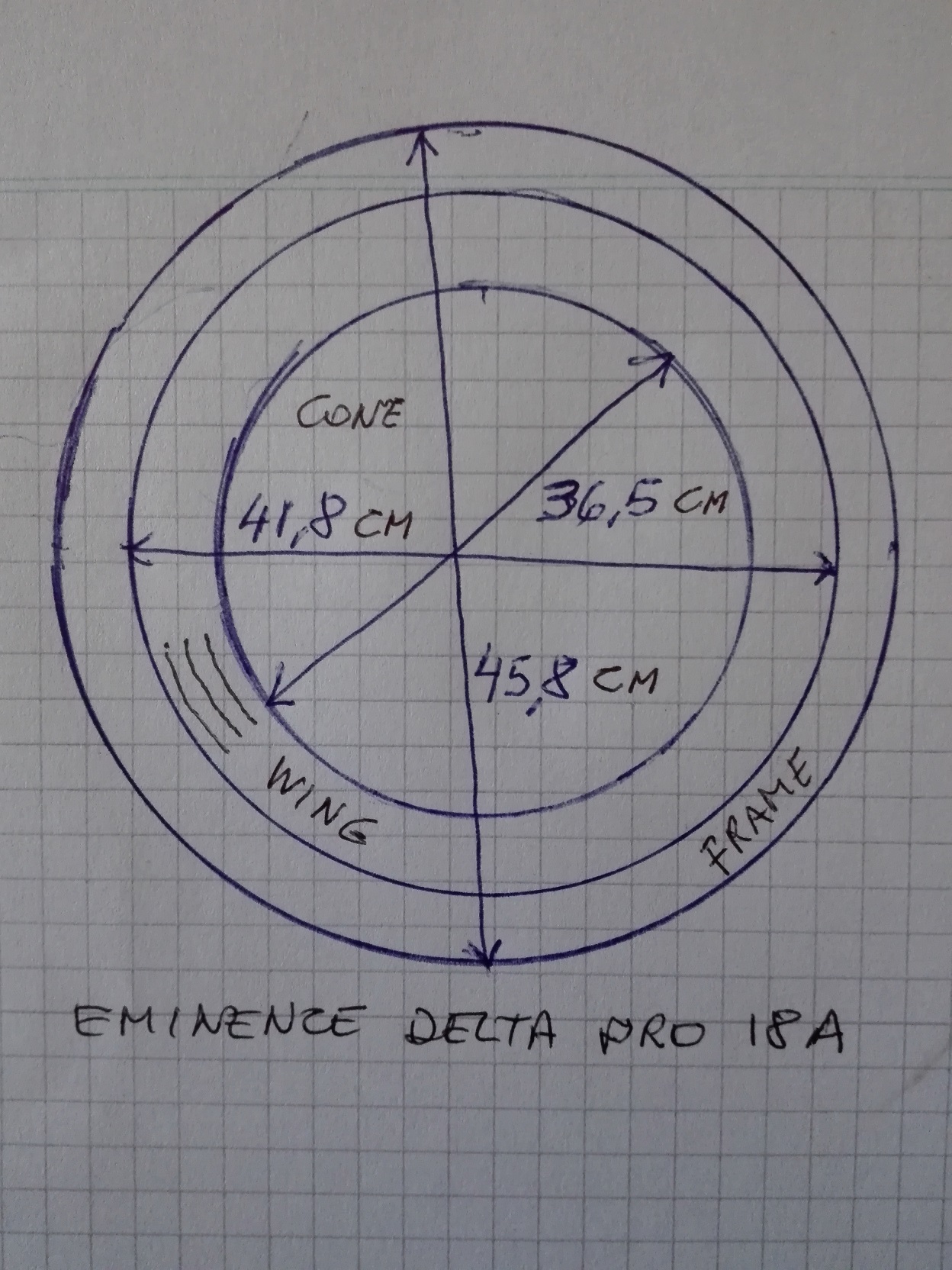

So I have made some measurements in situ of the speaker. These are the actual dimensions, for obvious reasons, I prefer to use 18 inches, equivalent to a speaker overall diameter of 45.8 cm.

(I insist that it is created to put that value, and the result will be approximate)

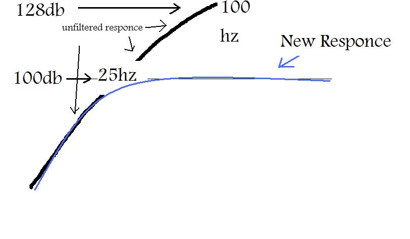

two 18 inch drivers at 6.7mm at 25 hz is reasonable enough. the thing is getting the driver to play 6.7mm at 25hz and with how much power.
The main thing is to bring down the far louder output in the higher bass (steep responce curve) to = Shallow of flat responce curve.
so if, for say your 100db at 25hz and 110 at 40hz and 125 at 80
you need to find a way to make it... 100db at 25hz 100db at 40hz 100db at 80
of corse it does not haaave to be wholey flaat, a gentle rising responce would be fine.
and there is also room gain to consider,
so for say... if the responce curve is like half a mounting. you need to chop of the top of the mounting so its even at all frequancys. then you will still get a decent enough output across the range with 2 18 inch drivers with 6.7 mm xmax and it sound good too.
what you need to figure, is how much power is needed to get to 6.7mm at (for say) 25hz in 150liters, and is it within the drivers power handleing capability. should be ok at a guess. but the resonance curve Is steep and I do recommend some active equalization to solve that and make it a good subwoofer set.
Quick example picture portraying what I mean,
not saying 100db is the max could be 110 or such. This is just to illustrate

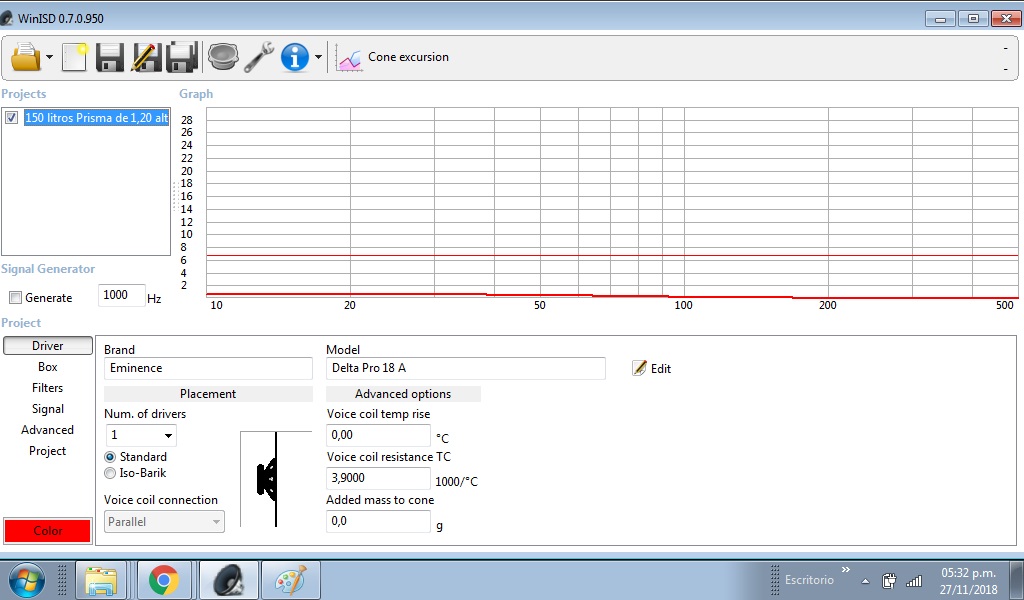

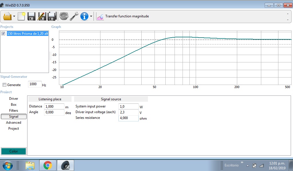

Well, I have enough to study your observations, thanks for that.
In my post 25 onwards there are the simulations that I have obtained with WinIsd, there are some that I do not understand, for example the Cone excursion is just a straight line at the 6.7 mm point, something must be wrong there ..

Thanks again, when I hear the final result, I'll see if I need a professional equalizer, instead of the simple cut-off frequency selector on the board amplifier ;):RE

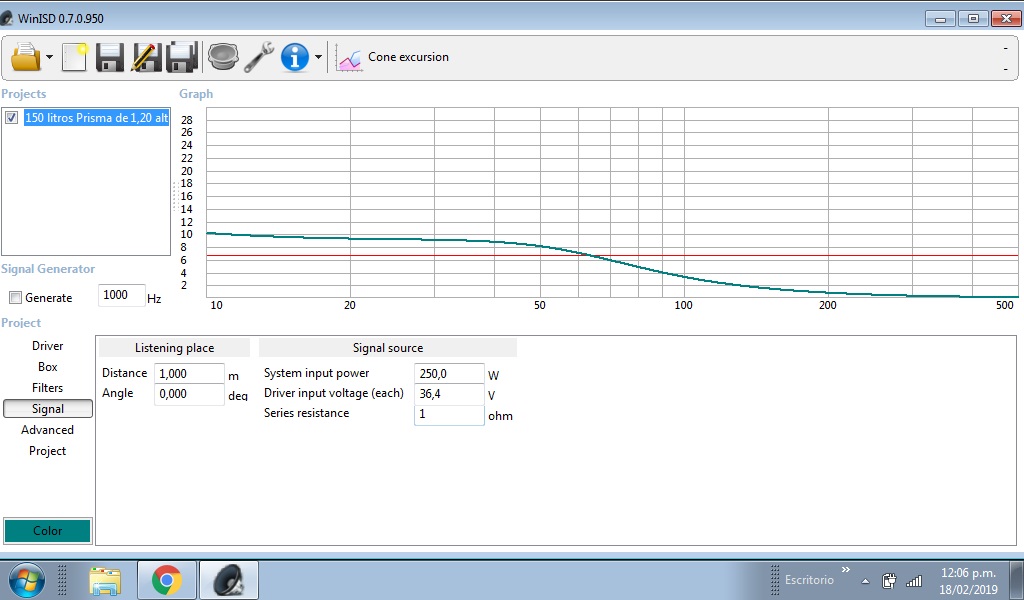

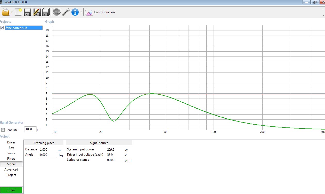

The red line shows xmax. There should be another line that shows actual excursion at power specified.
Sometimes if the driver specs are not inputted in the correct way (see winisd help file) then you will not get a plot for xmax.
A pic for example of how it should look :
edit: your graph does show xmax along the bottom. Increase the signal power to bring it up you are probably viewing at 1w.

Just to expand a little on Rob Wells' comments, the upper red line on your picture is a reference marker added by WinISD to let you easily see/remember what Xmax is for each driver modelled.
The lower red line is the actual excursion of your project.
You need to increase the applied voltage (Signal tab>"Driver input voltage (each)") until the 2 lines cross at whatever you think the lowest frequency your program material contains, then check the SPL graph.

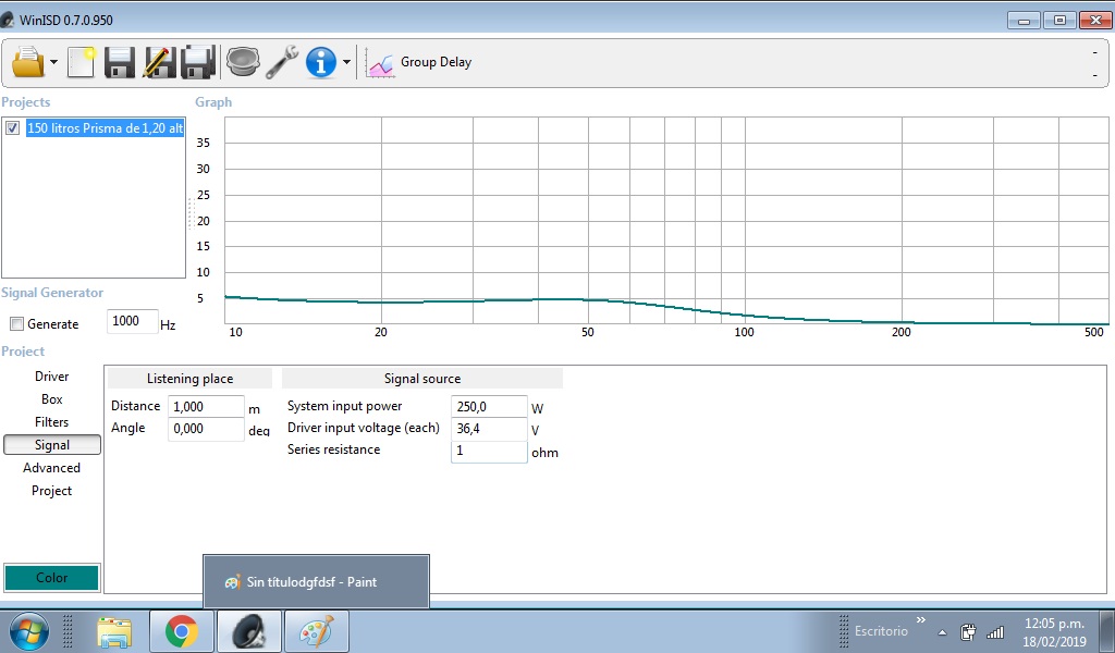

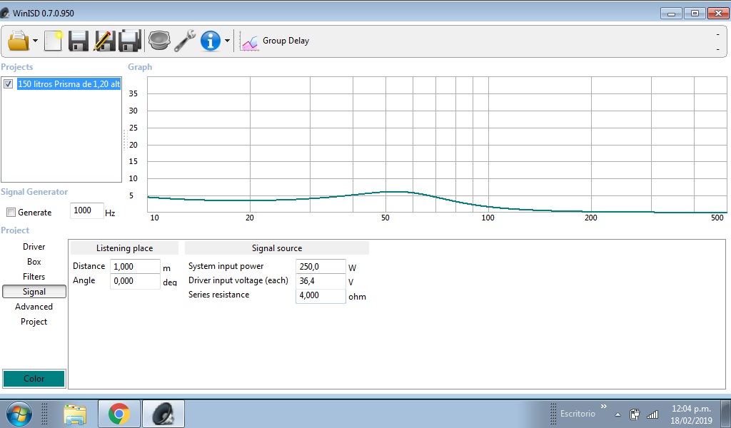

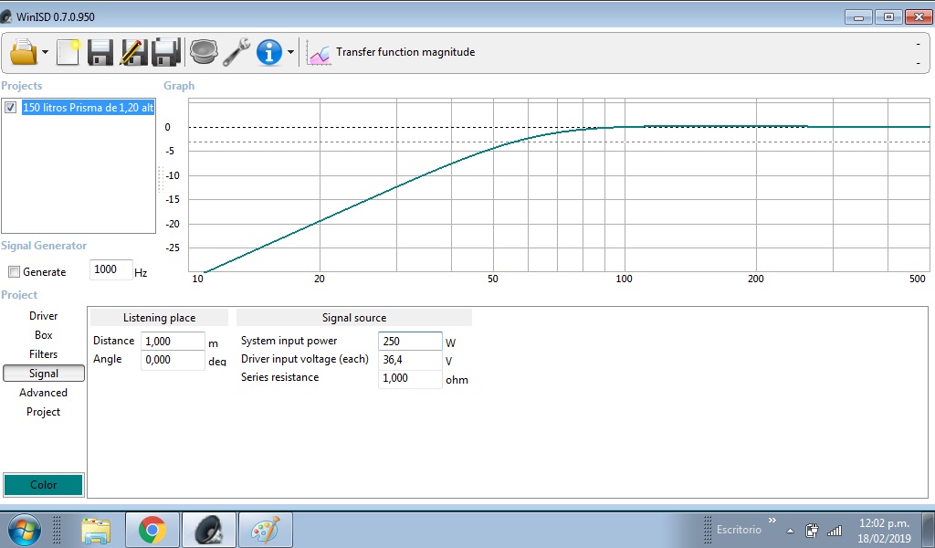

You're right, it was by default at 1 watt, so I changed it to 250 watts and you can see the result here.
"Cone excursion" is now approaching Xlim speaker (15 mm) ....

Well, my comfortable listening level (and something else too) in my room will never reach Xlim ...
I have observed that a box says "resistance series", by default it is 1 ohm. I will use 2 x 8 in parallel, should I put 4 ohms?
Thanks for clarifying the point ! :)
That box is for any extra series resistance between the output of the amplifier and the speaker's terminals - in a multiway box for example, a passive crossover can add extra series resistance.
For a sub, that shouldn't be the case, so one or two tenths of an ohm to account for the speaker cables themselves is all you should need to have here.

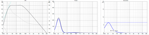

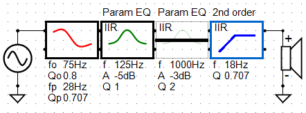

Quickly done in VituixCAD with active blocks & SPL set for Xmax. 80L sealed box in half-space, so you should have significant boundary/room gain with corner cabinets.
The straight line in the SPL chart shows Xmax-limited output versus frequency. And you can see the Linkwitz Transform's enormous power increase in the bottom octave. Adjust LF extension to suit.
