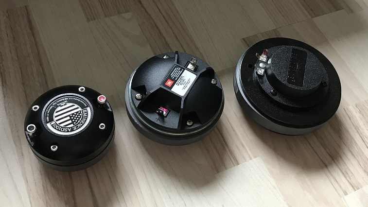

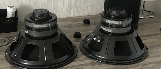

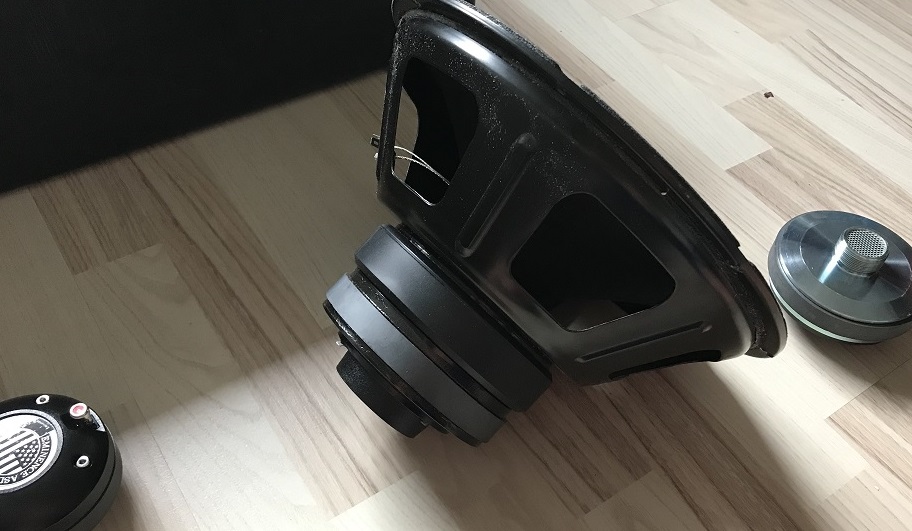

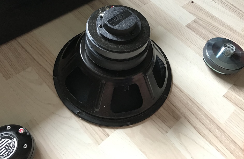

So today the PSD2002 arrived. My god its even bigger and heavier than the Selenium, not sure my 18mm pine baffle can take it. Or if the B12CX steel frame can? Seems total overkill lol. Before I start assembly and testing I think I need to strengthen the baffle with another 18mm. Will keep up all updated on this fun but expensive experiment.
Is there even horns available for this kinda of gravital force?

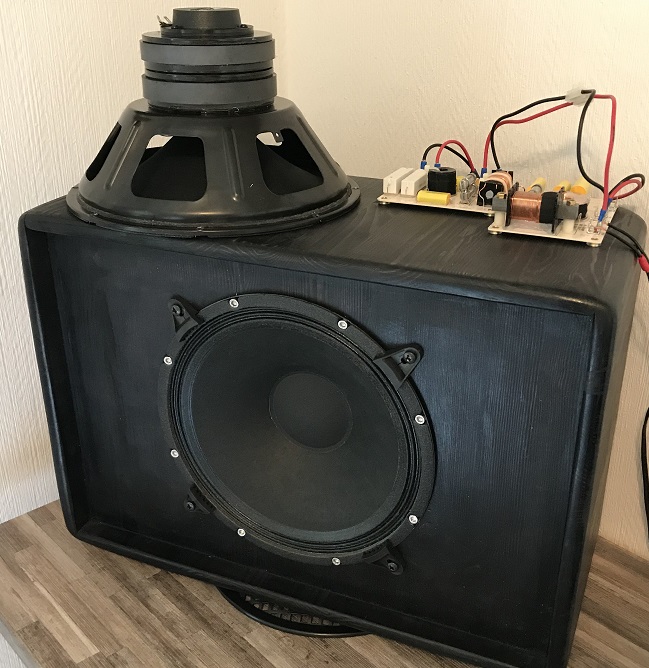

So i have been playing around with these new CDs and crossovers for a week now and Im very confused. All the CDs suddently have a resonance at 2,6kHz. It does not matter if they play directly without a crossover unmounted on the desk, or mounted in the coax drivers, with or without the 1k6 filter. I know that the B12CX have a small peak in this area but I dont really hear that from the bass driver alone, filter or not. Is it something wrong with my ears, or something very wrong with all the CDs all of a sudden? I need to buy some measuring equipment before going further into this. Still, things sound "best" to me with the PSD2002 and the existing 2k5cx filter for now but I realize I need to start building my own crossovers from scratch to get the results I want however not without measurement equipment. I will use the Selenium in 10cx in my next project.
Some random pics attached. I find it nice that the PSD2002 and Beta12CX magnets are the same. A match made in heaven?

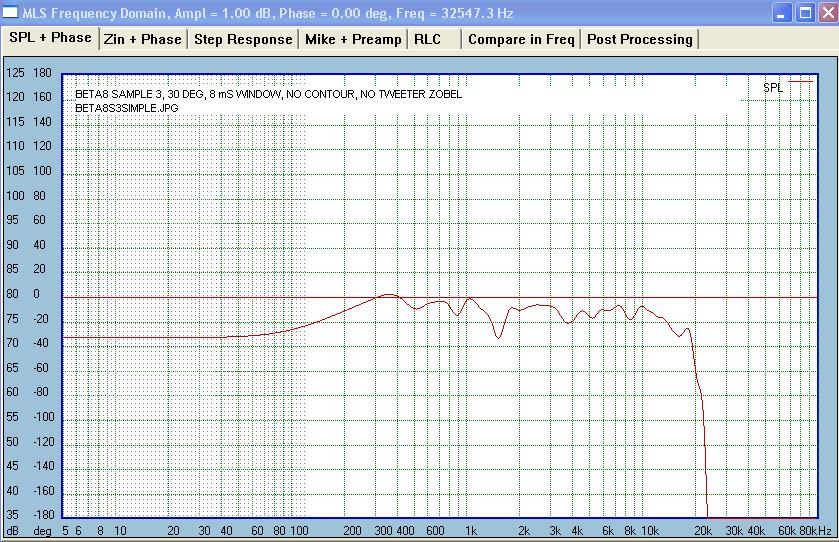

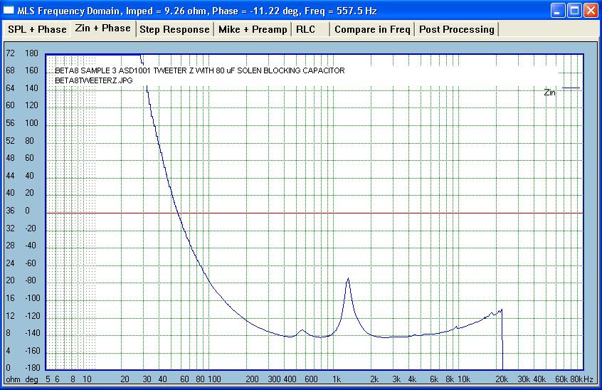

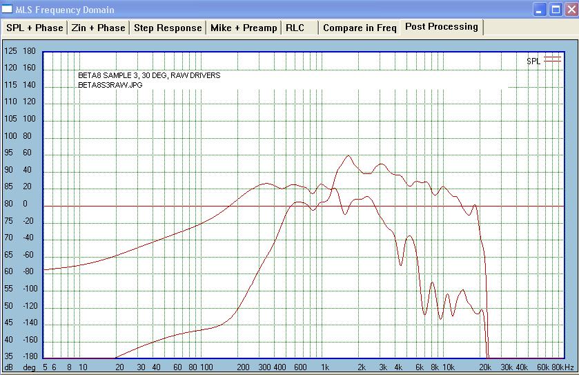

ASD1K Raw
Cannot comment on your findings related to other CDs. The ASD1K1 has very non flat response. BUT easily treated by first order xover up high.
ASD has also healthy impedance rise at resonance that needs to be considered (eliminated with conjugate) when using passive xover.
Note that the impedance rise below 300 Hz is due to blocking cap used for measurement to protect driver, not driver.
Simple is electrical first order applied to beta8 and asd with conjugate on asd.
When asd is treated as described, it sounds very very good in my opinion.

Interesting. It’s clear to me now that the eminence preassembled crossovers are made with driver protection in focus first, smooth sound second, as it seems obvious that PA systems always have digital parametric equalizer possibilities in preamp to flatten the peaks from both the speaker and the location. I definitely need to get some measuring tools and start with more complex crossovers to get what I want here, I am sure I have plenty of flexibility in these drivers to achieve what I want.

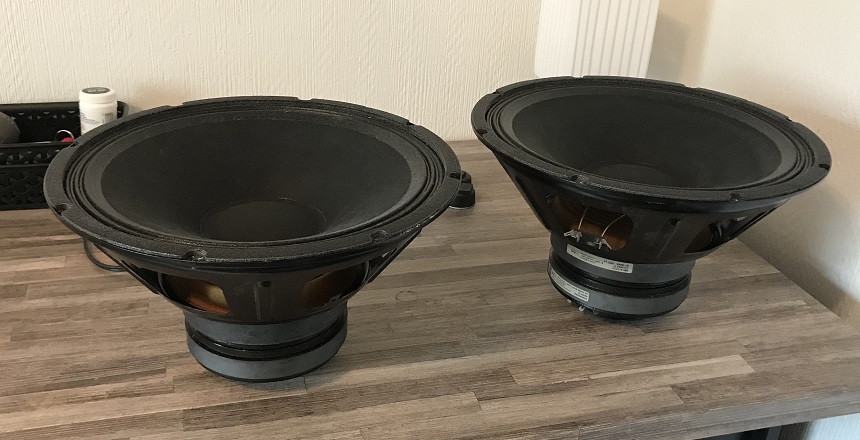

I got inspired by the finnish diy project and bought a pair of 12cx and apt50, now i must build some very large boxes. I clamped a driver in my impedance test setup and runned some dirty frequency response measurements, and the result: this is actually not so bad 🙂
