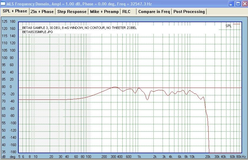

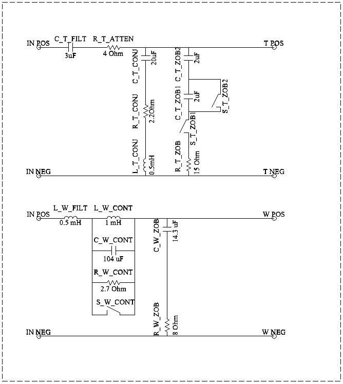

I use the Beta 8CX with ASD1001.

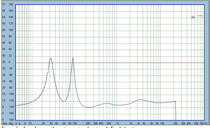

The ASD has a very healthy impedance peak that can sound pretty bad with a passive xover (not a problem with active xo). Conjugate completely solves the problem with passive xo.
I get about a 20dB null at xover with polarity reversed, high and very flat input impedance, 96 dB sensitivity, and pretty flat response. And I cannot break them. I use a subwoofer crossed at 40 Hz.
Very pleased.
