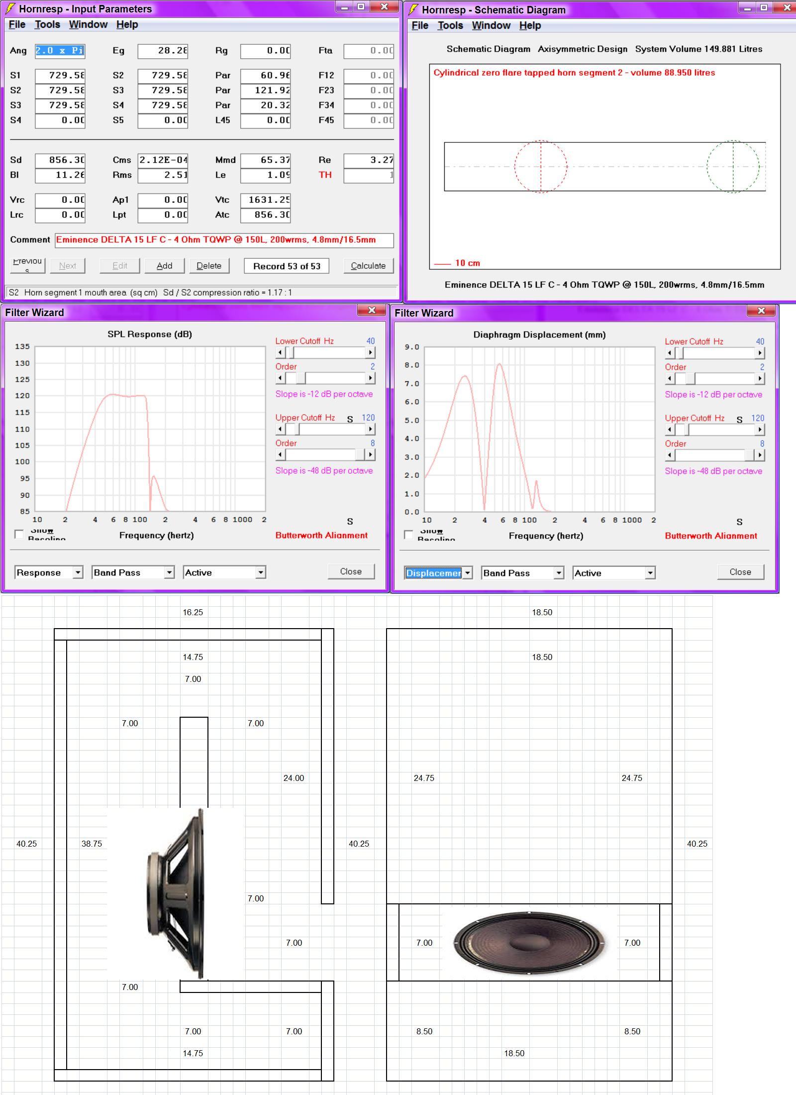

Here's a 250 liter TQWP (Tapped Quarter Wave Pipe). 7 boards & 3 braces.
Thanks for the responses guys!
BP1Fanatic - those boxes look fantastic but may be slightly too big to lug around for outdoor gigs (i've got 2 drivers so will most likely have 2 boxs or 2 in one if possible), although considering the SPL on the TQWP @ 40hz im extremely tempted! May i ask, are those measurements in inch's? Also the program that your using is it possible to get to try myself? It looks extremely interesting!

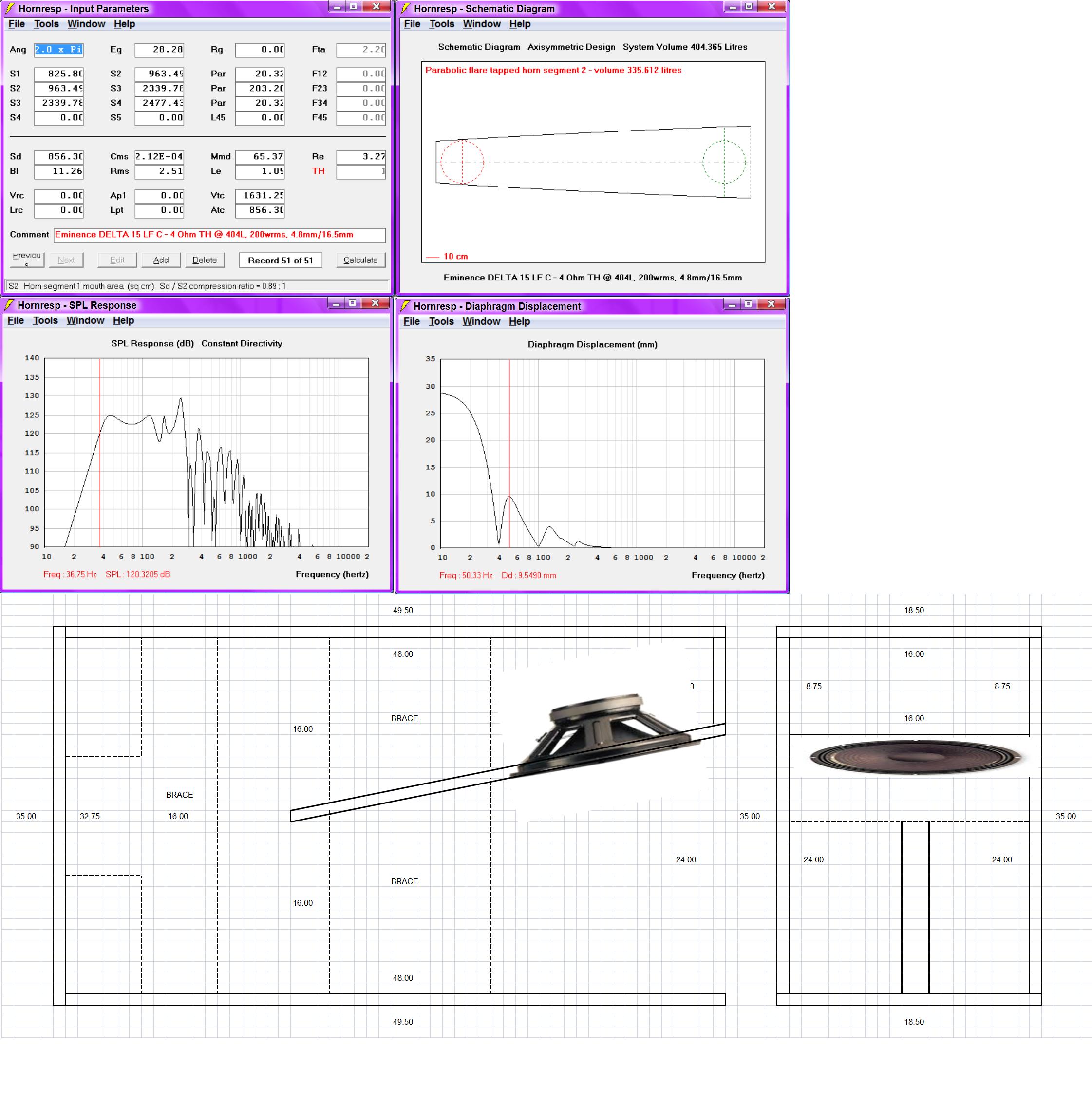

'Tapped horn for dummies' and Hornresp (Martin J. King) Quarter Wavelength Loudspeaker Design
http://www.diyaudio.com/forums/subwoofers/148656-enclosure-tb-wt-644f-z-5500-10-a.html
I don't have the experience with TH's or TL's.
A good paper here from Tom Danley.
Tapped Horn Experiments
You can compare and have fun online with this easy simulator for Tapered Quarter-Wave here.

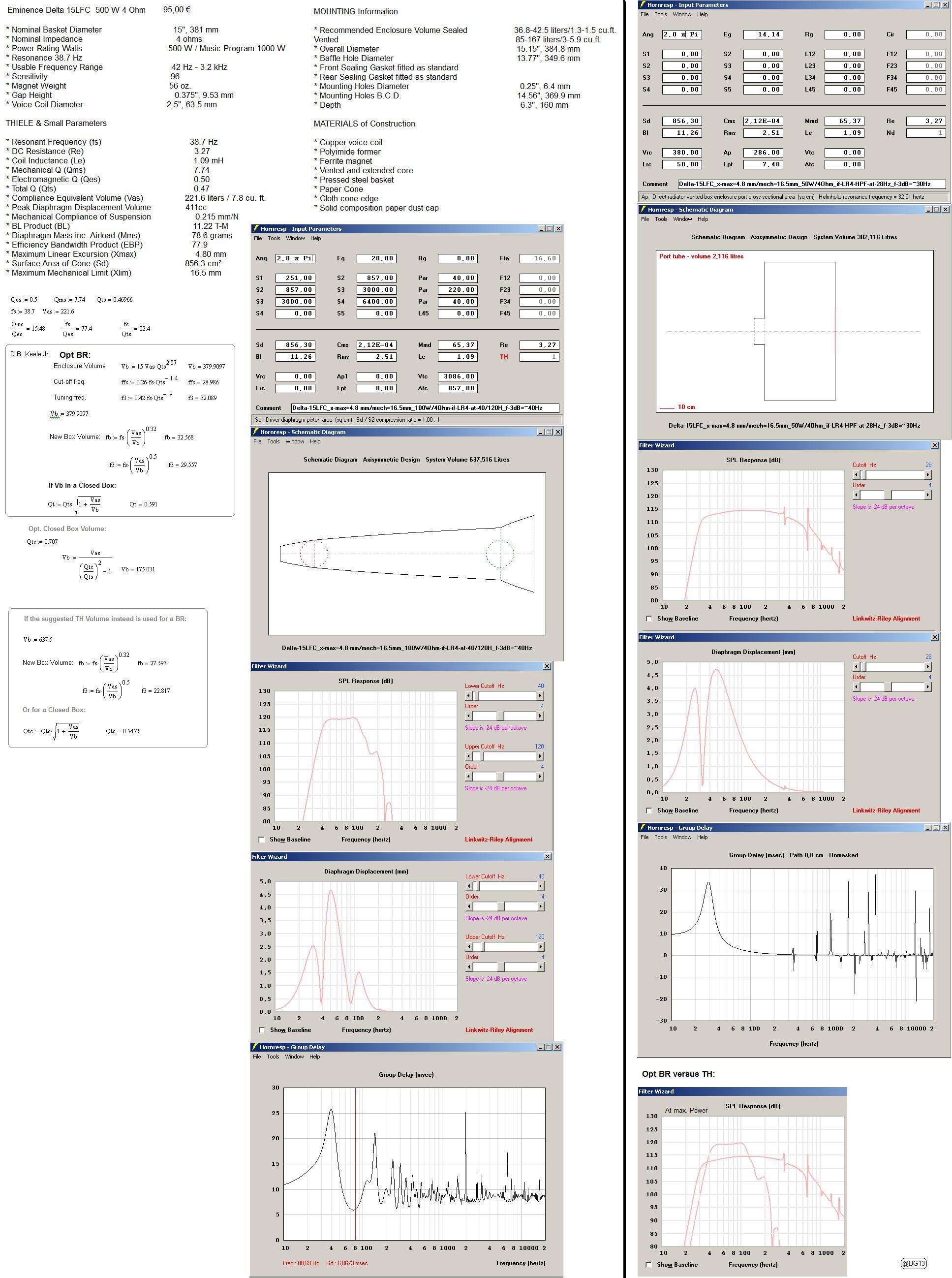

The conventional WinISD for bassreflex here (or online here) and for a PA (BR not horns) that I mentioned in my previous post I would go with Pialign Analysis Software from PiSpeakers. Have fun. 🙂
Another driver that models very similar in the low frequency to that one is (cast-alu) Eminence Basslite C2515 Neo.

Thanks guy! If you want big SPL then you need a big box. Yes, the measurements are in inches.

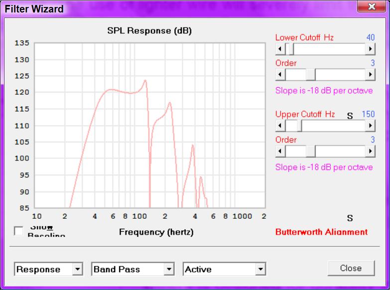

BP1Fanatic - Im starting to understand now that it ain't as simple as wacking a box together and wiring the thing up. I can't thank you enough for making these sketch ups though, the last one you've made seems absolutely spot on! Would it be possible to xover this box at 150hz instead of 120? I don't have a xover yet so im making do with my old pv 2000 (its got a fixed xover at 150hz). Regards Mik

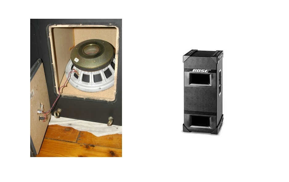

Sorry for the beautiful picture I posted, it's not mine, was just an illustration for the bandpass. In the contrary of what you might think, or was your first impression, the process of a bandpass is not what you think it's just a dual enclosure as you can find in the pic below. Mysterious, yes but not difficult... 🙄

Inductor - Ahhh i see, so its like two reflex (ported) boxes "stuck" together (to put it in simple terms, sorry as i mentioned earlier im quite new to all of this), haha mysterious indeed 🙂
